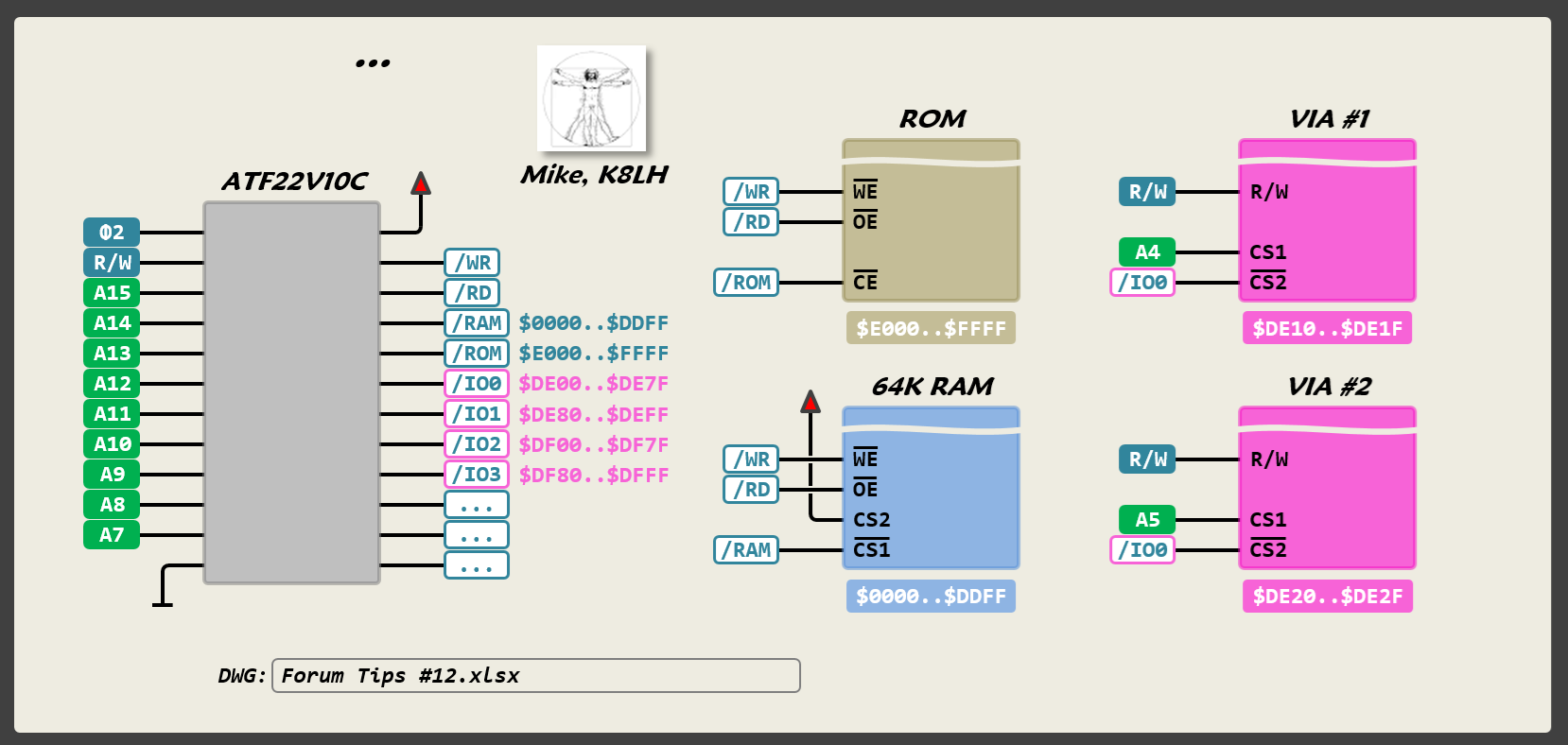

At the risk of making myself look dumb (again!), could I have an input for VIA0_IRQB and an input for VIA1_IRQB and AND them together in the GAL to an output pin? However, that'd take up 3 pins and drop me to 4 I/O devices. With 2 x VIAs already, that's not leaving much room for expansion. A UART and I'm down to 1 I/O left! Maybe a discrete 74HCT08 is a better idea?
Oh, and in response to the question posed...
The 22V10 has enough logic “fabric” to do this.  What it lacks is a lot of I/O—a limitation (among others) that CPLDs and FPGAs were developed to solve.  A clue to how to get around the paucity of I/O in this application is to be found in #1 above.  :D
Could one just have a pin for the whole I/O space and then forward that to something like a '138 3-8 decoder?
Posts: 9425
Re: Let's start at the very beginning...
I’d use an AND gate to aggregate your IRQs and not waste GAL resources on something in which absolute timing requirements aren’t critical.  However, I’d use a 74HCT11, which is a triple input AND.  After hooking up your two VIAs’ IRQ outputs to it, you’d have a spare IRQ input to use with a UART, if desired.  Be sure to pull the spare input up to VCC to support wired-OR operation—a 3.3K resistor is suitable for that purpose.
Oh, and in response to the question posed...Could one just have a pin for the whole I/O space and then forward that to something like a '138 3-8 decoder?
You could, if you don’t mind the cascaded prop delay of the GAL driving another piece of logic.  However, a better way to free up GAL outputs would be to move the read/write logic into a 74xx00, e.g.:

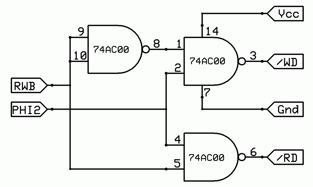

Qualified Read/Write
Although the circuit illustrates a 74AC00 (extremely fast, with aggressive edges), other CMOS logic types could be used.  These days, I’d use a 74AHC00. which has the performance of 74AC, but the less-aggressive edges of 74HC.  Putting your read/write logic into a discrete part frees up two outputs on your GAL.
Speaking of GAL outputs, be aware that they are TTL level, not CMOS.  Maximum guaranteed VOH is 2.4, which is well below the VCC × .7 level considered a valid CMOS logic 1.  Some measurements I’ve taken of GALs running in my GAL tester indicate that the unloaded output can be at or near 4 volts.  However, you can’t be sure this will be the norm in all cases.

Hey Dave. You might take advantage of the VIA active high chip select input to support both VIA's on a single I/O select strobe...
Happy Holidays. Mike
