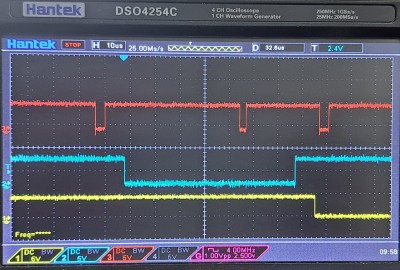

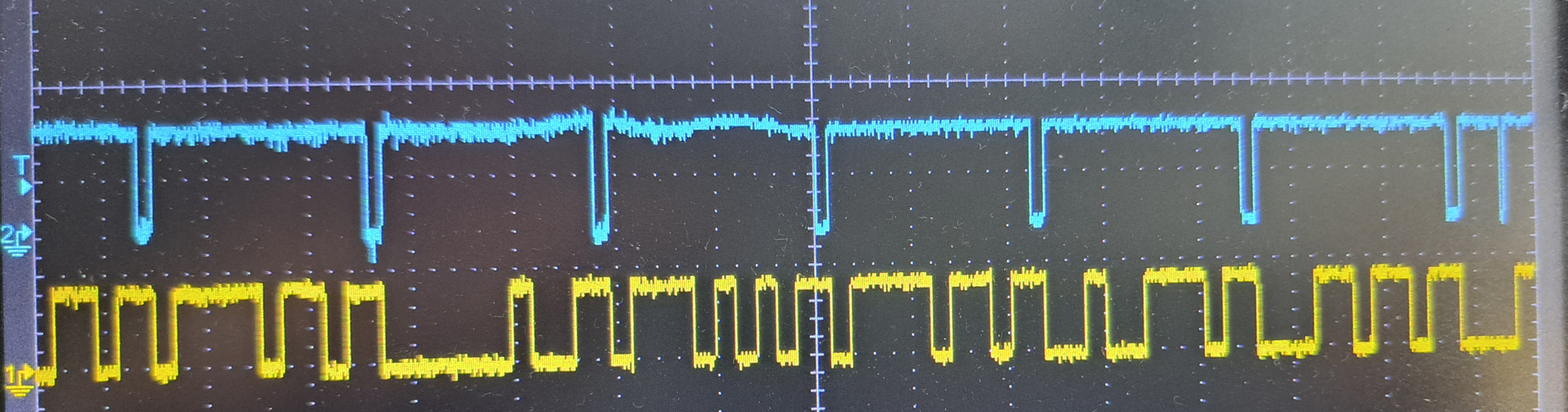

Progress:
I have been busy with work today, but took a look at the interrupt latency in a very high level way - here are oscilloscope shots of serial output, showing the duration of the IRQB pulses and the effect on the output stream:
It's leading to an almost-doubling of the stop bit duration (at 9600 baud), and the IRQ response time to the point where the next character is sent appears to be about 64us. This is with a 4MHz clock, so that's 256 cycles. When I get more time I'll look into where exactly all those cycles are going.

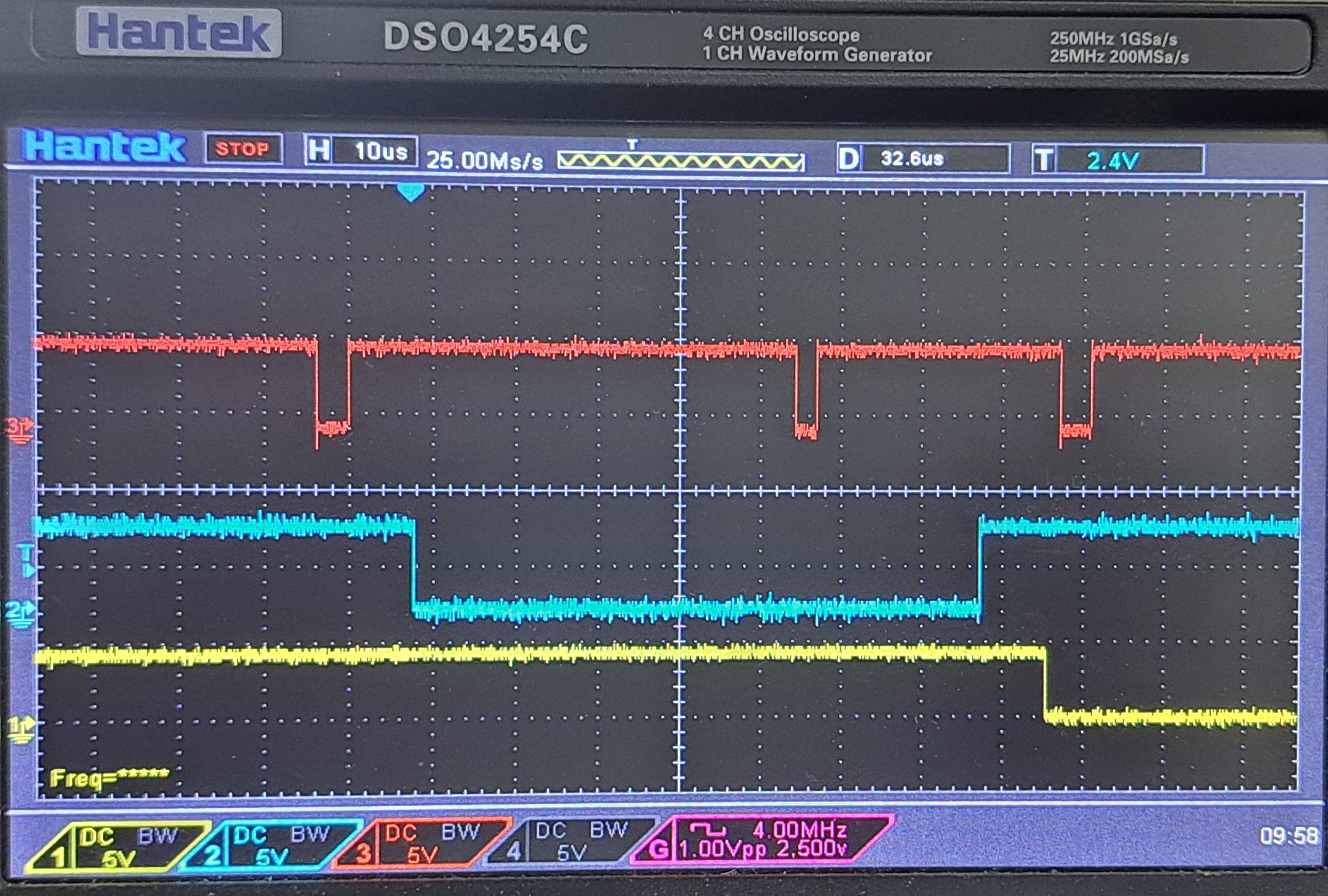

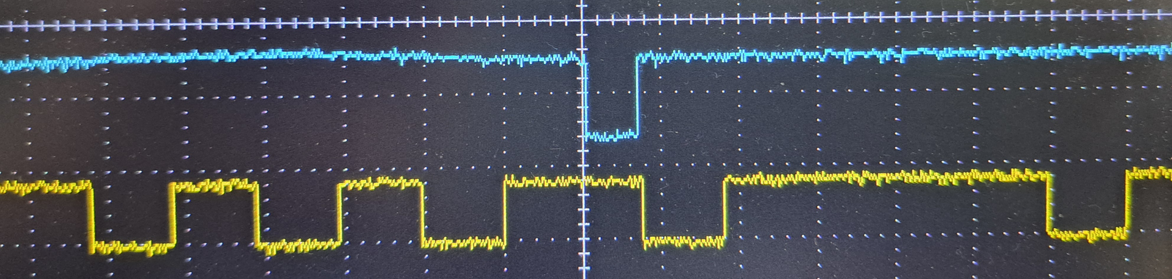

As an afterthought, here's another shot now showing - on top - the "supervisor" state:
It dropped into user mode briefly then back to super mode just before the interrupt - this is likely a system call - and then you can see it spent about 55us in the system call, leading to most of the delay in processing the IRQ. I need to look at getting interrupts enabled during system calls, then measure this again.
