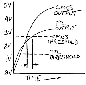

Re: Strange memory write problems
Posted: Fri Nov 04, 2022 4:28 am
by GARTHWILSON
BillO, the internal resistance won't stay constant. Even WDC's W65C22S will do 19mA pulling up to 4.2V, which with my 5.08V power supply, means 46Ω; but if you short it to ground and try to pull it up, you'll only get 50mA, which means 100Ω. IOW, it's not linear. I did an experiment on a 74LS04 in July, and with a 4.97V power supply (as close as I could get it to 5V with the single-turn pot on the power supply), I got this:

I was glad to see it did so much better than specified; but still, output got awfully weak before reaching 3.5V, and clearly it does not behave like a resistor. What's in his SRAM is anybody's guess, until someone does a similar experiment; but the fact that it cannot pull up hard insinuates that it's something similar, unlike a CMOS output which can pull light loads all the way to the positive supply rail.
One device with TTL-type outputs may be specified to be faster than another device with CMOS outputs, and yet for driving CMOS inputs and the capacitance on the line, the supposedly slower CMOS output may get the CMOS input to recognize a valid '1' sooner than the TTL one does, something like this:
