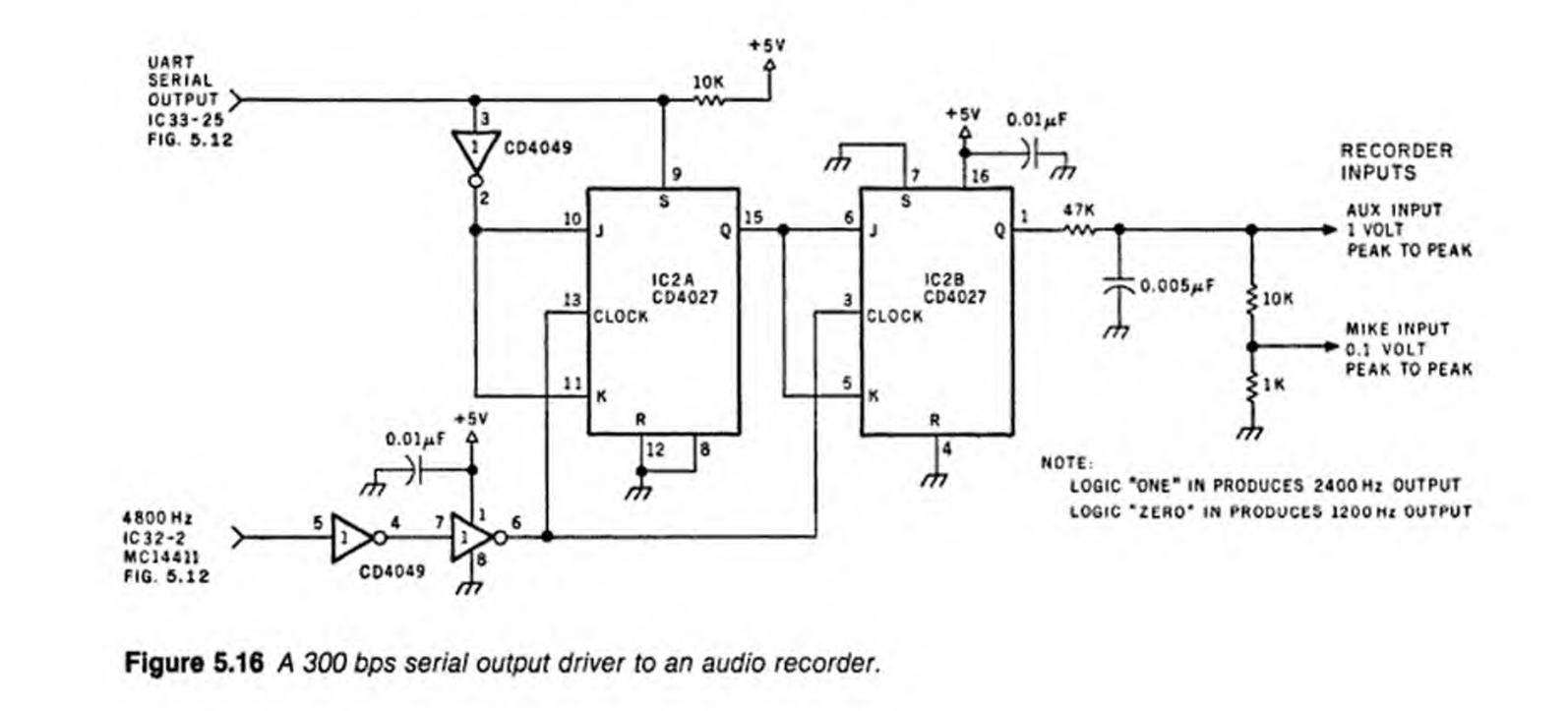

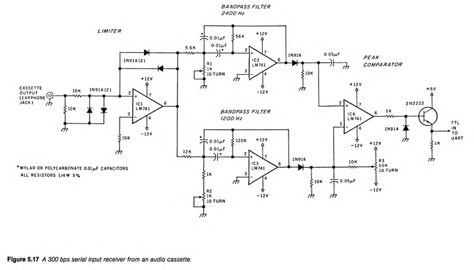

Here's a KCS implementation from Steve Ciarcia's book, BuildYour Own Z80 Computer.
Kansas City Standard (KCS) receiver
A KCS transmitter
A KCS transmitter
The author warns that it takes a lot of tweaking to get a higher rate than 300bps from this circuit.
