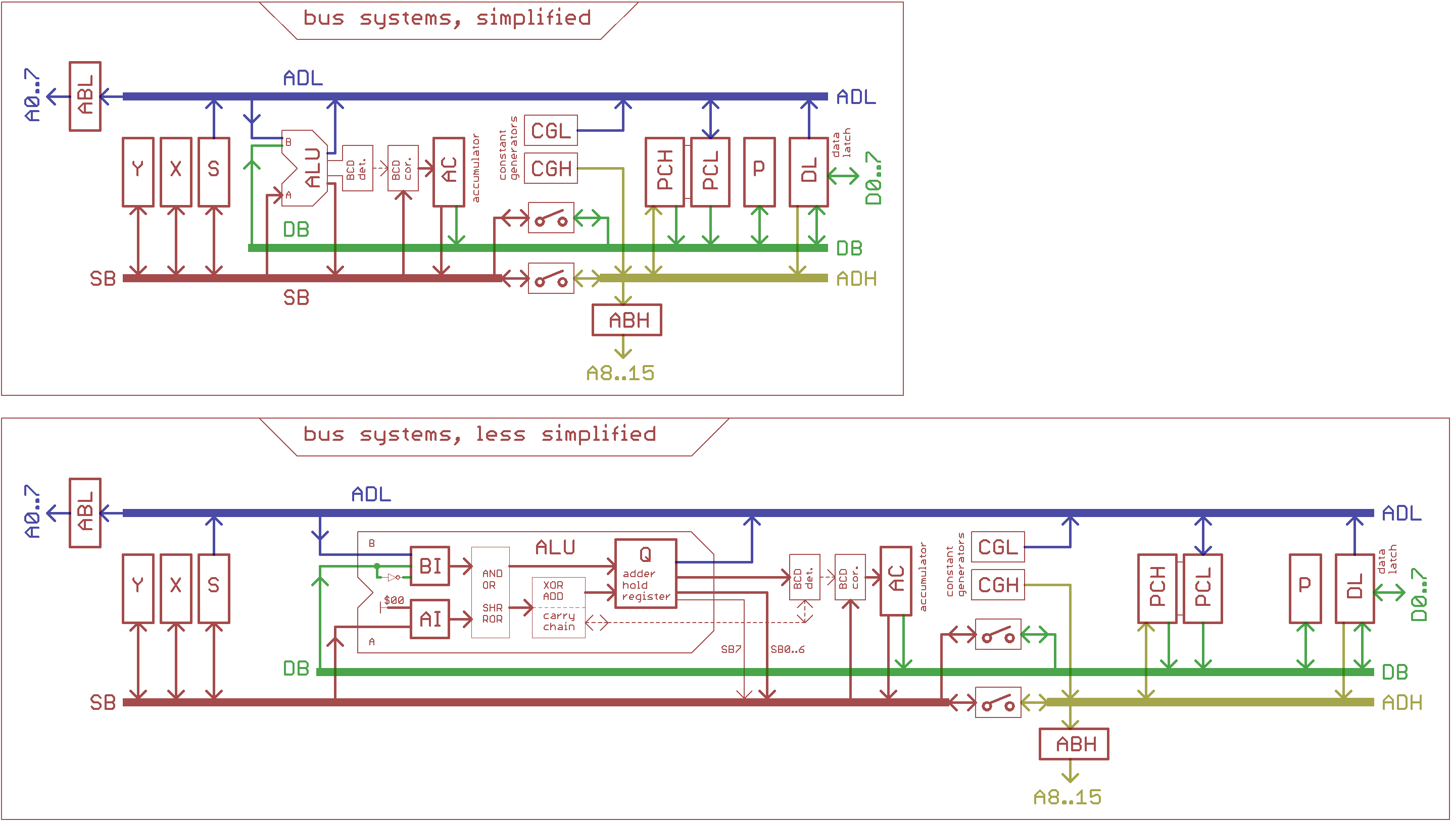

I did a little work on the Data Path diagram at the bottom.
- Missing S and ADL connection (S/ADL)
- The fact of loading direct and inverse value to the BI ALU latch is not reflected (DB/ADD, NDB/ADD)
- Zero load command is not displayed on the AI latch (0/ADD)
- ADL/ADD connects ADL and BI (not AI)
- Current value refresh commands are not displayed (S/S, PCL/PCL, PCH/PCH)
- Instead of "BCD-detect" made ADD (Adder Hold) and output to ADL and SB buses from it
- A -> AC (not to be confused with A Input)
Re: 6509 dissection: IDKFA
Posted: Fri Jan 14, 2022 10:14 am
by org
In addition to the previous post.
- CGH and CGL are mixed up
- Adding a cleaner version of the diagram
Posted: Fri Jan 14, 2022 12:03 pm
by ttlworks
I admit that I was in a hurry when drawing the block diagram with the bus systems,
it was the last step of the dissection.
It isn't exactly a data path diagram, because it shows the data path plus the address path. :)
Block diagram intentionally was kept as simply as possible to give an overview.
Don't worry, I'm adding a more detailed version.
My mistake, fixed.
I consider the AI and BI latches (plus the related circuitry) to be integral part of the ALU.
My mistake, fixed.
I consider the refresh paths to be integral part of the registers.
I consider the 'adder hold register' to be integral part of the ALU.
In Hanson's block diagram, the accumulator is labeled 'AC', so I'm changing 'A' to 'AC'.
Dang. How could this happen ? :)
My mistake, fixed.

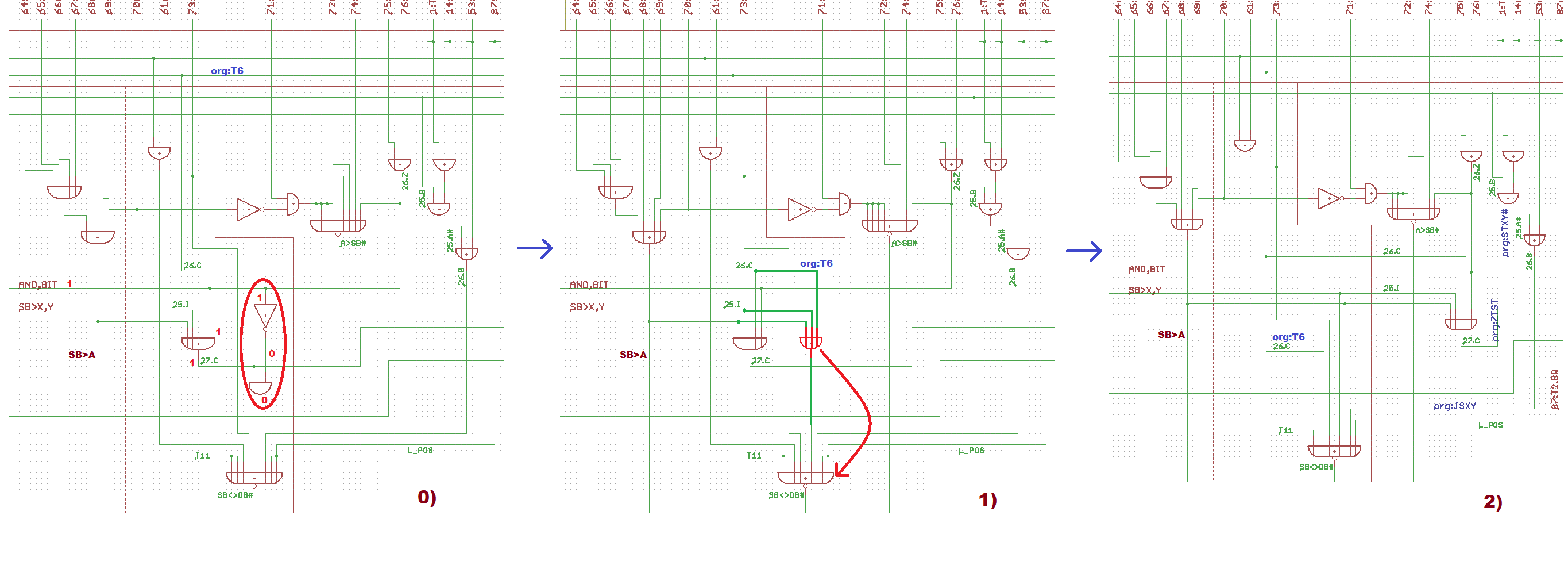

Small case SB_S:
For some reason, the 6-nor is split into two gates (in the demorganized version 4or + 2or).
I am attaching the transistor circuit and a piece of dissection to get the #SB/S.
Posted: Mon Jan 31, 2022 8:16 am
by org
Case SBXY:
On the transistor circuit, the SBXY intermediate signal (SB>X,Y) comes in only one place - ZTST.
Posted: Mon Jan 31, 2022 11:07 am
by ttlworks
org wrote:
Small case SB_S:
Reason was, that there were no 6or or 8or logic gates in the libraries of the CAD software I'm using.
org wrote:
Case SBXY:
Ah, that... maybe I had skipped a step during optimisation:
0)
org:ZTST = SB>A | AND,BIT | SB>X,Y | org:T6
the output of an AND gate goes into the "SB<>DB# NOR": NOT(AND,BIT) & org:ZTST
1)
so we could consider that input of the "SB<>DB# NOR" fed by the AND
to be the equivalent of the output of a three input OR gate:
SB>A | SB>X,Y | org:T6
2)
So I had pushed that three input OR gate into the "SB<>DB# NOR gate". :)
