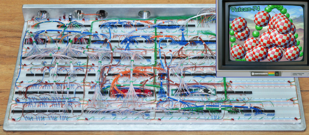

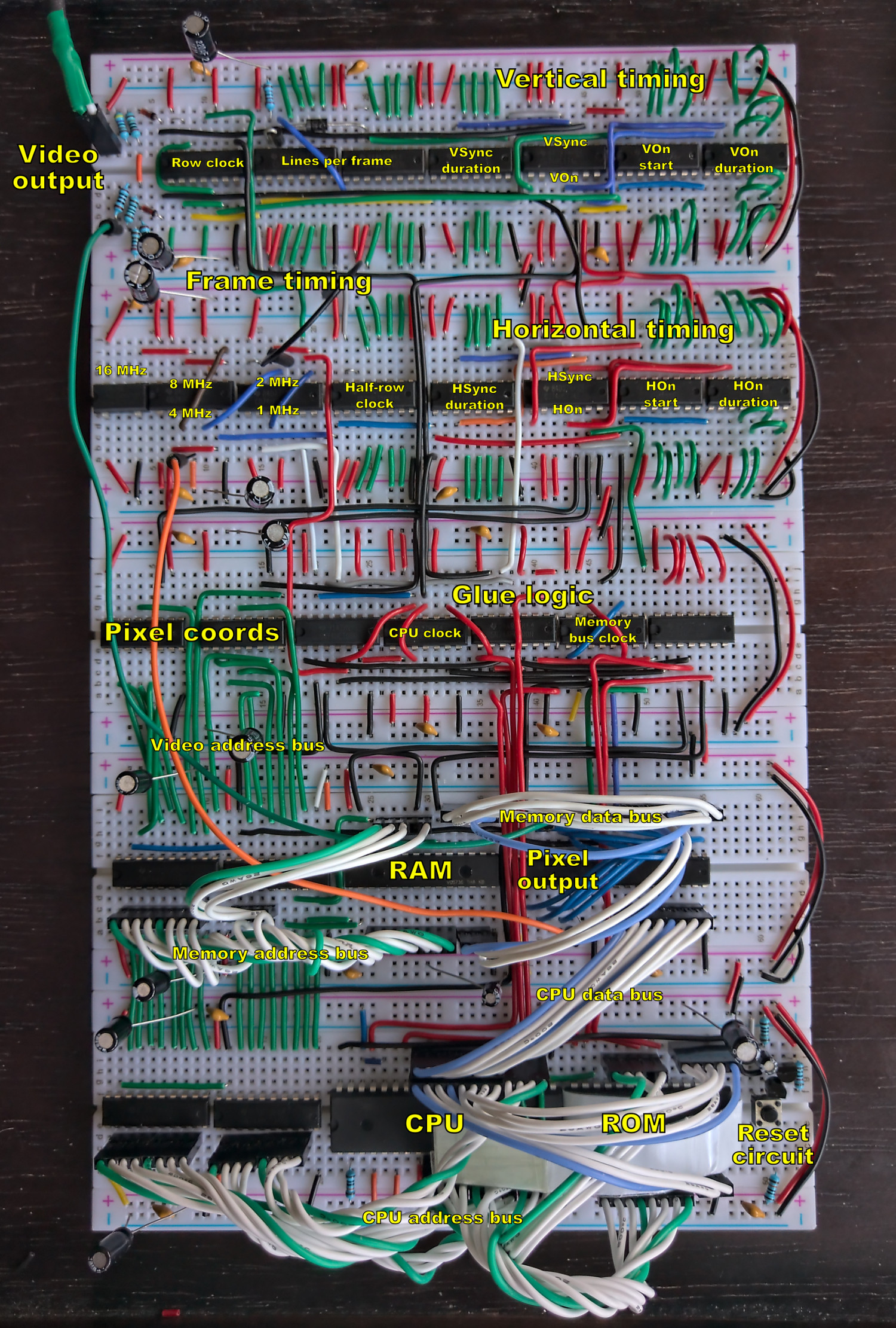

I've successfully built quite large projects (e.g. https://github.com/gfoot/compvideo6502) on very cheap breadboards without too much trouble. But I've bought another batch from the same seller and marketplace and found them to be much worse quality, although they look identical. So I think it can be hit and miss.
Re: VGA and Dual Port RAM
If DIP chips are popping off the board, perhaps the pins need some gentle realignment. As-shipped, the pins are often somewhat splayed, and by careful pressing against a steady flat surface you can bring them to the correct row-to-row distance. (0.3 inch for smaller DIPs)
It's also possible, if the chips are rather old, that the pins are tarnished, and can usefully be cleaned with a fibreglass pen or pink abrasive pencil eraser. If the pins or wires make poor contact, that'll be a source of unreliability and frustration.

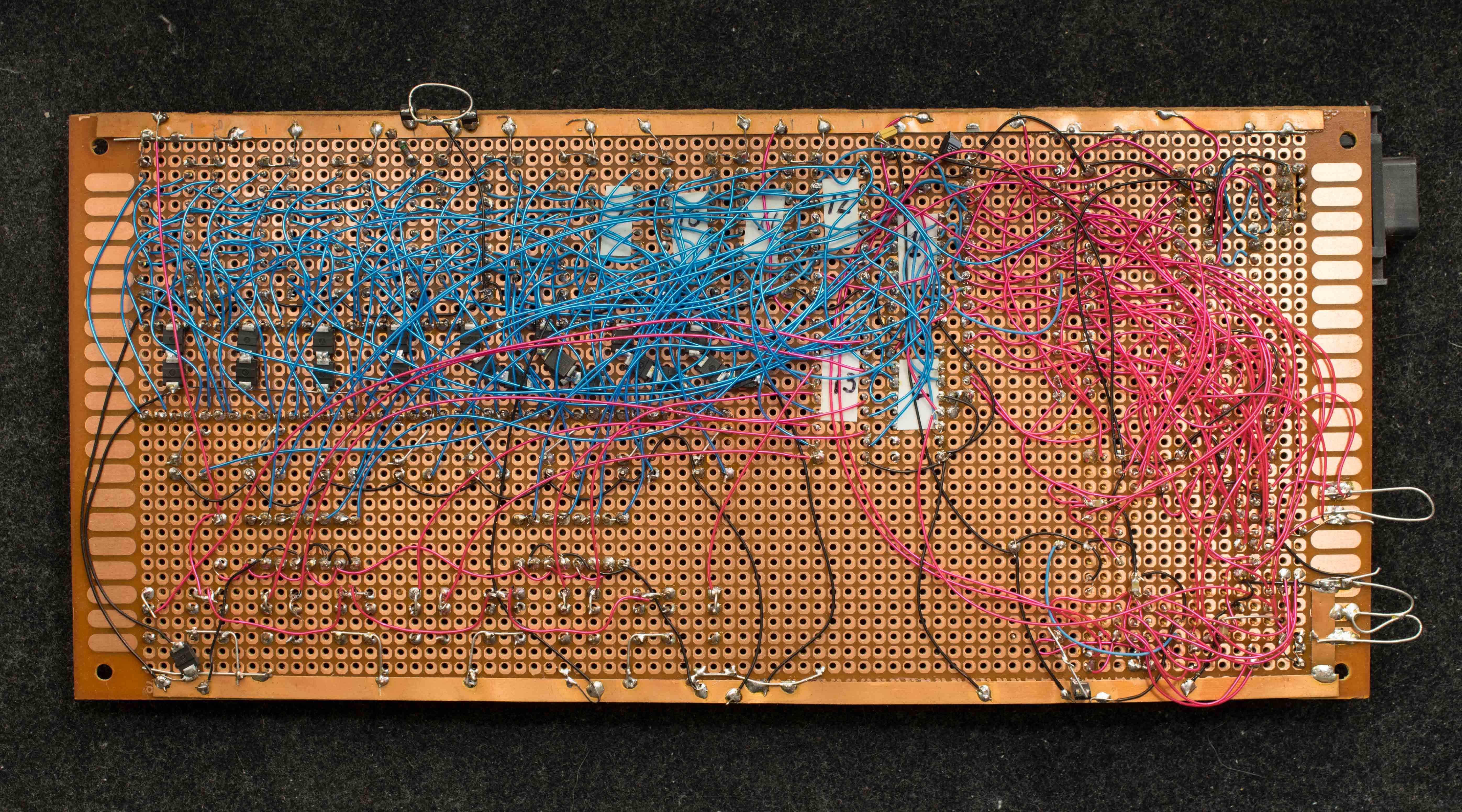

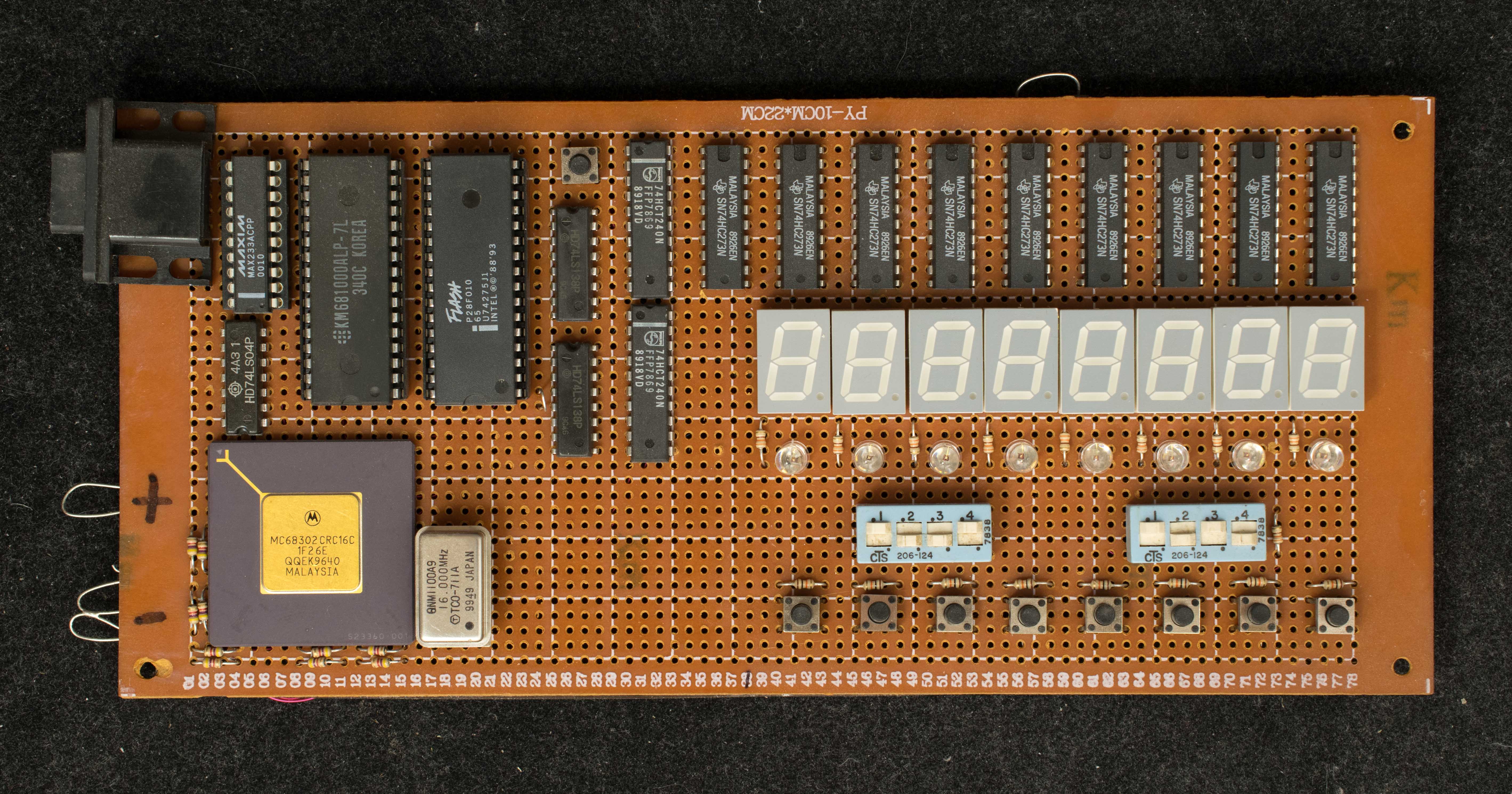

Before I realized pc board technology had became affordable, I was prototyping fair size board using point-to-point wirewrap wires. This was the prototype board of Tiny302 which was about the time I discovered the cheap PCB technology, circa 2017. That was my last significant prototype effort. I still prototype with point-to-point 30-ga wire, but at a much smaller scale. I seldom use solderless breadboard for prototyping--it has reliability problem as you've discovered.

Well I know all about that point-to-point stuff. I like your board, looks good, the smaller wires make it look clean. I was talking with my wife about this today, and she said I need to weigh the time and money aspect. Basically a printed board is probably the best solution at this point.

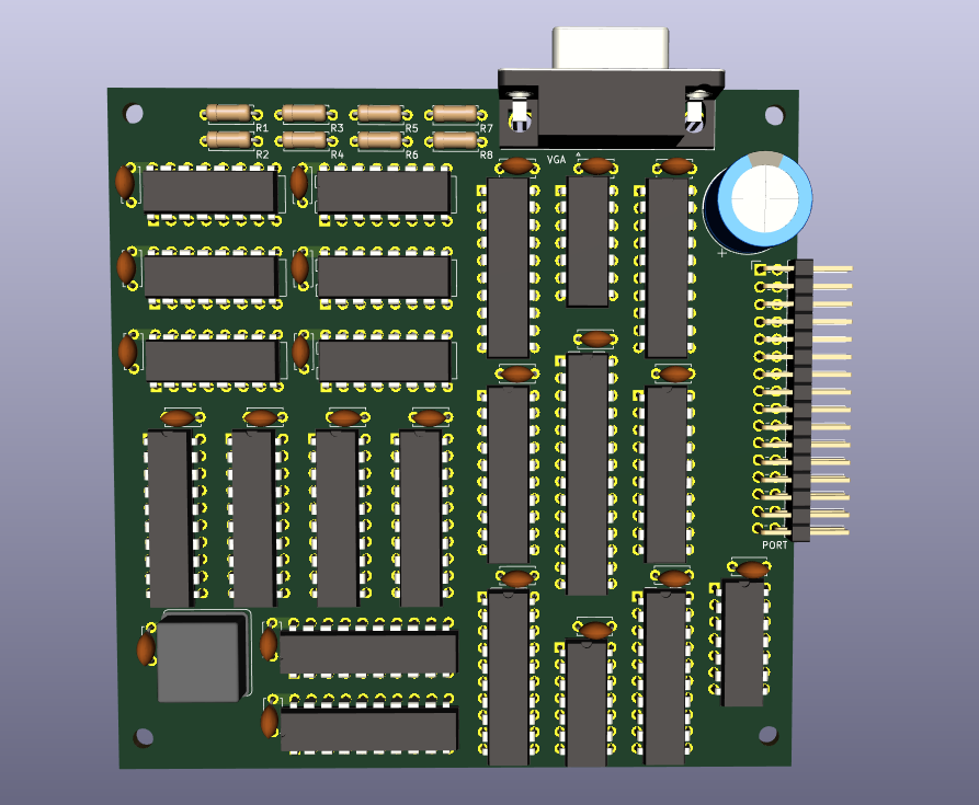

Attached is a brand new schematic I worked up today. It uses a lot of the counter and logic ideas from what I was trying to do on the breadboard. But then I added the RAM and a way to access it. The main idea is that this will "shadow" my ROM on the 6502 side of things. If I read, it's from ROM, if I write it's to this video RAM.
Some things I have altered or kept because of my experience today:
1) I'm using the '161 and not the '163. Going with Ben Eater here, the async reset make sure that I actually reset on the value I'm trying to hit. No need to search for 799 when 800 is the goal.
2) I'm using the '688 instead of whatever NOT-NAND gates that it might replace. The '688 is still fast and it's all included, no need to have a ton of logic chips going this way and that. And no nesting required.
3) I'm going to keep the SR Latches, they are easy to use and when soldered I doubt they will jump off my board.
4) Because the counters are counting real pixels, there is no need for me to have a separate set of counters for the RAM. This alone has removed 8 chips that my previous idea had.
5) 6x '245 bus transceivers will let me read from the RAM and write to the RAM at proper times. My previous idea was to use latches and a VIA, sharing the data bus, but this 'shadow ROM' idea will make it much easier to access, and very fast.
6) Instead of trying to squeeze my RAM to fit every pixel on the screen, this will just be a colorful block in the top-left corner. This eliminates a lot of glue logic and complexity. It won't look perfect, but it will display all the same. Later editions of this board could shift or stretch the size if I desire.
7) I might add some additional enable lines, but I'm trying to keep this side super basic.
If you have any thoughts let me know. I'm willing to hear it. There won't be any more 'testing' of this board, I'm going to solder whether it's a printed board or just perfboard.
Thank you everyone, I appreciate your feedback so far, it has been very helpful. It has likewise been a morale boost when I needed it most.

The main concern I have with the design is the asynchronous outputs of the 6 comparators. Synchronous counters do produce cleaner outputs but using them to drive comparators and expecting the comparator outputs to be glitch-free can be a risky move. The signals I'm worrying about are /H800 to aynchronously reset horizontal 74HC161 counters, /H800 to clock vertical 74HC161 counters, /V525 to aynchronously clear vertical counters, /H656, /H752, /V490 and /V492 for HSYNC & VSYNC generation. Glitches on these comparator outputs can throw the counters out of sync. Maybe I'm worrying too much, but I would gather all comparator's enable inputs together and connect to ground through a low value resistor, so if there are unwanted glitches, the comparator's enable inputs can be qualified with the 25MHz clock.
You should tie unused inputs to VCC. Does the oscillator really has an enable input? It need to be enabled if so. RGB inputs have 75 ohms termination on the monitor side so if your HC245 driver is tri-stated, these inputs will pull down to ground.
I would watch /H800 carefully. It will be a short, spiky output; as soon as the count reached 800, it asserts and clear the horizontal counters which, in turn, cause /H800 to immediately de-assert and clock in the vertical counters. That spiky signal will drive 3 counters going down and then drive 3 more counters going up. It'll probably all work, but I'm just a worrywart. It makes me want to emulate it with a CPLD...

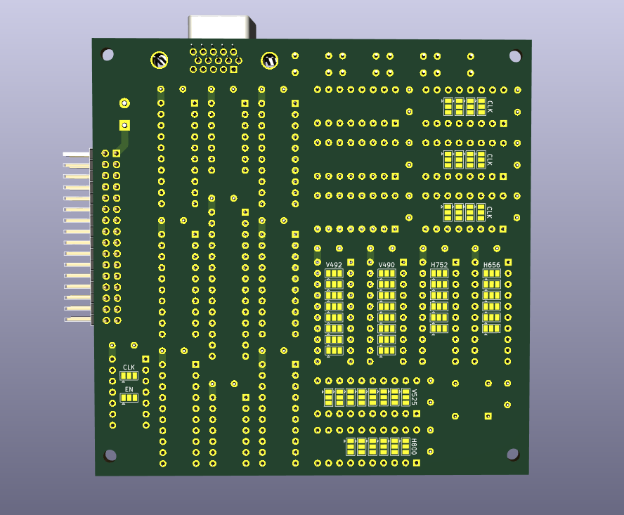

Bill, it's like you read my mind this morning. Dynamically! I woke up at 3:00am with an idea: Why can't I do BOTH sync and async styles on the same board?!
So spent 2 hours just now making these little solder jumpers for the back end of the board. I can then manually solder each '688 comparator high and low, I can change the clock speed to full or half, and I can also change the '688 enables to GND or to the clock.
I will have to adjust this a bit because if I want 799 I need to have some solder jumpers available that I don't currently have here, but the idea is there. Because I'll get 5x boards printed automatically, and the '161 and '163 have the exact same pin configuration, I can try one style, if it doesn't work I'll try another style, etc. Small adjustments can be made with solderwick.
I just ran the auto-router and it seems to be ok with this, I will have to test it again later because I stopped it before it would finish.
There's the update, thank you Bill!
