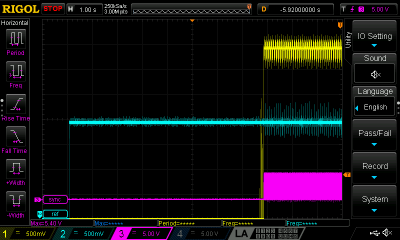

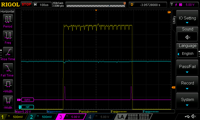

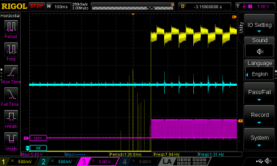

I'm attaching some photos from an oscope trace of turning the board on. Due to the layout, it's not very easy for me to probe the pins directly on the DS1813. So, acknowledging that the SYNC will lag a few cycles behind leaving reset. On the trace, blue is the 5v supply, pink is SYNC, and yellow is RESET. This is all from the same power on, I've just zoomed a bit to show interesting things on the main trace.
At a high level. You can see 5v applied, a bunch of noise around the reset coming up, and then finally it makes it and we start syncing.
RESET starts to rise a few times but never makes it.
Actually, it makes it once...
This is a DS1813+10 so the typical trip point is 4.35V. It looks like the power source gets up to 5V pretty quickly, and doesn't dip back down.

Well that's just a bit weird. Have you already pulled the reset LED out of the circuit to do this testing? That's the one thing there that's at all unusual. If so, I'd be tempted to lift the DS1813's reset pin and measure it independent of the rest of the circuit to see if there's something else in the circuit making it act weird.
Here's one idea about what might be going on. It's seems as if it would have to have some way to detect that something else on the line is bringing reset low so that it can detect the button press. And it would need to detect further presses and bounces during the 150 ms hold period after the button is released so that it could extend the hold, lest it later release and then a bunch of bounces toggle the reset line. (That's exactly the kind of thing this device is supposed to avoid, right?) So there might be something about that line, perhaps something drawing enough current in some subtle way, that the DS1813 thinks a button is being held down and so is holding things in reset until it's decided that the "button" is done bouncing.
Oh, and it might be useful even in the existing setup to zoom in on the power line 150 ms before /RESET is released to see if there's something going on there (such as very short drops in Vcc voltage) that you can't see at the wide zoom level.

I soldered in a "new" (off my breadboard computer) DS1813, with the intention of using the unclipped leads as easier test points for the scope. I bet you can guess what happened next...
It all works. The leads on the original DS1813 are long enough to be resoldered into another board. Perhaps I damaged it when originally constructing, but I'll give it another try at life. I'd feel pretty unlucky if I had a bad LED and a bad DS1813 on the reset circuit of this build, but crazier things have happened...
In any case, that means this revision has fully come to life. and the LED/Key boards arrived fully assembled from JLC yesterday, so once the 14 pin IDC cables arrive, it'll be time to give that board a test.
