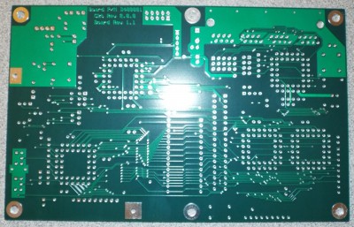

The PCBs arrived on Monday, and as I was preparing to get the SMT stuff soldered in place, I discovered a major boo-boo in the layout. :oops: The board is electrically correct but the footprint I used for the 'AC245 transceiver was wrong. It has the right number of lands but is the wrong package width
Welcome to the club. :) On my first build, back in 2017, I picked the narrow (7mm) DIP footprint for my 6850 instead of the 15mm one. Fortunately I was able to rig up an adapter with some perf board, a socket, and some headers. Didn't even bother fixing that problem until I upgraded the design earlier this month.

The PCBs arrived on Monday, and as I was preparing to get the SMT stuff soldered in place, I discovered a major boo-boo in the layout...Supposedly, I'll have the new PCBs and stencil on Thursday.
The new boards and stencil arrived. The bus transceiver footprint is now correct. Time to build the contraption and see if she goes or blows.

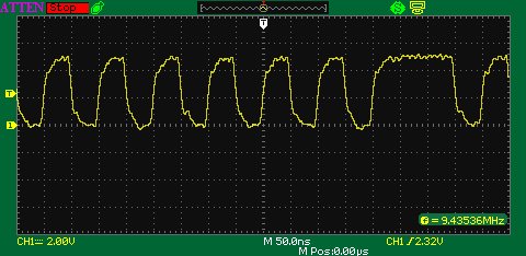

I had a chance to put the scope on the board I built based on the POC2 design.
Starting with the clock stretching, both 1 and 2 wait states appear to be inserted as expected. Seen here with 1 wait state selected.
longer shot of the wait states
The average frequency detected by the scope shows that particular section of code (probably keyboard scanning) has a 5 to 6% slowdown over all as the master clock is 20mhz for a nominal CPU speed of 10mhz. That's a small price to pay compared to running the board ad the speed of the slowest I/O component.
The first test runs were done with a slightly out of spec HC parts, both flip flops have been replaced with newly arrived AC parts and the clock from the flip flop shows a little ringing:
Scoping the clock side of the damping resistor
On the CPU side of the 120R resistor the ringing is gone, but the waveform is somewhat rounded:
CPU side of the damping resistor
Not that the CPU seems to mind, the rise and fall rate in the mid range is nice and fast.

Martin A wrote:
On the CPU side of the 120R resistor the ringing is gone, but the waveform is somewhat rounded...
Looks as though your clock circuit has higher-than-average parasitic capacitance, or your probe is loading down the circuit.
I wouldn't bet against either to be honest. The important thing is your design appears to be working as intended.

Here's a pic of the bad board and the good board. The bottom board is the good one.

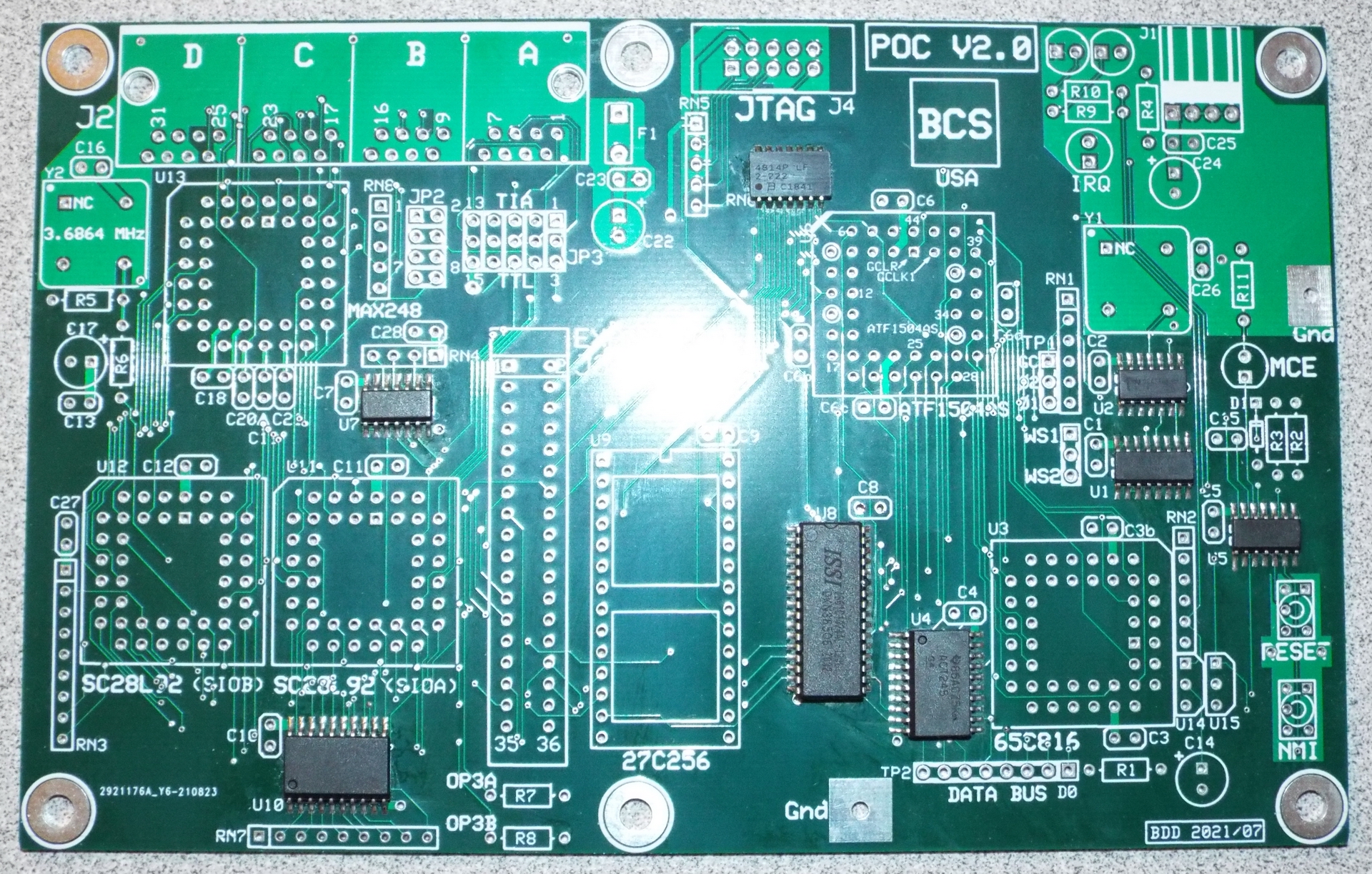

Here are a few more pics.
POC V2.0 PCB Top Layer
POC V2.0 PCB Bottom Layer
POC V2.0 PCB w/SMT Components
