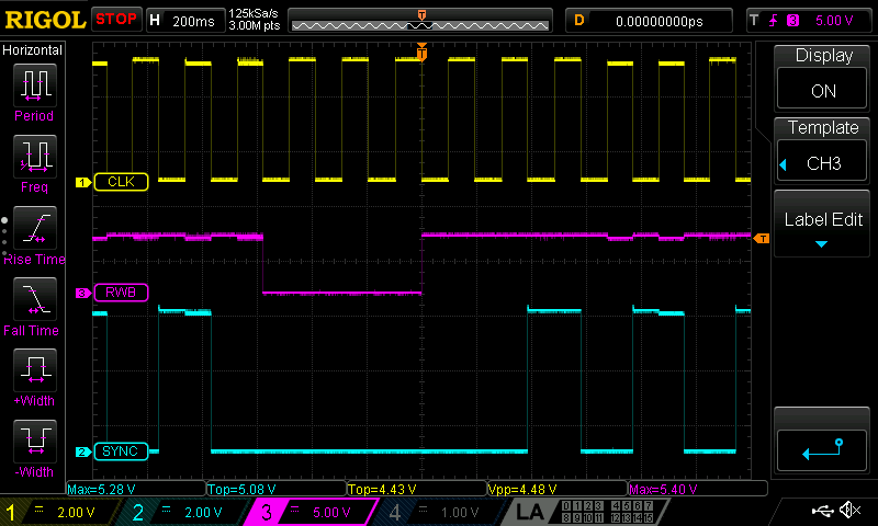

I really need to get a scope. There really is a wall you run into eventually where you need to see what them darn electrons are doing.

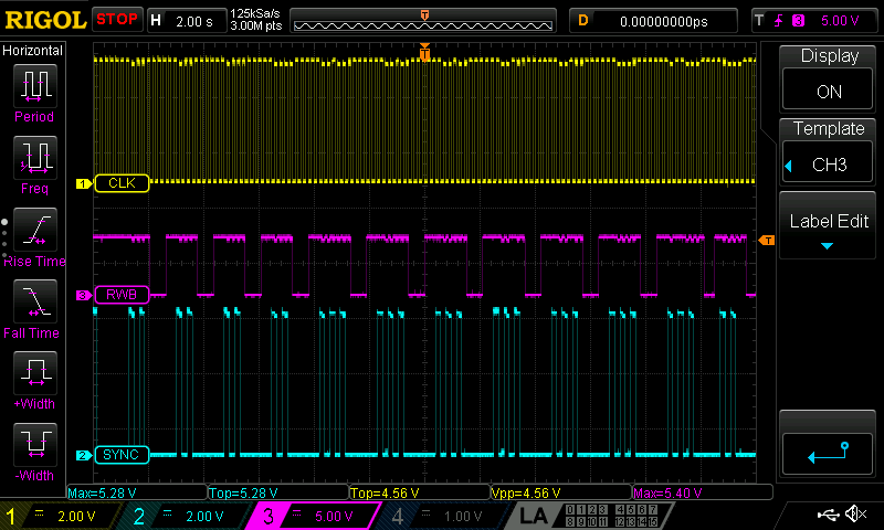

Indeed, in that last screenshot the scope channel was set to 10X erroneously.
So it's been a while since I was able to troubleshoot here, but I have some new findings that are making me tear my hair out. I have tried programming the ROM with "EA" in every bit. I'm still seeing very strange behavior. With the NOP-ROM in place, I'm still seeing LEDs driven by the 6522 illuminate. This was strange to me, so I set up my scope to capture CLK, SYNC, and RWB. It was my expectation that a ROM full of NOPs would never cause the RWB signal to go low. Is that a misunderstanding?
Re: The F-1 (aka "I Was Too Excited to Draft the UART Circui
Three write cycles in a row can only happen one way: an interrupt. So you need to check your interrupt lines (and possibly your reset line.) (And also check for BRK which is another kind of interrupt: might the 6502 see a 00 on the databus?)

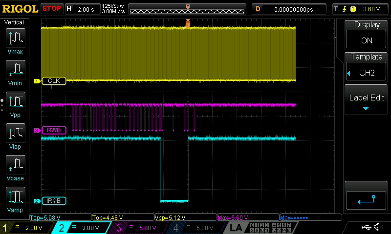

Yes -- what Ed said. Check the level on your IRQB pin. I think you'll find it's low, and that's what's causing the unexpected interrupts.
- Individual_Solid
- Posts: 72
- Joined: 25 Jun 2021
- Location: Portland, Oregon, USA

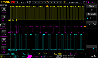

Hmm, something does seem to be pulling IRBQ low for a little while after a reset, but I am seeing plenty of RWB traffic before IRBQ ever goes low. NMIB has been reliably high in my experiments so far. I'm not sure what's pulling IRQB low, I'll do another visual inspection of the board, and I guess make sure nothing strange shows up on those signal lines with a DMM?
Probes are directly clipped to the 6502 pins. This trace is immediately after depressing the reset pushbutton.
