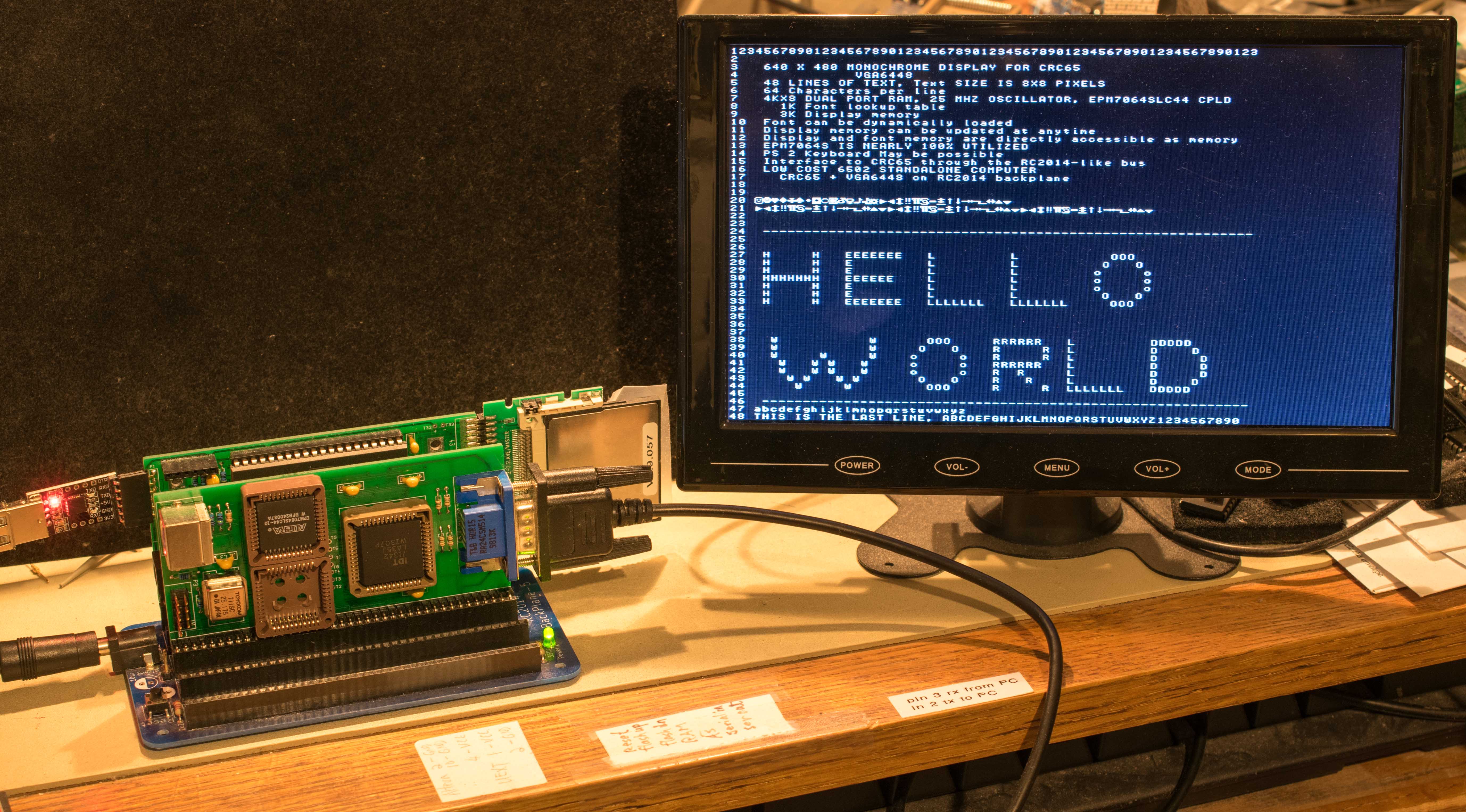

An alternative design is overclock W65C02 to 25.175MHz and use it as the video controller, viewtopic.php?f=4&t=6517. W65C02 is able to fetch a byte and load the video shift register in 8 clock cycles. At 25.175MHz it is able to keep up with streaming of video data during the active video period. During video retrace period it has spare capacity to do other tasks. I'm thinking it may have enough throughput to process ReGIS commands over the serial port (https://en.wikipedia.org/wiki/ReGIS). I'm also in the process of testing out W65C816 to 25MHz thinking the larger memory space may help with color memory and more memory for commands. viewtopic.php?f=4&t=6695

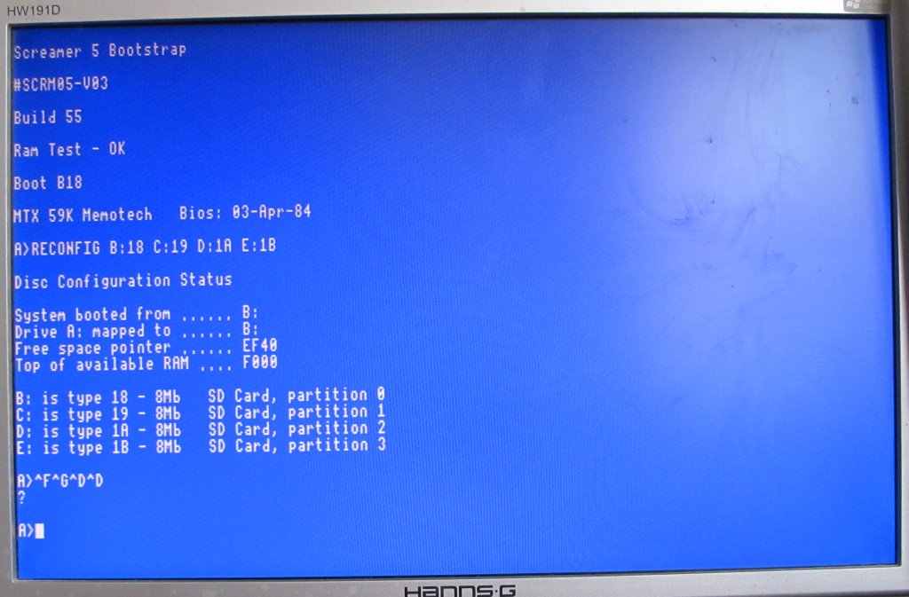

I've been tweaking my ATF1508 board and have managed to push it to 800x600 SVGA. with 100 x 32 text
There's one 4k dual port ram still a stock 55ns part, the CPLD is 10ns. The 25.175mhz clock is replaced with a 40mhz.
To keep the screen mapping simple, each row starts on a 128 byte boundary. Which means the character data has to be squezed in the "spare" 28 bytes at the end of each row.
So:
line 0 is 100 bytes screen data, 4 bytes padding 8 byte data for character 32, 8 bytes data character 64, 8 bytes data character 96.
line 1 is 100 bytes screen data, 4 bytes padding 8 byte data for character 33, 8 bytes data character 65, 8 bytes data character 97.
etc.
Tha allows for 96 characters plus there inverses. Character codes 0 to 31 would generate odd 1/2 screen data half padding characters.
Since 32, 8 pixel characters rows is only 512 lines with each pixel doubled, there is a 9th row of border under each character to stretch the screen to fill the space better.
Seen running CPM VHDL is included if anyone's interested.

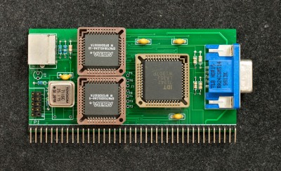

Received a batch of pc board from JLCPCB this afternoon. Among them is the VGA6448 rev1. It is the easiest board to build so I put one together this evening. Everything fits, but the two PLCC44 sockets are quite close and the PS2 connector is a tight fit. I only have the VGA CPLD design ready; the PS2 keyboard state machine is still work-in-progress, so I pulled off the PS2 CPLD and plugged the board into a 5-slot RC2014 backplane with CRC65. The picture shows VGA6448 in the foreground and CRC65 behind it. Well... it works.
Now I need to find time to work on the PS2 keyboard state machine. Too many fun projects going on...

Looks Good, I'll wait and see how the PS2 keyboard works and then I might have to order one with a 7032 programmed for me unless the 1504 can substitute for a 1502 in the same socket.
Re: VGA6448, text-based VGA in ATF1504AS CPLD
that is a very clean looking PCB!
Is there any harm in leaving an unprogrammed PLD/CPLD in it's socket when powered? I thought all the IO would just be in Hi-Z.
the ATF1502 and ATF1504 have the same exact pinout for their 44 pin version. only difference is the amount of Macrocells, so you should be able to swap out one for the other.

Thanks for the many comments. I'm currently working on the PS2 keyboard state machine, it is bigger than I though, but should fit in a 64-macrocell CPLD.
Regarding whether un-programmed CPLD's I/O are in high-Z state: I don't know. So I thought the safest approach is just removing the unused CPLD.
I will publish the design information of VGA6448 here. It currently describes the prototype VGA6448, but will be replaced with rev1 of VGA6448.
I will have extra VGA6448 rev1 pc boards and I can mail blank boards to CRC65 users who are interested in trying it out.
