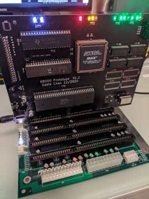

I can second that. I am using Quartus with Verilog on my 68000 build and it is very good and productive. I am using the EPM7128S for all the glue logic and SPI. Here's a picture of my build.
I got the SPI Master working last night driving a oled display.

I can also see 27C1024 PROM, 16C550 DUART, and 12MHz 68000. I can't make out the RAM. How fast is the processor running?
The QVGA screen is cheap now and it can be driven with SPI. SPI is quite useful for interfacing with modern I/O.

Very nice!
the sram is CY7C1049D. The cpu is running at 12Mhz (not try to overclock yet). That mandelbrot is C code with soft floating point math so a bit slow. Take around 1min 15sec to render.
