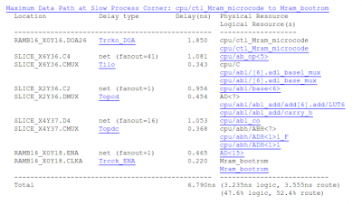

The ABL path is often the longest. The basic operation is already optimal, and very simple: there's an input mux selecting a base register, which is followed by adder that applies an offset. That's it. It's implemented in two layers of logic, which is the minimum considering it's dealing with 5 different input sources, 4 select bits, and it needs to do an addition.
However, there's still room for improvement, namely the select bits for that input mux. These should ideally come straight from the microcode ROM, but because of the limited width, these bits are compressed and need an extra layer of logic to get decoded. On Xilinx FPGAs, ROM is actually 36 bits wide (thanks to the 4 parity bits), so there would be enough room to put the mux select bits in there. However, that would make the control vector 33 bits wide, and I think that would be rude for people trying to work with a 32 bit wide memory (like the ice40).
But, there is hope. The input mux has a free input pin. The offset adder has no free inputs, but has a don't care in the 'case' statement. Also, the 4 encoded bits in the microcode ROM are currently picked arbitrarily. So, I'm hopeful that by picking a clever encoding scheme, the decoder can actually be integrated inside the mux.

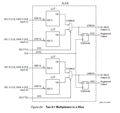

I did find a way to improve this path.
Re: My new verilog 65C02 core.

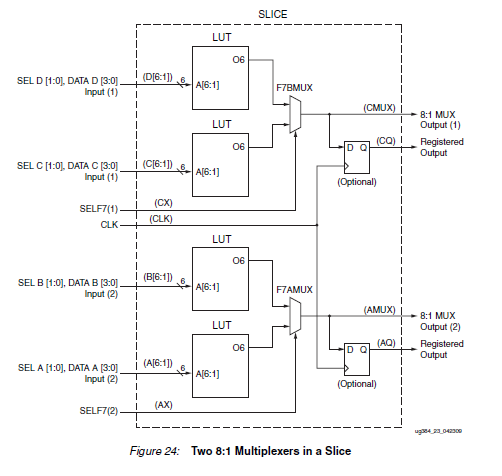

Thinking about this some more, I can go back to the original plan, using 6 input LUT for the mux, which has 3 inputs to choose from, and 3 selection bits. Ignoring the condition code, it is possible to take 3 bits straight from the microcode, which saves a decoder stage. From the 3 inputs, 2 come straight from registers, so these are fast. The other comes from the DB, which depends on how far the memory sits. For my high speed test setup, that memory is close enough.
Now, we can put 2 LUTs side-by-side, and evaluate both branch-taken, and branch-not-taken cases in parallel. The outputs then feed into a dedicated F7MUX inside the slice, which is operated by the condition code.
Total resources needed is the same, instead of 2 LUTs in series, we put them in parallel. The F7MUX is free, and very fast. In addition, this reduces the setup time requirement for the condition code test.

For some reason, it's not meeting 150 MHz constraint with new design (one run was missing it by 2 picoseconds), but this longest path is amazingly short with only 3 logic layers, although depending on the run, often our old friend, the Z flag from the ALU is critical as well, and sometimes simply the path from register file, through ALU, back into register file.
