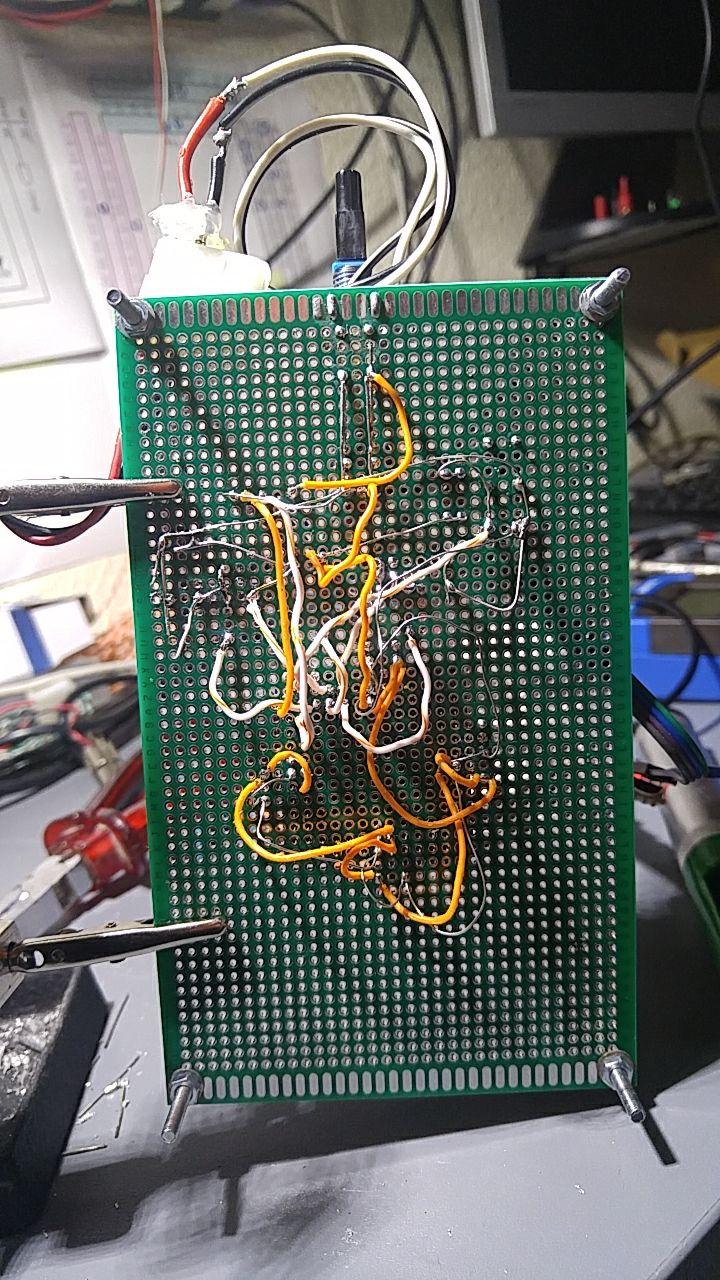

After a week of hiatus, I've been able to finish soldering the thing.
The w65c265s does use two clocks to boot: a slow 32768hz clock (CLK) and a fast (FLCK) clock, whose speed you can choose up to more or less 8 Mhz.
What's happening right now is that I put a 4,9152 Mhz crystal (as recommended in the data sheet, to be able to generate ceratin baud rates in the serial ports), but I can't get the chip to use it, so it keeps running at 32768hz (0.032768 MHz). It takes about 30 seconds just to output the welcome message trough the seial port.
I put the logic analyzer there and it detects that frequency even in the FCLK circuit... I have to figure now if the capacitors are the right value.

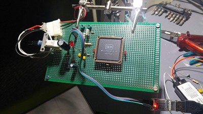

Well... after debugging and debugging... I have now my Mensch computer clone running at 4.9512Mhz.
Its a MESS but it does boot.

As I choose to put a 4.9152 Mhz clock instead of a 3.6864 MHz one, the capacitor values shown in the w65s265qbx schematics were not the right ones to the crystal I put.
The chip was running all the time at 32768 Hz. I could check that the serial port was actually sending out the welcome screen by attaching the logic analyzer. It was so slow that it took more than 30 seconds!!
I replaced the fixed value capacitors with trimmers and started to slowly adjusting them until they kickstarted the crystal. I can't tell the right values for them, though. They are such a small value that my cheap meter wouldn't give a reliable measure. The range they have is 5-30pf so the value is in there. Also, I suspect that once I start to add chips to the mix they will need more adjusting, but for now they make the '265 run.

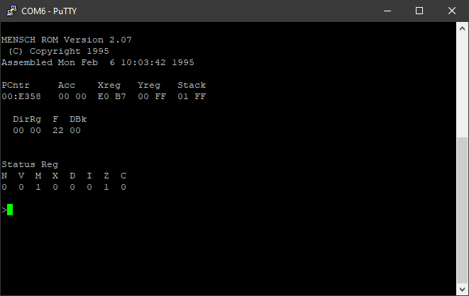

The next would be to fit the EEPROM in, and confirm it can be accessed. The documentation shows that the first thing that the '265 embedded ROM does is look for certain bytes in a memory location ($00:8000):
STATE #1 - "Essential initialization"
- Disable interrupts
- Reset stack
- "Enable External Memory"
- Set BCR to $01        (This turns on external address and data lines.)
- Set PCS7 to $20       (This turns on external chip select: CS5 from the W65C265S.)
- Check location $00:8000-$00:8002 for the string 'WDC', using CS5.
  If the string is there, transfer control to USER program in EXTERNAL MEMORY. (JMP $00:8004)
If not found, it changes the chip selects and tries again, in the same memory location, but maybe in a different external memory chip:
STATE #2 - "Check External Memory"
- Set PCS7 to $30        (This turns on external chip selects: CS4 and CS5 from the W65C265S.)
- Check location $00:8000-$00:8002 for the string 'WDC', using CS4.
If not found, it changes the chip selects and tries again, but with a different memory location ($00:0800):
STATE #3 - "Check External Memory"
- Set PCS7 to $08        (This turns on external chip select: CS3 from the W65C265S.)
- Check locations $00:0800-$00:0802 for the string 'WDC', using CS3.
  If the string is there, transfer control to USER program in EXTERNAL MEMORY. (JMP $00:0804)
If none of that applies, it then runs the internal rom code and presents the welcome screen.
MENSCH ROM Version 2.07
 (C) Copyright 1995
Assembled Mon Feb  6 10:03:42 1995
PCntr     Acc    Xreg   Yreg   Stack
00:E358   00 00  E0 B7  00 B0  01 FF
  DirRg  F  DBk
  00 00  22 00
Status Reg
N  V  M  X  D  I  Z  C
0  0  1  0  0  0  1  0

Eeeh! Well, it's possibly not a creation that will appeal to the human eye. But aesthetic issues aren't relevant to electrons. :P
Congratulations on your success! But please tell me there are some ceramic supply bypass capacitors snuggled up close to the PLCC, and they simply happen not to be visible in the photo. If they are indeed absent then that could very well explain why you had trouble getting the crystal oscillator working (not to mention attracting other squirrely problems in future). :!:
Thanks. Yes, there are four capacitors in NSEW of the chip. I'm recycling components from a old DENON audio amplifier. That's why there are different sizes or pacakges.
