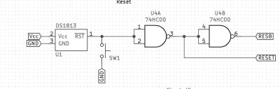

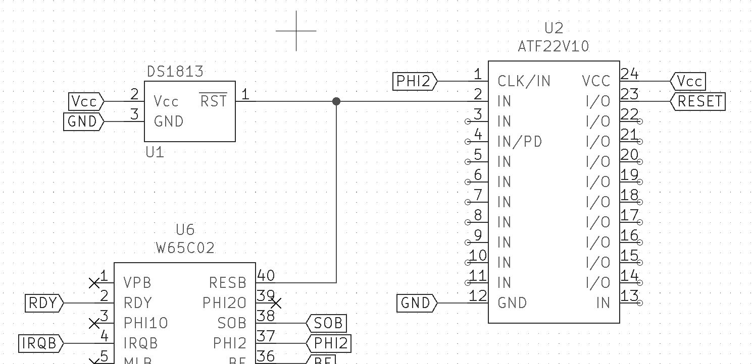

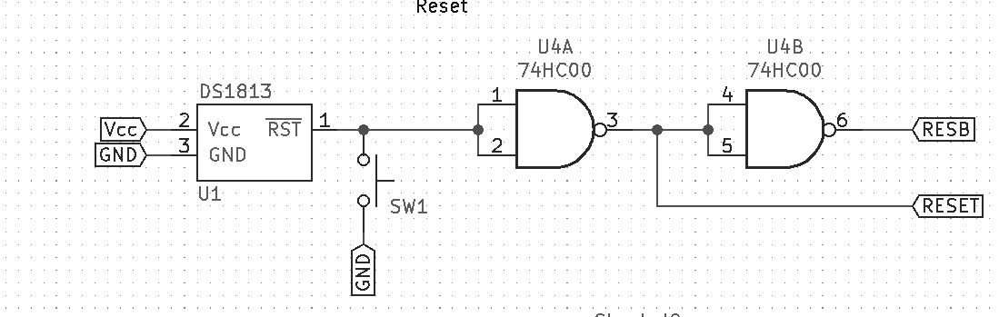

I've been away from the forum for a while...I went back and rebuilt my breadboard version following the schematic. While rebuilding the breadboard version I think I figured out that the problem I was having with the SC28L92 was due to noise on the RESET line.
What is controlling the 28L92's reset line that would generate noise?
When I was first adding the 28L92 I experienced occasional corrupted characters in the serial output. Trying to determine if the 6502 was writing corrupted characters to the 28L92, I decided to use the General Purpose register (1100 - $C) in the 28L92 to test whether I could write and then read back what I had written consistently. I'm not sure why, but at higher clock speeds I could sometimes read back what I had written to the General Purpose register, but at 1 MHz I always read $0F. The datasheet indicates that the General Purpose register is initialized to $0F on hardware reset. Probing the RESET signal with my oscilloscope showed a lot of noise.
Originally my reset circuit looked like this. I've removed a lot of the signals that don't apply to this discussion.
Original Reset Circuit
You previously commented that using the 22V10 as a simple inverter for the RESET signal was wasteful of the GAL's limited resources, but at the time I had a few unused pins on the 22V10 and decided to use them rather than add an additional IC just to generate the active-high RESET signal.
Notice that the PHI2O pin is next to the RESB pin on the 6502. On a solderless breadboard the PHI2O output induces a lot of noise on neighboring breadboard rows. In an effort to completely isolate the RESET signal I created the following circuit.
Updated Reset Circuit
After switching to the new reset circuit I have not had any problems with the 28L92.
My theory about where the noise on the RESET line was coming from may be totally incorrect. It may not have been induced from the PHI2O output, it may not have been propagating through the 22V10, and it may not have been a problem at all on a wire-wrap board or PCB. However, the change has eliminated my problems with the 28L92.
Shawn
