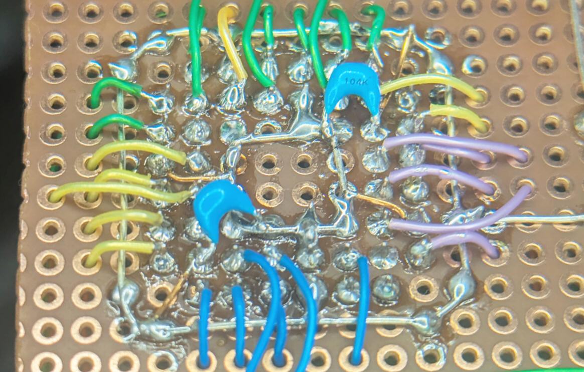

martingi wrote:
The transients are terrible. You can see each edge of the clock signal on every output, even with twice as much decoupling :roll:

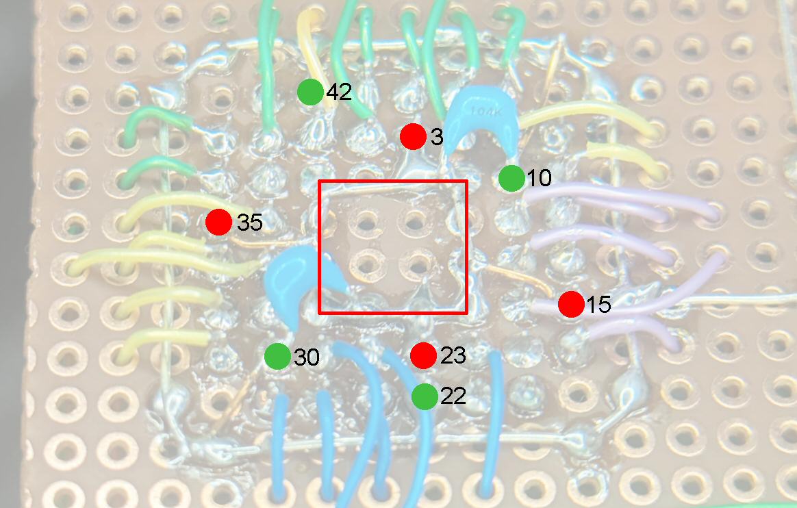

Martin, returning to this signal-quality issue, I'd like to talk about the power and ground rings you've established.
I get that the rings are intended to mitigate the perf board's lack of power and ground planes, and I've used the same approach myself. In regard to, as you say, seeing each edge of the clock signal on every output, you'll never be able to totally eliminate that (and some of the apparent noise may actually be the result of how your scope is connected). But I believe your ring approach has room for improvement, as ever do my own projects... it's all a learning process.
The crucial goal is to supply good power to the chip itself -- internally, I mean. We want reasonably clean DC between the tiny Gnd and Vcc traces right on the actual CPLD die. That's why we attach external bypass capacitors... and for best results we need a low-inductance circuit path between each cap and the die. That means keeping the conductors in the path short, which we do mainly in order to minimize the area of the loop that's created. Another fundamental way to lower the loop area -- and thus the inductance -- is to locate the two conductors in close mutual proximity.

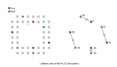

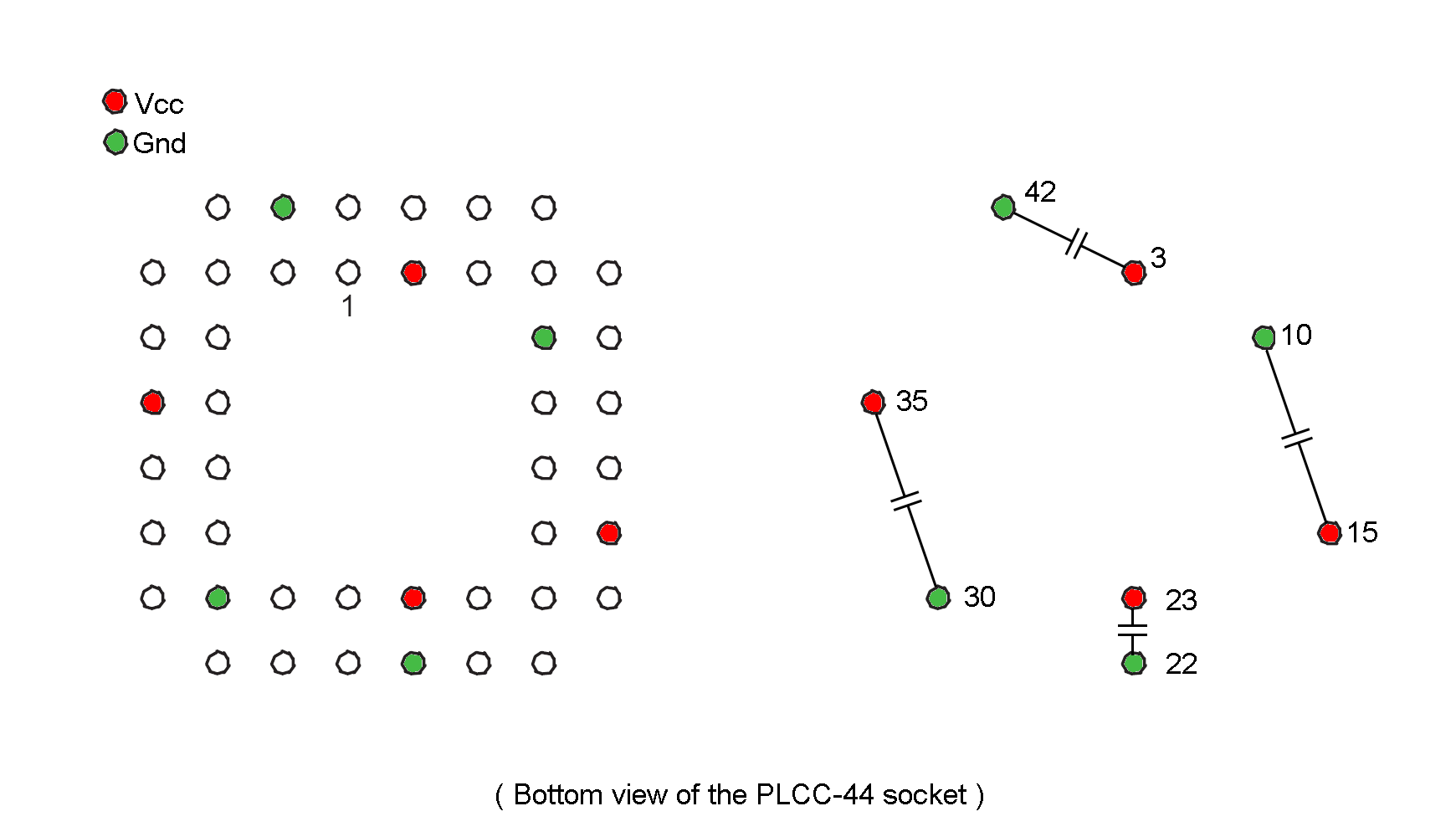

Shown above is a bottom view of the socket for your CPLD. On the right I've shown one possible way to take good advantage of the eight Gnd and Vcc pins. I've used four caps, but that's not because I want more capacitance. My main concern is to make the best use of the pins. So, I began by connecting a single cap to the die, taking care to keep the connections short and the loop area low. Then I repeated the process until all the Gnd & Vcc pins were gainfully employed in the same way, ensuring reasonably clean DC on the actual CPLD die. :)
As for rings, they're merely secondary -- an afterthought! :shock: I know it's tempting to start by focusing on connecting the pins to a pair of nice, tidy rings, then focus on connecting the rings to the caps. But notice you've gotten distracted with a two-step approach, using the rings as a middleman. Sometimes that'll be pretty harmless, but in this case the locations of the Gnd and Vcc pins are NOT particularly tidy, and IMO it's best to begin by putting the caps where they can most effectively be attached to the pins. Then -- afterward! -- you can elaborate by adding whatever rings or other figures will (in the absence of Gnd & Vcc planes) make Gnd and Vcc conveniently available for connections to other devices on the board and to the PSU.
Perhaps your existing layout (below) will prove satisfactory. But even minor changes would be beneficial. For example, how about adding a cap between pins 22 & 23? I know you're using point-to-point wiring, but that needn't rule out the use of SMT capacitors! From my own experience, I know a SMT cap can quite comfortably be located between two adjacent points on a .1" grid.... 8)
