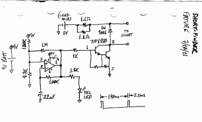

But a fat VCC trace can actually be a disadvantage in certain troubleshooting situations, such as when a chip or a bypass cap has shorted. You're better off to have skinny VCC traces because their resistance is high enough that there'll be a measurable voltage drop across the trace that feeds the shorted component. (Have been there and done this IRL -- a tidy solution to an otherwise nasty situation.)
I made myself a short-finder for this purpose, that puts 2A pulses through, at less than 2% duty cycle, and I can use the oscilloscope on the 5mV/div vertical gain setting to probe around the board and track down the short, even between planes (which usually means where there's a shorted capacitor that goes from one plane to another, but you can even detect where a short is in the board itself!). Here's the sheet in my 3x5" workbench quick-reference guide:
The op amp is just a cheap LM358 8-pin dual op amp.

Pulsing the current- I like that. Would an infrared camera help at all?
An IR camera might help if you don't pulse the current but limit limit the current to the highest level the traces can safely handle. A 2A pulse for less than 2% duty cycle is less than 40mA average which will only raise a .008" trace's temperature by about 1.5°C (and take a long time to do it). If the traces are underneath components though, or on an inner layer, it will be extra difficult. For a short between planes (which hopefully will be at a component), depending on the component, the current may have to be awfully high to find the short with an IR camera.
