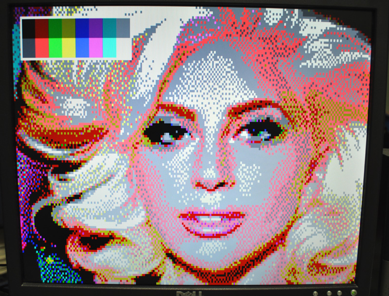

I finally settled on a good compromise between the minimal available SRAM and a graphics mode.
Using just under 13K, I made a fully bitmapped 216 x 120 mode that can display 16 colors at once.
The DAC is just 6 resistors setup as R-G-B-I. The "I" bit is intensity, so there are 2 shades of 8 colors.
This is quite similar to the C64 Palette. Pixels are packed in nibbles, so 1 byte equals 2 pixels.
Here is a converted image along with the full 16 colors that can be displayed...
The previous block mapped video memory was just way too limiting to do anything fun with.
This new video display mode will be fast enough for decent games or demos, as well as text.
Here is the original image for comparison. ..
Here is the memory map showing how the 6502 will use the available RAM and ROM in the AVR...
I now have the 6502 coming up and running the infinite NOP test, so this is a good start.
