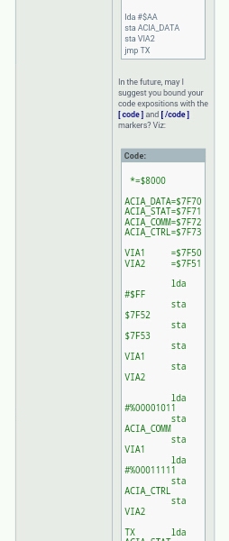

Normally I would agree. In fact, I still do agree. But ironically, your post, the (code) block is all but unreadable in the mobile layout.
What are you seeing? I don't use a smartphone or tablet, but I checked nearly every page of my website on our son's smartphone, and it all appeared as it should, basically the same as on my large PC monitor but tiny. Everything showed up exactly as I intended, without my putting any effort at all into making it mobile-friendly.

It took me a while but I attached an image; please see my previous post.
Re: Daryl's 6502 SBC help
So can't you just rotate it 90° to get a landscape layout? It works automatically with all the smartphones I've seen.

I guess so. I hadn't realised that it would affect the code blocks.
