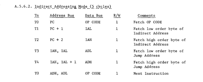

It is perfectly documented in the original 6502 manuals:
MOS Technology 6500 Series Hardware Manual
MOS Technology 6500 Series Programming Manual
Perhaps it would help if you could quote how exactly the jmp () warparound is documented in order to identify whether this is really a feature and not a bug.
Re: 6502 redundant, missed, and suggested features
Posted: Sun Aug 21, 2016 11:19 am
by Arlet
The detailed description I've quoted above shows the wrap, and the hardware manual has the same description again. At the very least, this indicates that the wraparound was a known and documented issue at the time. Whether they considered this a 'feature' or a 'known bug' is impossible to tell.
According to the description quoted by Dr Jefyll, the NMOS 6502 uses the PC to increment the address, like I do in my core, so I would think that it would be rather simple to increment the MSB as well. The hardware is already there.

The original programming manual did not warn of that fact, but rather boldly stated in the details where it comes to increment the indirect address: IAH,IAL+1 - fetch ADH. And yes, the manual does not mention the word absolute in conjunction with JMP indirect.
The changes versus the NMOS CPU are well documented in the 65C02 datasheet, so according to your logic are features and not bugs of the CMOS CPU.

I was referring to the text in the programming manual: "In the JMP Indirect instruction, the second and third bytes of the instruction represent the indirect low and high bytes respectively of the memory location containing ADL. Once ADL is fetched, the program counter is incremented with the next location containing ADH."
Maybe the original design meant to use the PC, and get a free 16 bit increment, but then they changed the design to use the ALU instead.

Thanks, yes, I see it now. That's a good example of a manual trying to explain too much, perhaps - it doesn't reflect the implementation! In fact, it almost looks like a classic case of confusing the PC with the address bus.

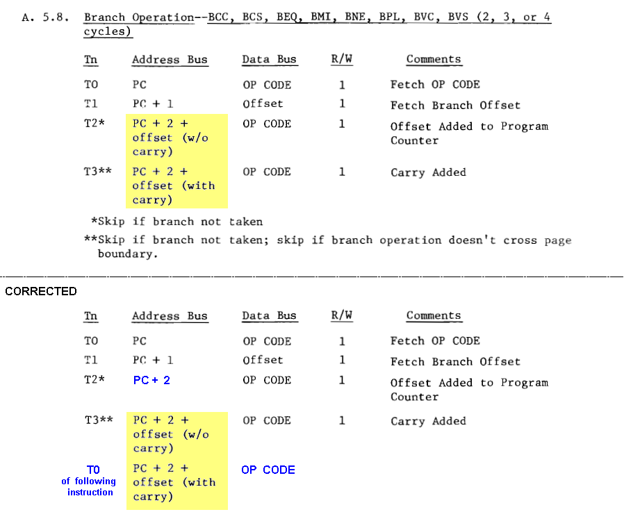

Regarding the doc, I'd say the conflicting indications are both too insubstantial or untrustworthy to read much into. Arlet suggested MOS might've eventually changed the design, which'd explain the puzzling mention of the Program Counter in the text of the programming manual. That's possible, but to me it seems more likely the author was simply writing in a hurry and chose to include a slight inaccuracy rather than being conscientious about internal details that don't affect the user anyway.
As for this cycle-by-cycle description above, again I suspect that haste has won out over precise accuracy. I don't believe they meant anything by omitting mention of a carry into IAH -- I think they either didn't notice or didn't care/deemed it too awkward to express. IOW it's just coincidence that a slight omission of detail accidentally confirms an actual bug/feature. I could be wrong. But IMO that entire section -- the cycle-by-cycle stuff -- needs to be taken with a grain of salt, given that at least one rather drastic error slipped in (see below; details here).
They didn't omit anything. The description is exactly how the NMOS 6502 behaves.
Posted: Sun Aug 21, 2016 6:42 pm
by Dr Jefyll
I don't have a strongly-held position on this -- I'm just indulging in some idle speculation. :) Yes that's how the NMOS chip behaves -- the lack of mention (in the cycle-by-cycle section) of a carry into IAH turns out to be accurate. You feel the lack of mention was deliberate, which is a plausible outlook -- but an alternative explanation is implied, IMO, by an error that to me says the cycle-by-cycle section was hastily done and lacked proper proof-reading.
Supposing the lack of mention in the cycle-by-cycle section is deliberate, can you suggest why the text portion isn't similarly candid and forthright? (Maybe it is their way of being subtle!)
