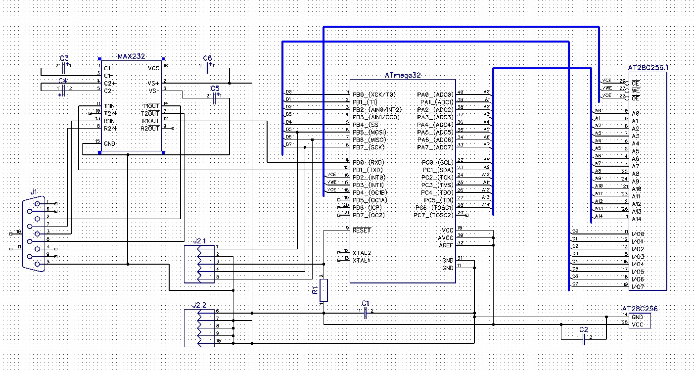

Just one question, would you be able to make a additional PCB design from a more complex layout? I was thinking about a standalone ATMEGA328 and a MAX232 for a more universal programmer.
Mario.
I built up my W65C02 in a free run configuration with a 1MHz oscillator and a DS1813 reset circuit. So it's good to know that burned EEPROMs will work.
Mario.

But the intention is to have a very easy to build system. And afaik the AT16U4 is only available as SMD device. I would prefer all components in DIP form factor. Who ever needs a USB connector can use the Arduino shield, because it's the cheapest solution. Arduino Uno clones are available for a couple of bucks on eBay. But for those who want to use the programmer with their own SBC projects or an old computer with only RS232 connectors, they can use the new board. You can also use a FTDI breakout to get the new board connected via USB.
Maybe we can also switch to a ATMEGA32, that has much more GPIOs so we would not need the shift registers anymore. We need only to connect address and data line directly to the ZIF socket and push the bytes out, because we have at least 3 complete 8bit ports without using PD0 and PD1 (RX;TX) and there are enough GPIOs left for /WR, /OE and /CS. So firmware would be much easier to write and will be faster too. Maybe I'll get pagewrite to work with this easier.
Running the Atmega32 with its internal oscillator at 8Mhz would reduce the number of components too.
UnaClocker wrote:
Perhaps doing it with an AT16u4 would be more ideal, as that's a Native USB device. It's what the Arduino Micro, Leonardo and Teensy 2.0 use.
Re: 28Cxxx EEPROM Programmer
I just clicked together a draft in Diptrace. Maybe somebody can take a look at the schema. I've never used a MAX232 and just googled for the basic usage.
I connected also a 10pin ICSP header for easy programming the ATmega32.
