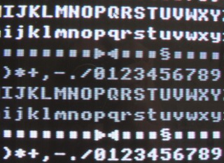

And a text buffer with light and dark letters. I just copied this from an earlier project, but modified the spacing a little bit.
