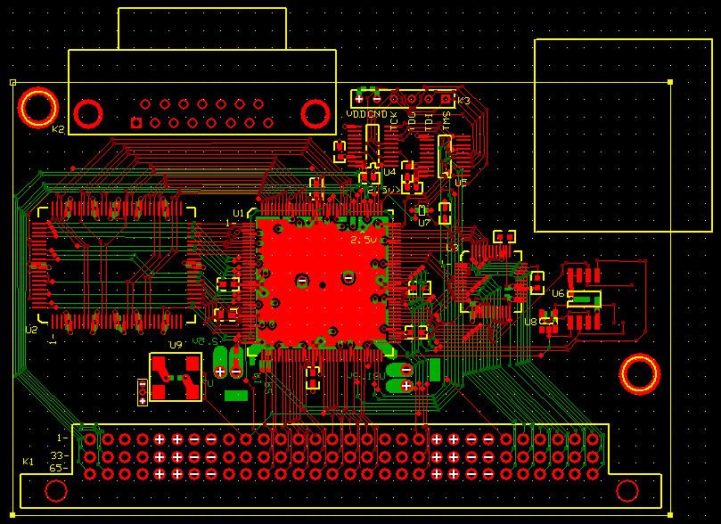

Got the parts in. For sure Cypress deserves mention because I had to buy the SRAM direct from their online store as noone else had any in stock. I just paid for the IC's (I got 2 @$38ea) and shipping was free. Overnight shipping! So great job there. Not sure about shipping overseas though...
So quickly placing the DB15 VGA connector in the upper left and the SDcard adapter in the upper right of a spare 3.8"x2.5" devboard, there's just enough room for the JTAG connector in the middle. The mini HDMI connector will have to be mounted on one of the sides. HDMI IC's will be made to fit somehow!
The force needed for the push-in/push-out action of the SDcard adapter seems abit much, but hopefully it will break in over time. The holes I place will have to be a perfect match for the mounting tabs, so as not to encourage any movement when pressing down. This is why I brought my digital micrometer home from work, just to double check the spec sheets. Also, the fit of the 96-pin main female connector to it's receptacle has a good feel, almost like a snap when it's fully seated. Not too difficult to pry apart either despite the large number of pins. I imagine it will be even easier with a board connected to it, where one can grasp the board to unseat it.
Anyway, back to work (play).

Now let me ask Arlet something if I may:
Right now I have the FPGA in the middle of the data path between the SRAM and videoDAC. Currently this uses 16 pins for the data bus and 24-pins for the RGB data.
Could I hook the SRAM directly to the videoDAC and have the FPGA tap off of that 16-bit bus? and in addition provide 8 more signals to the DAC? This would potentially save 16 pins.

Well, thinking back to the old days of discrete components using a 6545 and 6502, a typical video system would be organized as I described above and be able to freely do R/W operations to the video RAM during non-display periods. I'm just not sure how tight timings are nowadays with LCD/TFT/PLASMA Hi-Def displays, i.e. if the non-display periods offer any appreciable time to modify video memory since we are not waiting for an old style CRT gun to do a retrace.

Bah! The FPGA will have to be the arbiter for videoRAM access in a parallel system, so it must be in the middle, thereby imposing it's own ~7.5ns delay. The bottleneck will be the total delay added after all anticipated boards to be hooked up are wired in. This seals in the 5-6-5 configuration.
Re: Future plans for Dev. Board v1.2
The video signal would just arrive a bit later, but as long as you also delay the hsync/vsync signals by the same amount, that wouldn't matter at all. In practice, you would just delay everything by a couple of clock cycles.

Now that I am 99% done, of course an idea comes to mind which shatters all my work this past week on board layout. I am not confident in my mode of communications which leads me to keep thinking of alternatives that have potential. Although the Spartan 6 is great for embedded CPU and high speeds signals, I am not convinced I need a CPU so close to the video out signal, especially since the 144 pin package is lacking.
All I really need is to make Arlet's SDRAM SDRAM video interface work with the SRAM. What I mean is to put those 3 modules (4 minus SD interface) into a Xilinx Coolrunner IIXL QFP package style 208-pin CPLD. There is a 208-pin QFP version with clock doubling/dual edge FF tech, sounding similar to DDR of the S6 FPGA.
All the pins would include:
41pins = 22 address + 16 data + 3 clock. CLK, CS, WE for synchronous RAM.
