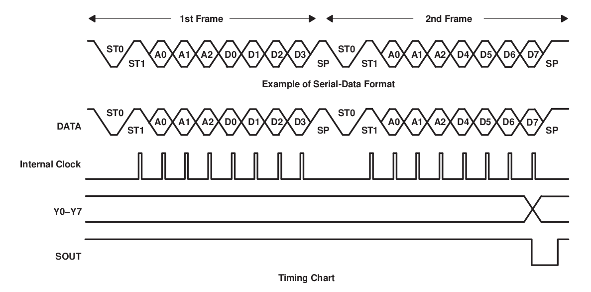

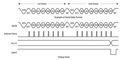

as these devices don't speak the standard serial protocol.
It depends how you look at it: I think they do if you look hard. They're an 8 bit, one start, one stop with the normal polarities, with the low bits first and with bit 0 always 1. See diagram. But you have to be careful to ensure that you have all the bits in the right order and right sequence :mrgreen:

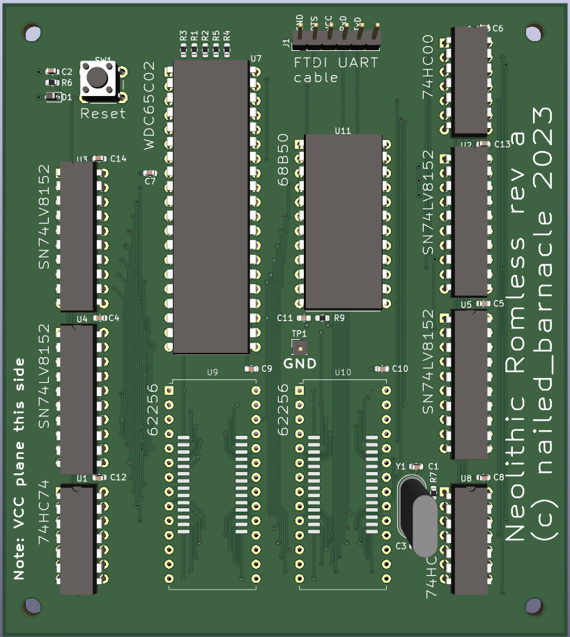

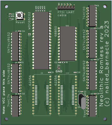

A render of the proposed board. I think I'll get this one off to JLCPCB along with the STM board - also romless, but implemented in a different way. Both need some code writing and I haven't decided which I like better yet.
(hurriedly check that Mouser have some of the 8513 parts in stock!)

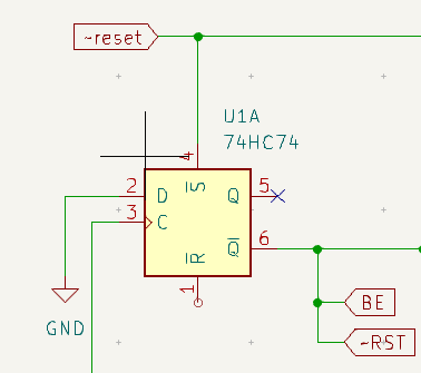

A minor change to make the reset work: reset on the lv8153 forces all the outputs low, which would have immediately released the reset line as originally drawn. Now, the manual reset forces BE and ~RST low, and a write of any data to the lv8153 at 0x3 writes a zero to the latch, taking BE and ~RST high (and disabling the outputs on the lv8153 chain).5
Oops! :mrgreen:
edit: and that unconnected pin should be taken high, too...
