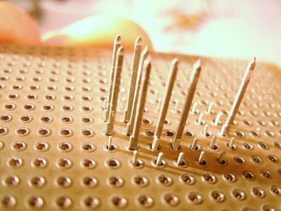

Ok, I took a picture of one of mine, a 44-pin, from Aries (although they no longer supply it):
It's no bigger than a standard thru-hole one.
[Edit, 1/21/13: BigEd just pointed us to a source that stocks them: http://uk.rs-online.com/web/c/?searchTe ... ra=oss&r=t ]
I'm pretty sure the Aries device in Garth's photo is just a rather specialized wire-wrap socket mated to an ordinary, solder-tail PLCC socket and sold as a single product. It looks pretty good. :) But in case the price & availability don't suit you there are alternatives. Here again (below) is an ordinary, solder-tail PLCC socket, plus some plate-through PCB proto-board and two different styles of pins.
"Plan A" (below) is to use machined socket pins similar to those in the Aries product. These ones are 0038-3-17-15-30-27-02-0 from Mill-Max Manufacturing. They're a bit pricey but cheaper overall, I expect, than an Aries socket, especially if you buy the Mill-Max in quantity. You may want to stock up anyway, given that the same pins can mate with a lot of different stuff (including various sizes of PLCC sockets).
"Plan B" (below) is to use plain pins, carefully wedged into the same holes occupied by the solder-tail pins of the PLCC socket. It's tight, but you should be OK as long as you pay attention to the rectangular cross-section of the solder-tails. The final step is soldering, but for the photo session I didn't do that.
I have yet to use these ideas on a real project but they look fairly workable as long as you take your time and use a fine-tip soldering iron. In particular, you'll want to plan the sequence so the inner rows' pins get installed and soldered before they're blocked by the outer rows. Also plan your connections to Gnd, Vcc and especially the bypass caps.
Be sure to use proto-board whose holes are plated through, as they offer better solder adhesion and thus more mechanical support. You don't want any pins twisting off during the wrap process. That could be tricky to fix if the neighboring pins are already wrapped and the region is congested with wire. :cry:
Finally, here's a top view of Plan B -- but what I want to draw attention to is the power plane surrounding the plate-through holes. Because there's no solder mask, the entire surface is susceptible to accidental shorts. All it takes is an errant shard of wire-warp wire or a tiny spatter of solder.
If your luck is bad, such a particle could lodge itself invisibly underneath the PLCC socket or some other component, and it would be impossible to detect and fix. I'm not a worrier by nature but I am uncomfortable with a power plane on the top (component side). The board in the photos is from Twin Industries, and they offer a double-sided power plane version as well. But I'll settle for a ground plane on the wiring side (bottom) only, where gravity isn't attracting debris, and where you have a better chance of seeing & correcting any trouble.
cheers,

I like plan B, because it makes for shorter connections (and therefore less inductance) from the planes to the IC.
When there's a possibility that's anything like that, you measure as you put each part on (in this case, the socket or a pin), so that if a problem shows up, you know it's at the part you did last. If you wait until you're done and admiring your handiwork to check and find a problem, you won't know where it is. I have to do this with the embedded bypass capacitors I put in my memory modules. Those embedded capacitors resulted in more manual labor than I bargained for, but I think they're still worth it (marginally).
Whether you use a single plane or double, solder a chip capacitor from each Vcc pin to the ground plane around it. It will have absolutely no lead length. That's the way we want it for best high-frequency behavior.
Right. And if you really wanna do it right, don't use a socket. The tines add 5 mm or more to the circuit path, as compared to a PLCC soldered directly to the board. (But of course with no socket it'll a hassle replacing that chip, so be extra careful to avoid ESD and other forms of damage.)
