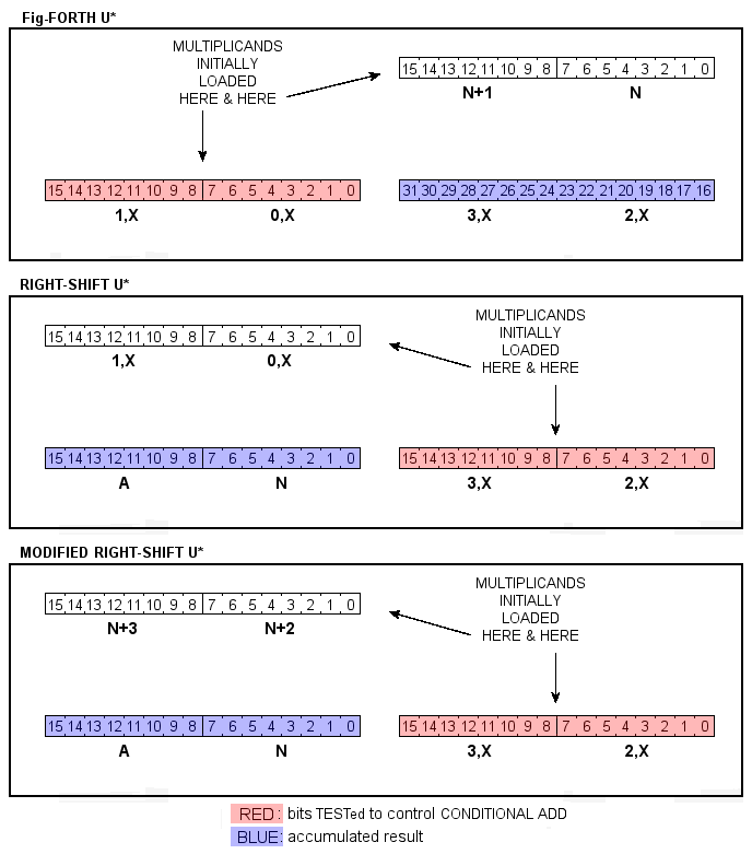

Posted: Mon Apr 20, 2015 5:54 am
by Dr Jefyll
It looks right to me, Mike -- and a tidy piece of work it is! There is a way you could cut about 90 cycles off the execution time, but it adds about 30 bytes, and I have a feeling it's the memory economy that's your priority.
FWIW:
  • Right now you have a loop that iterates 16 times and contains a 4-byte (32-bit) shift.
    But only 3 bytes are actually used each iteration. One byte isn't read or written but still gets shifted. That can be avoided.
  • The faster alternative is a loop that iterates 8 times and contains a 3-byte shift,
    followed by another loop that iterates 8 times and contains a slightly different 3-byte shift.
To see what I mean, compare the middle and lower sections in the animation above. The middle section illustrates sixteen 4-byte shifts, and the bottom section illustrates eight 3-byte shifts followed by eight slightly different 3-byte shifts. The animation illustrates a few multiplication routines, discussed here, but the same shifting shortcut can be used for division. Were your division routine rewritten to exploit this, the first loop could omit shifting stackl+1,X and the second could omit shifting stackh+1,X.
cheers,
ps: "TOS and TOS+1 are at fixed points in ZP." TOS resides someplace other than on stack??? I guess this relates to the split stack you're using. TOS is treated differently than the other stack items so it can be used as an indirect pointer -- is that right?
[Edit: add illustration; modify text]
