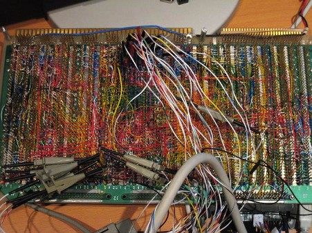

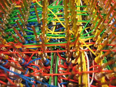

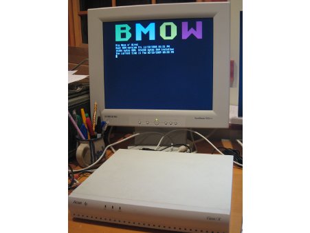

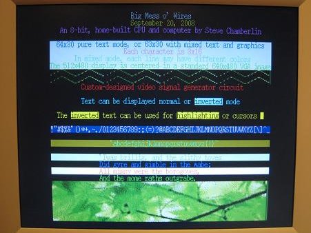

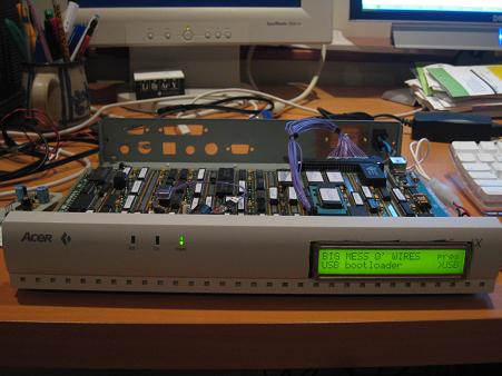

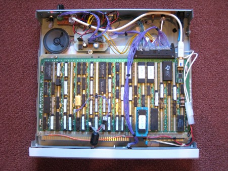

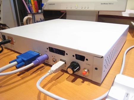

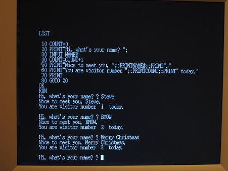

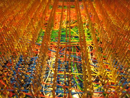

Thankyou for the links. I had forgotten about the other topic started by Rob Finch himself, to which I made the first reply. Now maybe I can finally get hold of him with the Email address on the web page that appears to be his. I never knew the "bc" in his bc_cpu Yahoo forum stood for "Bird Computer."
And wow, that BMOW computer you linked is insane! All done in 74xx logic, without a microprocessor. What an accomplishment!
There's an important activity I'd call 'verification' ...
... using reconfigurable logic: you can implement early and keep revisiting ...
Thanks for the pictures - well worth another viewing. Inspiring.
