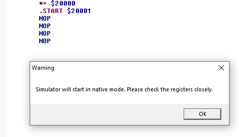

I have come up with a solution for the .START issue above Bank 0.
The assembler now accepts the higher address and will save the Motorola code with the S8 record.
When starting the Simulator, this warning will pop up whenever the start address is above Bank 0.
Note, this will also happen without the .START directive if the source .ORG is above Bank 0. (this was a previously unreported bug. Simulator would start at the right 16-bit address but in Bank 0.)
My goal is the allow the assembler to produce usable code for export to real hardware while also allowing simulation to be as seamless as possible. I hope this satisfies both.
