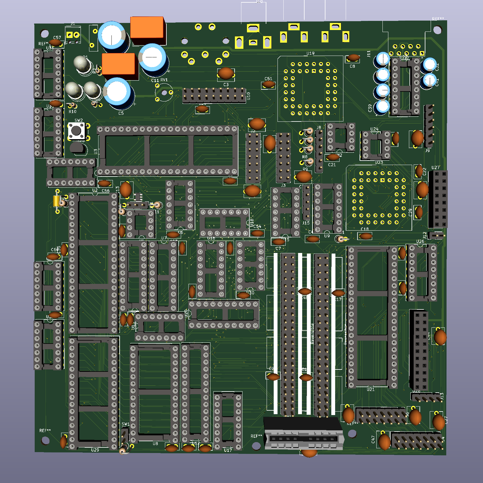

I've been way busier than I expected for the past little bit, but I'm about ready to send this design off to have the board made, Here's an image of the schematic, board routing, and 3d view:
schematic.pdf
(682.93 KiB) Downloaded 61 times
board.pdf
(241.16 KiB) Downloaded 57 times
Any glaringly obvious details I missed?

I did some clean up and have saved about 100 vias so far, I'm hoping by the end of today I can send it off, I've been incredibly busy recently (yet again) so this has fallen by the wayside. If anyone has any input on the design (schematic) it would be much appreciated, I think I've accounted for everything but I'm not certain.

So, I think I've reviewed it pretty well at this point, I have another question on the board though, should I go for a HASL finish or ENIG gold? it's about a $20 ($4 per board) difference, and most of the boards I've worked with in the past were ENIG, although I've seen a few HASL from time to time.
Re: 65XX SBC general help and color display help needed
There's nothing at all wrong with HASL—unless there's something about marine applications perhaps, where salt is a problem.  :lol:
backspace119
Posts: 346
Joined: 25 Jan 2019
Location: Knoxville, TN
Post by backspace119 »
Ok, as far as selling the spare boards, is it legal to sell leaded HASL boards? I don't think any of the guys I've talked to live in California, if that helps.
If the solder is leaded, you're not supposed to sell it to Europe (because of the RoHS); but for the negligible quantities you're likely to sell, I don't think anyone is going to care.  Now if it were a consumer-volume product like cell phones, they might not look the other way.  At the company I work for, we always go for hot-air solder leveling and leaded solder.  We buy 5,000 boards at a time.
The lead issue is to do with consumer goods sent to land-fill (at end of life, hopefully). It's perfectly legal to buy and use leaded solder for hobby/non-commercial projects and IMO preferable if the stuff I've read about the lead-free flux is true... See for example: https://uk.rs-online.com/web/p/solders/0555235/ you just can't sell items made with leaded solder. (Although there are exceptions).
I have the option of buying PCBs from the Chinese PCB place I use, which come with a lead-free HASL finish too, although it adds about $8 to a batch of 10 PCBs.
That's nice to know.  Is that true for all of Europe, or just UK?  I was not involved in the decision at our company.

I don't think there's any difficulty in obtaining ordinary lead-tin solder in Finland, from Germany.
I think the rule of thumb is: if you're building it by hand and not mass-producing it, the RoHS regulations need not be applied in full.

I'm taking my first break from building now and I'm sad to say I've found a few bugs with the board. Luckily, none are life threatening to the computer, they're only fitment issues of certain parts, and only one of which I was unable to rig to get it to work.
First, the composite video out jack had a vertical square peg on the center back instead of horizontal, I drew the footprint for it since kicad didn't have it, and I was pretty sure I was thorough, but I must've missed it, because I made the hole a horizontal slot.
Second, the cartridge connector holes have too small diameter for the pins to fit very far into them, I was still able to get it soldered, but it's standing off the board a bit, the pins are conical with slots in the center, and I must've not used the top diameter for the holes (made that footprint too).
Last, and this is the worst one, the D-Sub 9 connector for RS-232 is unable to accept the jack I ordered, and probably any jack for that matter. The pins are right, but it doesn't have the board holes for the mounting pegs. I didn't make this footprint, but relied on one provided by kicad. My best hope is to cut the pegs off of the connector, and be careful when attaching and detaching cables, or, I may make a standoff board that connects to it, and has the correct footprint on it.
Overall, everything is going smoothly, I've got the CPU, both VIAs, UART, MAX232, 65SPI, header for 4M memory module, some capacitors, the power phase, digital pot, trimmer, reset circuit, UART clock, 32k SRAM, RTC and a few gates installed so far. One other unfortunate truth I learned was I forgot to order the LTC1799, the clock generator for the board. This is ok though, since I'll need to spend a few days programming the EEPROM with an arduino anyway, and it will get here by then (actually I ordered the LTC6900, it's worse than the 1799, but the 1799 was on backorder).
