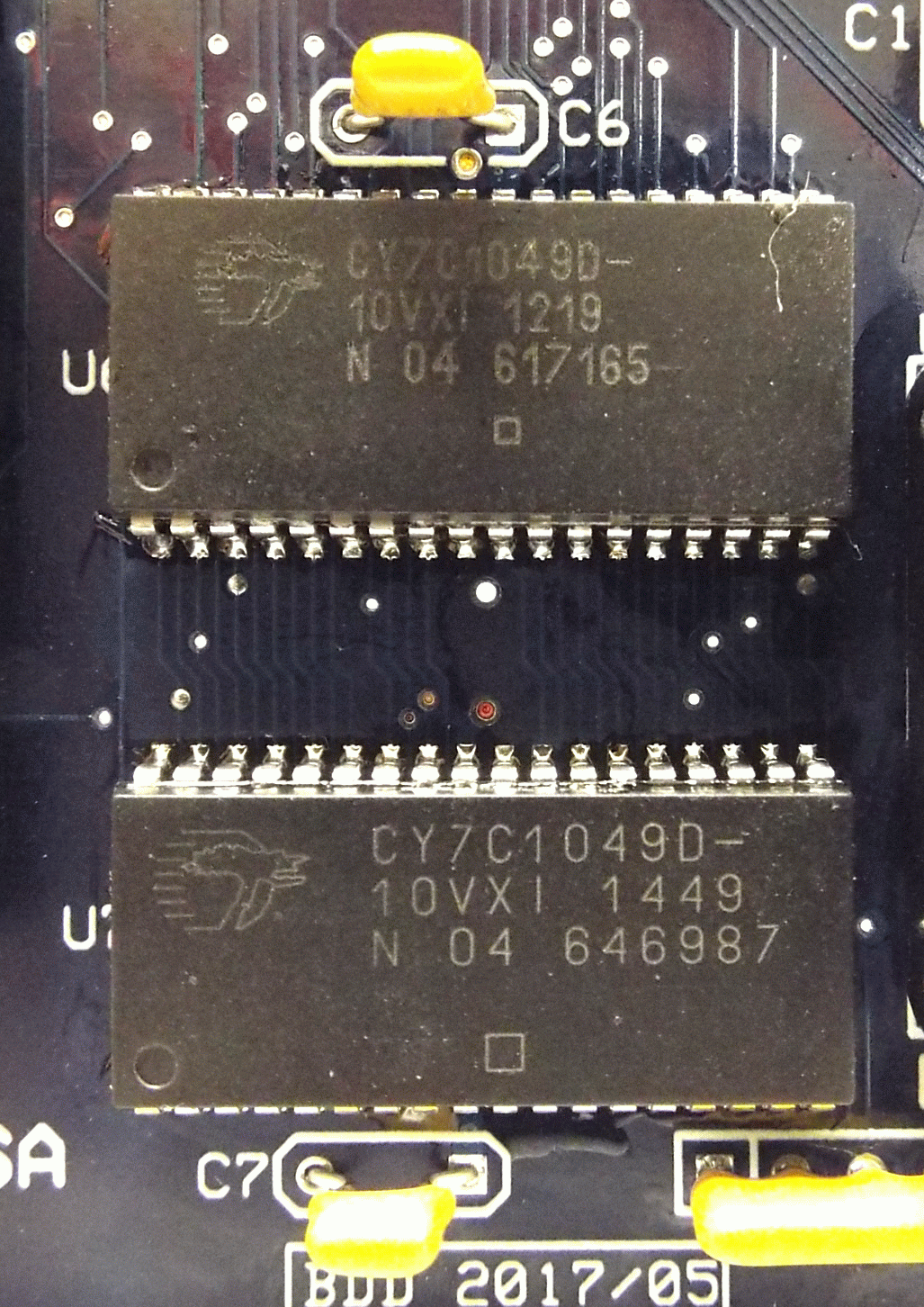

Installed active devices in the above photo are the two 512K SRAMs (near bottom right), two MAX-238 transceivers (left), a NAND gate being used as an inverter (near bottom left), the IRQ AND gate (immediately above the left hand DIP socket), the UARTs' X1 clock generator (bottom left) and the two Maxim DS1813 reset generators (right side above MPU socket), one of which is used to dampen the NMI circuit. I see a response when I manually negate each of the IRQ AND gate inputs, as well as the NMI circuit, so I'm good there.

Close-up of SRAM, 1024KB total.

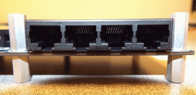

Close-up of the four-port serial output jack.  The console port is on the left end.
