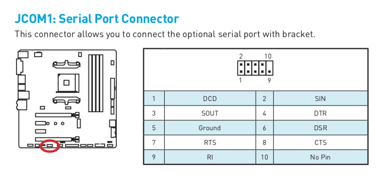

Many PC m/boards still have an RS-232 header built in, and only need a cable to a DB-9 port to make it usable. Check your manuals.
Do you know what the header would look like? The manual is quite long, and most of it is related to the UEFI. (I'll be checking it regardless, but I do sort of doubt it has it, as most of the IO is now on the CPU die on this board, the north bridge only really serves USB (and possibly SATA))

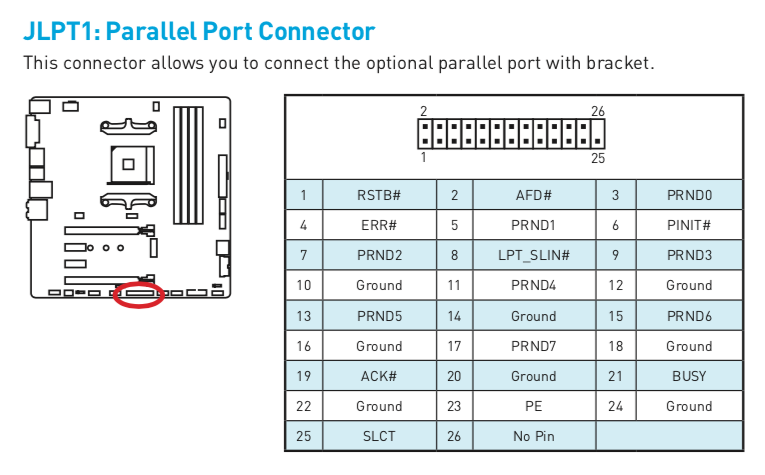

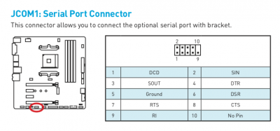

There's usually a couple of pages dedicated to pointing out and naming every connector on the board. It should be visible in that. Physically, it'll probably look similar to a USB header; to accept an IEC ribbon cable plug.
I've attached extracts from one of my own m/board's manuals to illustrate this (MSI B350M Mortar).

Ya I went through that part of the manual (had to get it online, couldn't find my box) and it's got nothing like that. I didn't remember seeing anything extra the first go around, USB headers is all it has in the way of IO (even has USB C header for a front panel USB C). That's a drawback of some of the new chipsets, a lot of IO is being done on die, and isn't really brought out to the board much (the new Epyc server chips from AMD do *all* IO on die, and have no chipset, the board essentially just provides wiring to various peripherals straight to the CPU).
EDIT: I suppose I should link the datasheet in case anyone wants to double check me, it's the MSI X399 carbon AC Pro board
