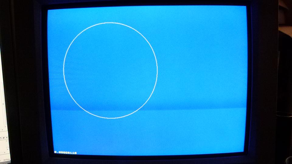

Thanks, Here's a pic:
Next on the agenda: Work on ellipses. Then Bresenham Lines. Then cube. Then rotate cube. :D
Circle @(200,200) radius 150. Resolution:640x480

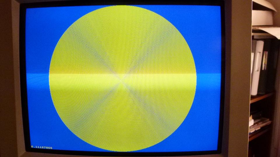

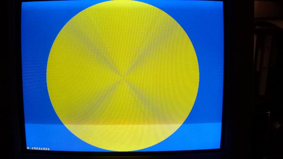

For the largest circle with diameter 239 placed @(319,239) it took .1mS.
Since it was easy and quick I did a test for a filled circle, by decreasing radii and plotting. Took 152mS.
K, I think I'm done for today. Whew. Time for a brew! Maybe I'll get some ideas how to optimize Daryl's code using other accumulators. Many thanks to him!
Concentric circles for fill.
