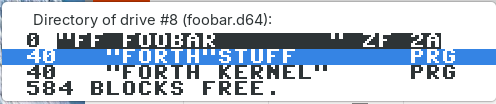

I really should have specified what I meant by messing up the file name. Commodore 64 file names are enclosed in quotes in the directory. If a file is saved with a shifted space in the name, the trailing quote gets moved to where the shifted space is.
Screenshot From 2025-07-06 01-30-19.png (7.71 KiB) Viewed 1624 times
The highlighted file name is the one with the shifted space.
This file can still be loaded if it is loaded as "FORTH".
LOAD"FORTH",8,1

Actually, that is not specific to the C-64.  That behavior occurs with all of the Commodore machines, from the PET through the C-128.  The directory listing you see when you do LOAD "$",8, followed by LIST, isn’t what the internal directory structure looks like on the disk—there are no quotes on the disk.  What you are actually seeing is how the BASIC interpreter has formatted the incoming directory information, which looks to the computer to be just another program.
As stored on the disk, each filename entry in the directory is a constant 16 characters in length.  Filenames that are shorter than 16 characters are padded with trailing shifted spaces ($A0).  To the DOS, the presence of $A0 acts as a filename terminator, which is why saving a file with a shifted space in its name produces the odd quote position you see in the directory listing.
Incidentally, you can hide a filename by preceding it with a null byte.  When you load and display the directory, that name will not appear.  However, it is still possible to open the file as long as you include the null byte in the filename used to open it, e.g., OPEN 2,8,2,CHR$(0)+"HIDDEN FILE".
That’s because the $A0 that immediately follows FORTH acts as the filename terminator.  The DOS stops the filename comparison during the directory search as soon as it encounters $A0.  All Commodore floppy drives use the same directory structure, so this trick works with all of them.
