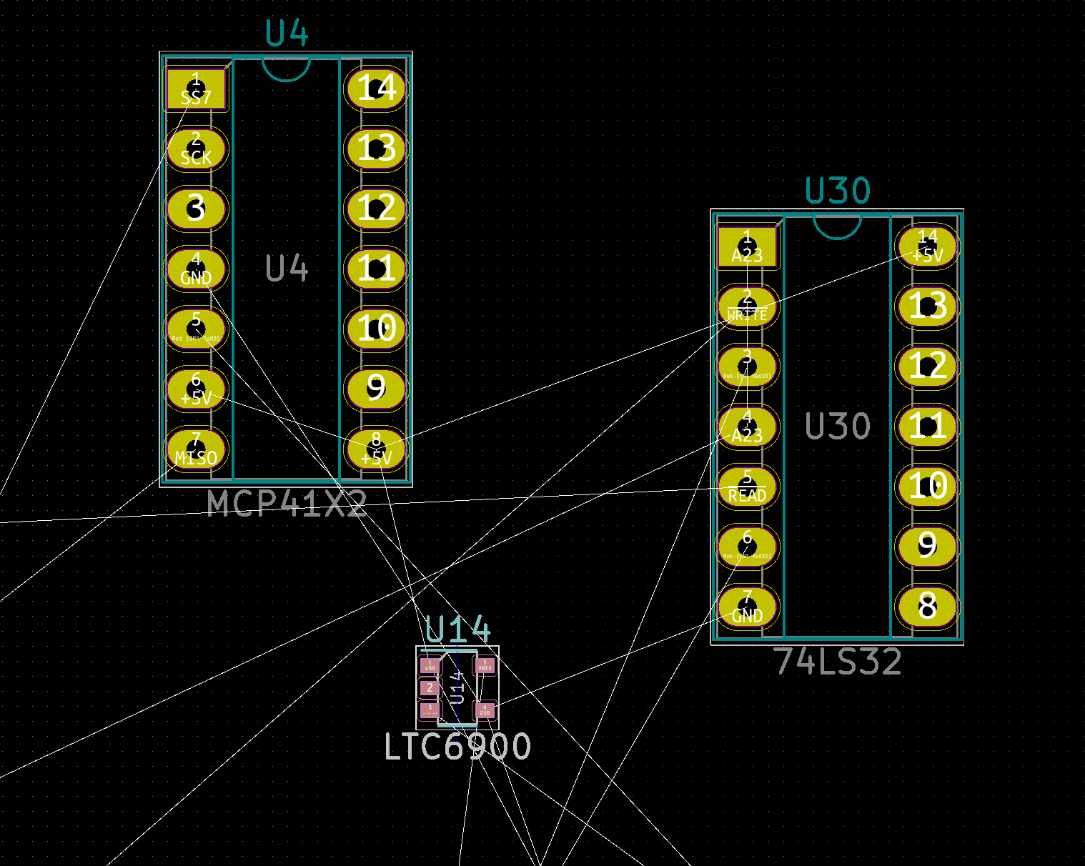

So, I'm worried about the size of the LTC6900, I'm not certain I can effectively solder something so small, I've included an image with dip 14 chips shown for reference.
Re: 65XX SBC general help and color display help needed
Posted: Sun Feb 10, 2019 3:15 pm
by Arlet
To make soldering a little bit easier, you could make the pads a bit longer so they stick out further. That gives you more room for tip of soldering iron. Also, if you put excess solder on, the bigger pad can handle it easier without causing a short.
I may try this, although I'm still a bit worried about it, I may try and find these, or something similar, in a better package
Posted: Sun Feb 10, 2019 3:34 pm
by Arlet
You could order some boards with SOT23-5 shapes on them, and some cheap SOT23-5 components to practice.
Or maybe find a scrap board with a SOT23-5 on it. Take it off, and try to put it back on.
Removing SOT23-5 is easy, just put a huge blob of solder on all the pins, go back and forth with iron to keep them all hot, and give it a push.
It's amazing what you can get used to. :shock: I second Arlet's suggestion. Get some practice with this stuff, using disposable parts necessary. :)

Thanks for all the encouragement on soldering this. What I was thinking of doing, since I've been wanting to do this for a while anyway, is getting some solder paste and either buiding a dispenser for it, or manually applying some to the board. This is the only SMD component on the board so I probably wouldn't get a stencil just for this. I'm thinking I could use my hot air kit to melt the solder paste, rather than making up a reflow oven.
If I don't do it this way I'll try and solder it. I've not managed to find much in the way of through hole components that could replace this.

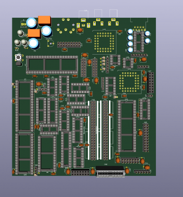

Posted: Mon Feb 11, 2019 1:01 am
by backspace119
So I've got another picture for you guys of the newest layout, it's getting denser, although there's still space to use on it
Posted: Mon Feb 11, 2019 1:26 am
by Dr Jefyll
Much tighter! In fact, you might wanna relax the spacing slightly in one or two spots. If you ever have to remove a chip from its socket, it helps if there's a couple of mm clearance at the end of the chip -- that's where you're gonna wanna slip the extractor tool in.
BTW, would there be any benefit in rotating these three chips 90 degrees? And: will that lowest chip collide with any part of the RAM module when it's installed?
What I was thinking of doing, since I've been wanting to do this for a while anyway, is getting some solder paste [...] I could use my hot air kit to melt the solder paste, rather than making up a reflow oven.
This strikes me as an excessive amount of effort for mounting just 1 or 2 SMD parts. Perhaps you suppose that soldering those parts by hand would also be a great deal of effort, but that's not been my experience.
I think when the need arises to solder SMD parts by hand arises, that's a very good time to learn how. :) Ditto when the need arises to use paste and a gun, or a reflow oven. But that need hasn't yet arisen, IMO.
cheers
Posted: Mon Feb 11, 2019 1:52 am
by backspace119
I actually noticed that after posting, and moved the ram modules over to the right a bit, so hopefully no issues now :)

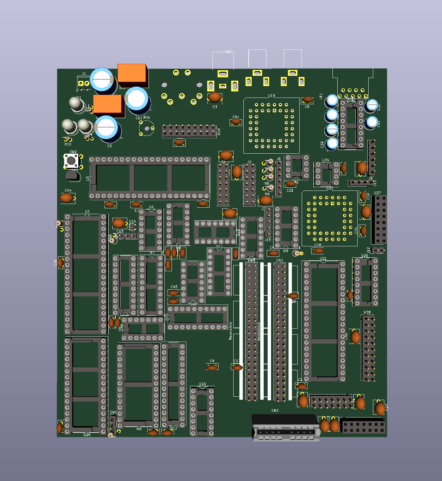

Posted: Mon Feb 11, 2019 2:27 am
by backspace119
Ok, after some more revising, here it is, actually a bit of open space now, may be able to capitalize on this and reduce board size further:
