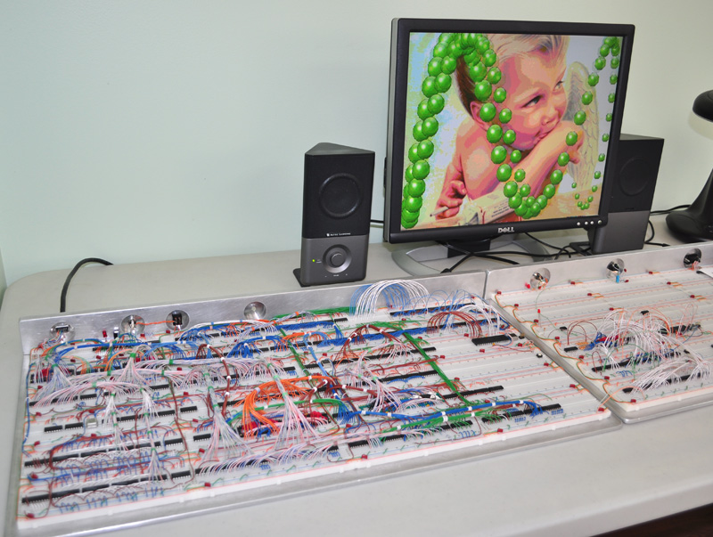

Greets 8 Bit Freaks!
Climate Change has been good to us out here in the remote Northern Hills of Gillies Ontario, so my time has been spent outdoors working on projects like a Chicken Coop, Gardening Shed, Yard Robot, etc.
When things freeze over again, I will give Vulcan-74 some more attention, as it is so close to having sound now...
Vulcan-74 Awaits the next batch of wires!
https://youtu.be/fuJz3ERi8Kg

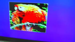

In order to keep my mind sharp (or crazy), I took on of my more "portable" projects and took it to the next level.
Imagine a Processor with 512 Bytes of RAM Bit-Banging 170x240 VGA with 8 Colors!...
https://www.youtube.com/watch?v=rmx-2fTxsns
One day I will do this same thing directly from a 6502, just to see how far it can be pushed.
Anyhow, I am itching to get back to my Vulcan project, and can't imagine it will be +5 out here for much longer!
Typically, -20 to -40 would be the normal hell around here.

With just a ATiny, this is awesome...
So VGA from a 6502 is your next challenge ?
Is that even possible ?

You can do VGA on fairly slow CPUs, it's just that the resolution will be very low and the timing somewhat out of spec.
Oh yes, you can do it!
Resolution is only limited to how fast you can count address to whatever display RAM being used.
AVR can do "INC, OUT" over and over, so CLK/2 is possible. At 25MHz, 320x480 VGA is easy.
None of my VGA drivers are out of spec... not even a single cycle out!
I follow the VGA standard to the exact cycle every time.
Dividing the horizontal line does not throw out timing, it just reduces resolution.
For instance, putting out 213x480 or 213x240 over the 640x480 60Hz standard, you can do...
HPX : 640 / 3 = 213 Pixels per line
HFP : 16
HSP : 96
HBP : 48
Total cycles per line = 800
This conforms to the standard EXACTLY.
Since I count every cycle, and de-jitter my interrupts, not a single cycle is unaccounted for.
You could however, deviate from the standards quite a bit and still get an image on most monitors.
I chose to follow the standard precisely, as it makes it more challenging.
Brad
