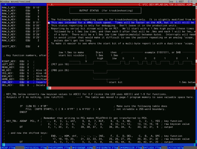

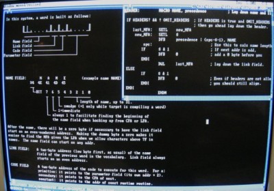

The visual appearance of text windows can be created on the C64 using reverse video. Ctrl-R on the C64 selects reverse video and Ctrl-0 ( control zero) selects normal video.
Here is were I selected a black background and white text and played around on the screen by selecting and deselecting reverse video. I typed the text with spaces to achieve the look of windows.
I normally use reverse video on the C64 to highlight important information.
Fleet Forth has the words RON to switch reverse video on and ROFF to switch to normal video. A carriage return also switches reverse video off.
