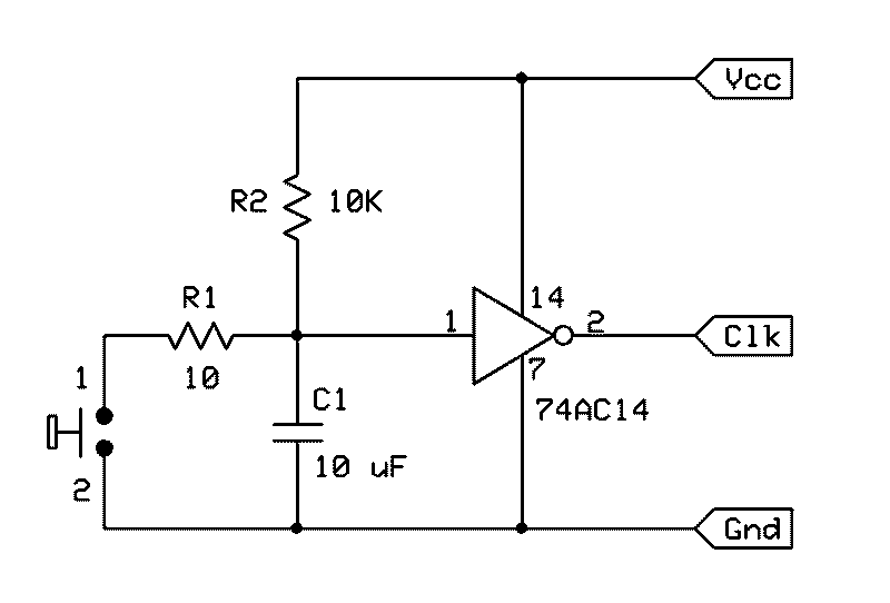

I shipped POC V2 back to Garth so he could change out the Ø2 clock flip-flop from a 74ABT74 to a 74AC74. The 'ABT74 could not drive Ø2 all the way to Vcc and use of a pull-up resistor to force the signal up to Vcc causes the clock waveform to become somewhat trapezoidal. With the 'AC74, Ø2 now cycles between zero and 5 volts, as it should, and a nice square wave is present. So Ø2 maladies are out of the picture.
Also, I had an issue with my Ø2 single-stepper occasionally double-clocking, which I believe was being caused by a trivial switching glitch generated by the DS1813 I'm using to debounce the pushbutton. That glitch wouldn't be of any matter with a reset circuit but was definitely not to the clock flop's liking. So I ended up redesigning the gadget to use a Schmitt trigger inverter, using the following schematic:
Clock Stepper Circuit
After initial use of the device, I increased R2 to 22K to slow down the device to compensate for my spastic hands. :shock:
