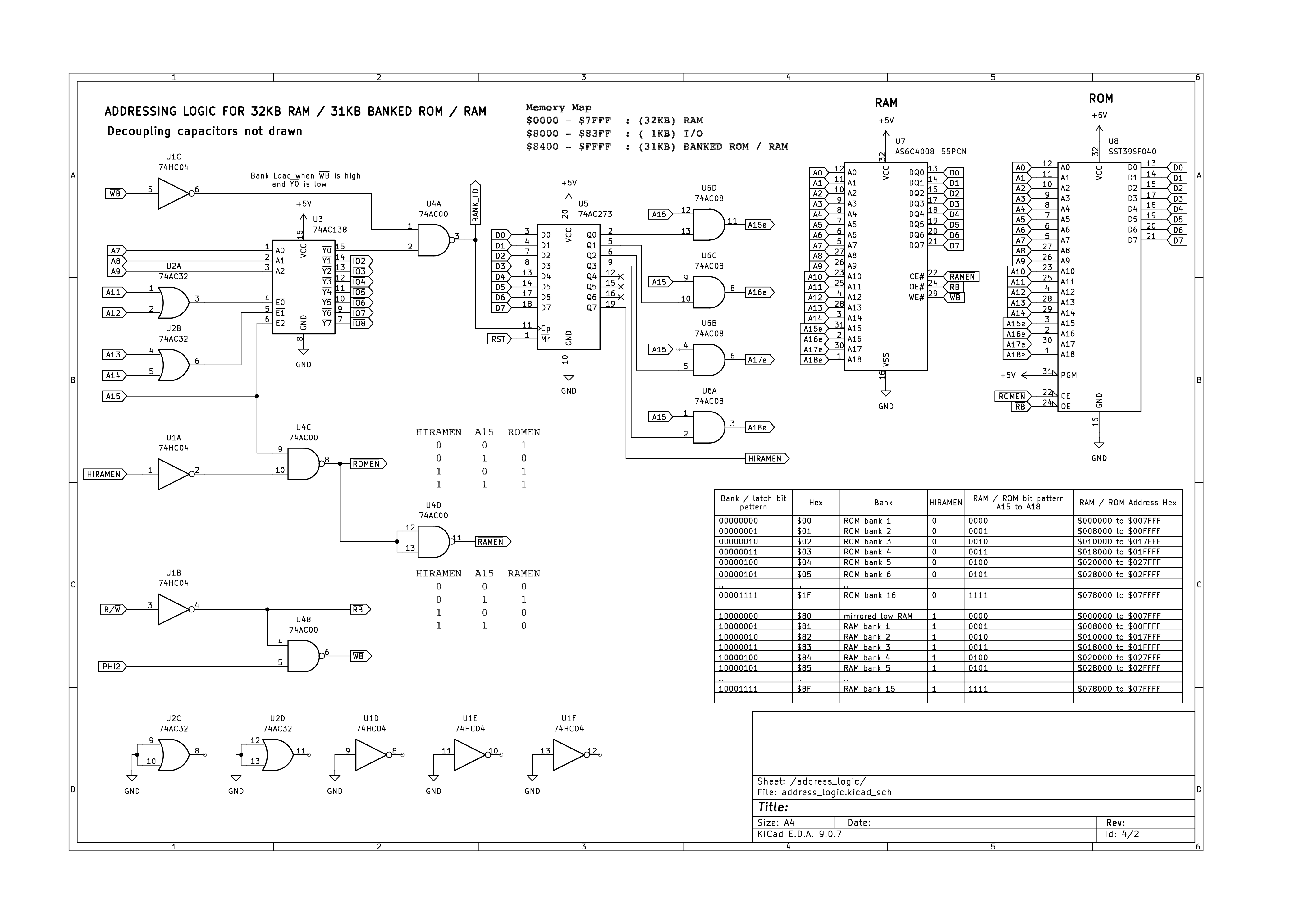

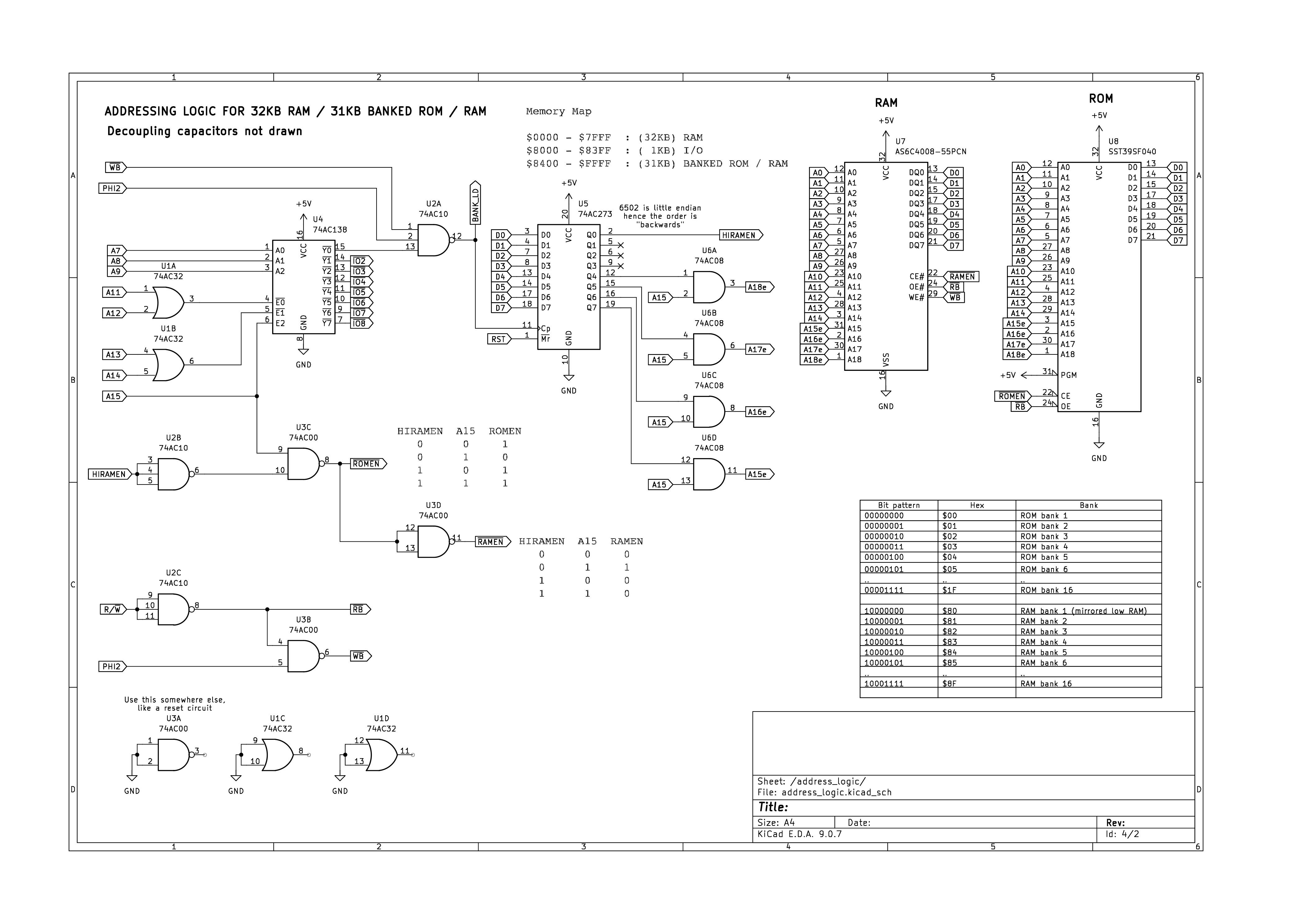

nrrd wrote:
I was thinking about this and it occurred to me that the 6502 is little endian...
Not sure what endianess has to do with the banking scheme.  The U5 bank register only handles a byte.

That’s not how I am interpreting it.
Your bank register is mapping 64K segments because each possible combination of bits 0-3 affects a RAM or ROM address line that is A15 or higher.  Here’s how I see those bits setting the upper memory address range (I’m ignoring the I/O block for discussion’s sake):

Also, as you have it wired, if bit 7 of the pattern written to the register is cleared, ROM will be selected.  With bit 7 set, RAM will be selected.

I think I just need to reorder the output from the latch to do this.
See my above table.  What you want is not possible as you have it wired.
Speaking of U5, I think you have a booby-trap waiting for you in how you are accessing it...
I was thinking about this when I couldn't sleep at 5:30 this morning. I can just qualify it with the write line, but I have to make sure I haven't changed the phase of the clock.
You need to invert the /WB signal and use that to clock the bank register.

Thanks for your reply again.
I was getting myself confused. What I meant was whether D0 or D7 was the least significant bit. I've gone back to the datasheet and confirmed that D0 is the LSB. Now that I have sorted that out, I realised I was correct with my first drawing.
No, sorry, A15 selects the lower 32K when 0, and the upper 32K when 1, so by switching A15 to activate the banking scheme, I am mapping 32K segments.
Your table is almost correct. I think there may be copy-paste errors.

I wrote a quick Python program to confirm this.
This is as desired. When the latch is reset, for example at boot, then the ROM will be selected. This allows the 6502 to read the starting PC from the ROM at 0xFFFC and 0xFFFD.
Thanks, I've incorporated that into the latest schematic.
