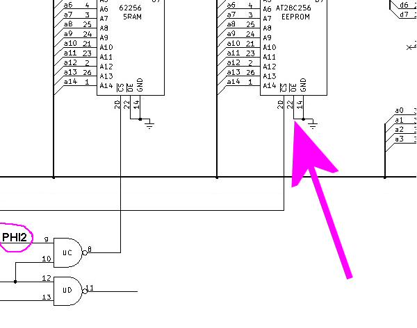

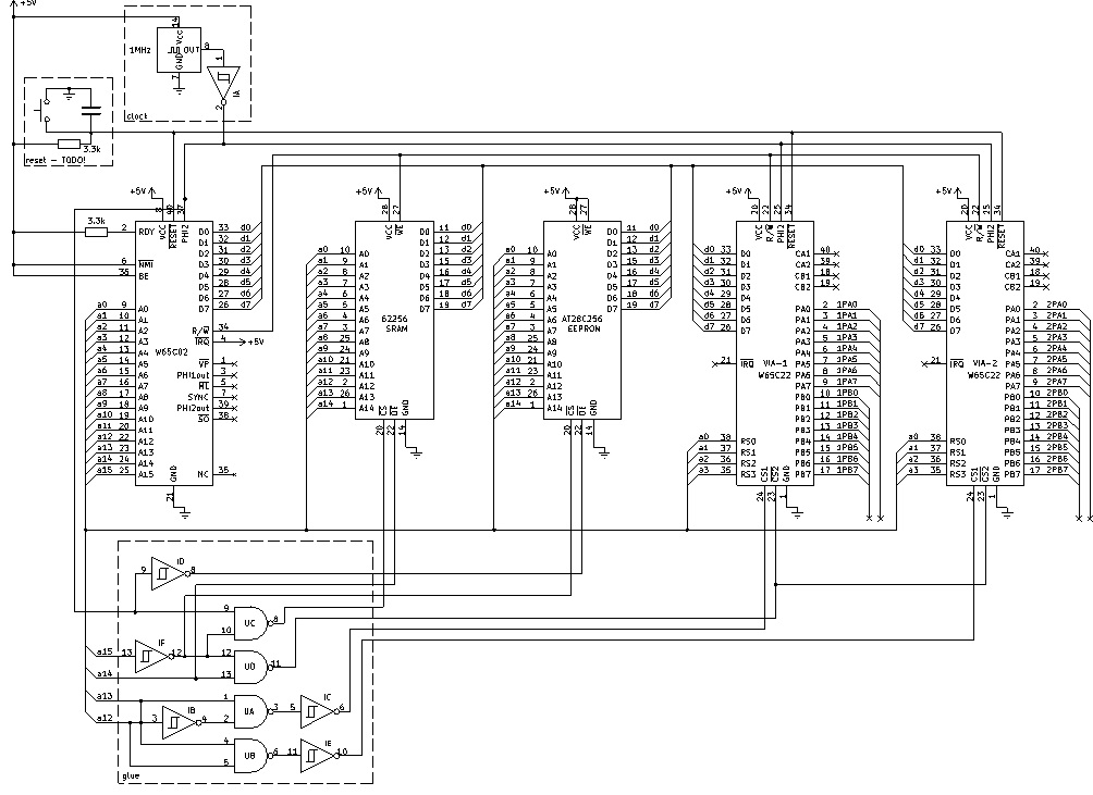

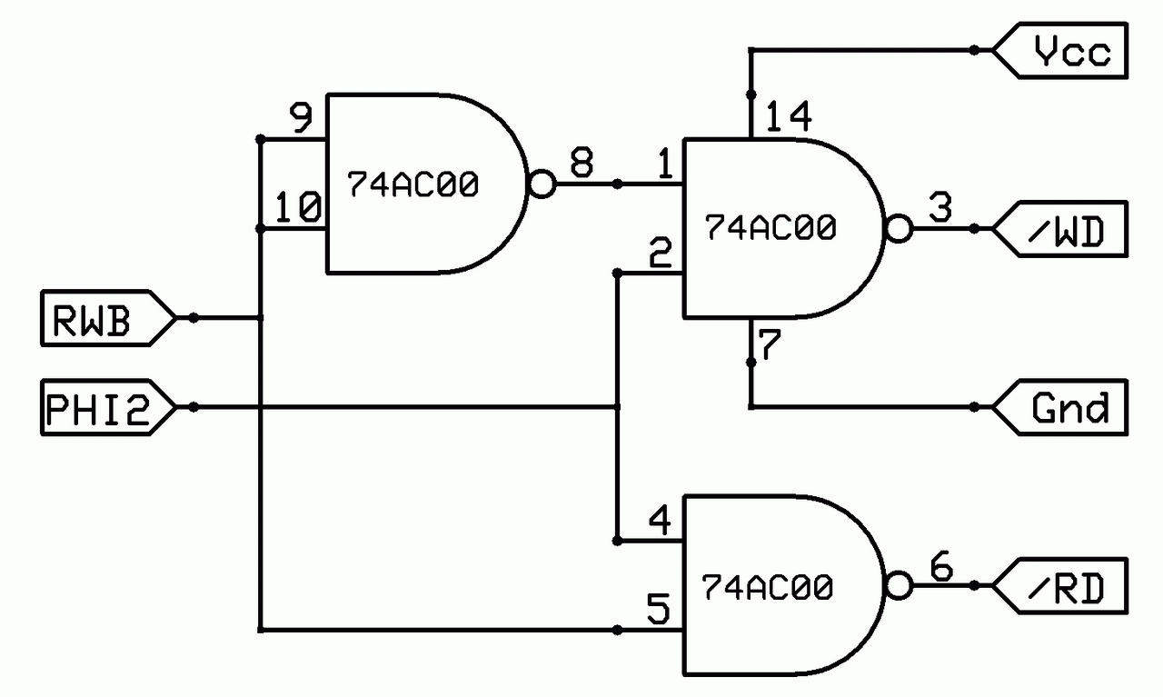

... I'd suggest that you not ground the /OE on the EEPROM. Instead, I'd drive /OE with an inverted version of PHI2 (which you could obtain by using an additional inverter section, or -- less preferably -- simply getting it directly from the oscillator).
It's because ideally we want all devices which can drive the data bus to refrain from doing so in the first half of every cycle when PHI2 is low. The resulting dead period acts as a timing cushion, guaranteeing a graceful and glitch-free handover as various devices successively take control of the bus. (And the bus wouldn't transfer any useful data in the first half-cycle anyway. :) ) Refraining from driving the bus when PHI2 is low is a policy which the CPU itself -- and all 65xx peripherals, including your VIAs -- observe. It's desirable, though not crucial, that your EEPROM do the same.
for Schmitt-triggered inverters [...] It’s not uncommon for the input voltage at which the output switches from low to high to be substantially different than when the output switches from high to low.
Right. That substantial difference between the high-going and low-going trigger points is known as hysteresis, and it's a defining feature. Gates whose high-going and low-going trigger points are virtually identical aren't Schmitt triggers (although it's possible they may approach a Schmitt's all-or-nothing "snap action").
Right. That substantial difference between the high-going and low-going trigger points is known as hysteresis...
I did say that in my post.  :D
If you carefully read the data sheet, you will see that input hysteresis for Schmitt-triggered inverters can be all over the map.
That is something I have been “harping” about for eons.  Aside from the potential for data bus contention that a continuously-grounded /OE can bring about, devices that have separate /CS and /OE control inputs typically exhibit better timing characteristics if /OE is used to gate the device’s output.  This information is often buried in one of the timing diagrams in the data sheet.  A similar situation exists for many devices that are writable, e.g., an SRAM.
The best way to handle non-65xx peripheral silicon is arranging for the glue logic to assert /CS as soon as a valid address is present, and qualify /OE and /WE with Ø2 so neither of those signals can go low while Ø2 is low.  Doing so maximizes the time the addressed device has to get ready for access and in the case of a write cycle, prevents a wild write during the time when the address bus is changing following the fall of the clock.
Read/Write Qualified by Ø2
Note that the above circuit is not applicable to 65xx devices, which “understand” the 6502 bus cycle.  For them, chip select and read/write must never be qualified by Ø2.

Sorry if my emphasis wasn't clear. Yes, we agree it's known as hysteresis. My small-ish quibble regards your remark that, "It’s not uncommon" [etc]. This misses the mark somewhat, as it's true in all cases that a Schmitt-trigger gate's positive-going and negative-going thresholds will be substantially different. That's the defining feature of a Schmitt trigger gate.

Thank you for keeping to chime in! I had one more inverter gate available in my glue setup, so that was an easy change. I have updated the breadboard and the schematic. On my board, the clock, reset setup (still to update) and glue are fairly self-contained, so I can easily change these out for a different setup. At some point, I want to add a PIC, a CPLD and/or an ATmega to poke around with (mostly to see what they can do), maybe have one of these handle the glue glue tasks to "clean up" the hardware (or completely mess it up, but it will be easy to revert to this working setup).
No doubt I will run into issues there (no worries, I do plan on tackling all of that myself), but for met that is the challenge and fun of all this.

Looking at the schematic above, it occurred to me there is some ambiguity in naming the clock in- and outputs of a 65(C)02.
All data sheets I have (except WDC) use: Φ0 for clock input, Φ1 for inverted clock output and Φ2 for non-inverted clock output.
This razed some questions for me: what is the difference between those, is the Φ2 from a WDC the same as a Φ0 from all the other 65's, and what about the clock outputs, are they different as well❓
In the original Atom the Φ2 (input) from the 65(C)22 gets it's signal (via two inverters) from the µP's Φ2 (output). In the schematic above the two 65(C)22 get theirs from the same clock line that supplies the µP (Φ0).
What's going on (t)here, is this ambiguity discussed earlier in this thread, or elsewhere in this forum, and if so, could someone please point out (link) where❓

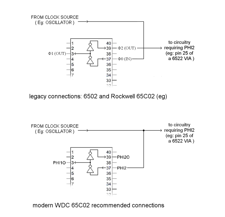

I suppose it comes from the fact that WDC recommends that the Φ2 input to the processor be the same signal as to the Φ2 input to the rest of the system, and that Φ2in is roughly in phase with Φ2out except that there's a little offset from internal gate delays.
WDC’s naming of those signals is the convention, since WDC was the entity that developed the 65C02.  Rockwell, Synertek et al were licensees.
Ø0 on other 6502 data sheets corresponds to PHI2 on the WDC data sheet.
As Garth noted, WDC recommends you use the master clock source to drive the MPU and 65xx devices that must be clocked, e.g., 65C21, 65C22, etc..  The 65C02’s internal timing is referenced to Ø2 in (pin 37 on the DIP).  They further recommend you do not use Ø1 out and Ø2 out in new designs.  The lag between Ø2 and the clock output signals is no longer specified, nor is it tested during production.  Furthermore, there is no guarantee that Ø1 out and Ø2 out are exactly 180 degrees out of phase.
This information is in the data sheet in section 3.8 on page 10, and as a footnote on page 26.
As far as I know MOS Technology was founded in 1969, later in 1978 WDC was founded (by a former MOS Technology employee), so it seems more likely to me than that WDC did not set, but changed the standard.
Compared to NMOS 6502s which predated WDC, yes, L0uis.m, it's true that the manufacturer's terminology in reference to the clock pins did change (and also the recommendation of what to do with those pins).
Understanding the recommended connection is moderately important. (But I don't see much point in debating whether one pin naming convention or the other should be considered "correct" or "standard." Certainly WDC's convention is standard for WDC, but I wouldn't bother pursuing the point any further.)
I do kinda understand why WDC made the naming change, though.
For technical reasons, they'd decided that having their CPU be the middleman, and thus the source of Phi2 for other devices in the system, was not the best arrangement. Instead they suggested that it'd be better if all devices in the system -- including the CPU -- should simply accept Phi2 as an input.
And I can see potential for confusion if the name of pin 37 were not changed. Some folks would find it strange that the signal driving their VIA's Phi2 input would also connect to CPU pin 37... whose name cites Phi0. :shock: I suspect that's why WDC renamed pin 37 as PHI2. (They also stopped using the Φ character in all three of the pin names, substituting PHI instead.)
It's important to be clear that the pin functions didn't change. Pin 37 is always an input, and pin 39 and pin 3 are always outputs, although the latter two won't necessarily get used (at least not externally -- but the internal signals fed to pin 39 and pin 3 do get used internally by the CPU).
Finally, it's perhaps a simplification for me to have drawn inverters to represent the internal circuitry, as there may be some degree of pulse shaping going on as well. But inverters do accurately give the general idea.
True that.  As long as one understands which pin gets connected to what, one can call them anything one likes.
I suspect, but don’t know for sure, that their recommendation has to do with the much higher speeds at which modern 65C02 incarnations can be run.  Perhaps the skew between Ø2 in and the two outputs was a concern as the clock was ramped up.  Or maybe their production people are just lazy and don’t feel like testing those outputs.  :roll:

To L0uis.m, there’s some history about why those clock outputs exist.
Back in the early days of the 6502, the clock signal was often generated by use of a crystal hooked up with some inverters and capacitors, like this (illustration from Garth’s website).  The resulting signal didn’t have a lot of oomph, especially since the inverters would have been early incarnations of 74LS logic, or even earlier, e.g., 7404 or 74S04.  Too much loading could weaken the signal to where oscillation would falter.  The Ø1 out and Ø2 out signals were provided to avoid the loading that would be present from clocking other 65xx hardware, and possibly bus drivers and/or transceivers.  The latter parts were in common use at the time to deal with the limited fan-out of the 6502’s buses and the loading imposed by 74LS inputs.
