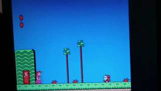

Super Mario Bros 2 is working :)
Apparently this MMC3 mapper has an IRQ timer which I haven't yet figured out right. Super Mario Bros 3 'works' but the HUD is all wrong because the IRQ isn't firing. Kirby's Adventure has a similar problem. Mario 3 also has a sprite priority issue, and it is very slow compared to other games which makes me wonder if I'm doing something wrong elsewhere.
I've been getting that "general exception" error more after including this new MMC3 code. So I changed a short array to individual variables, and it seems to work a little better. I also changed some fixed arrays to 'volatile' and so far seems even more stable. Still figuring out this thing out!
Overall progress is being made, and that's neat, but still far to go :) Thanks everyone!
Chad

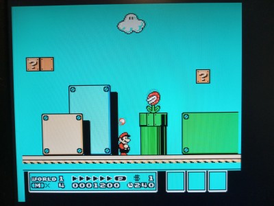

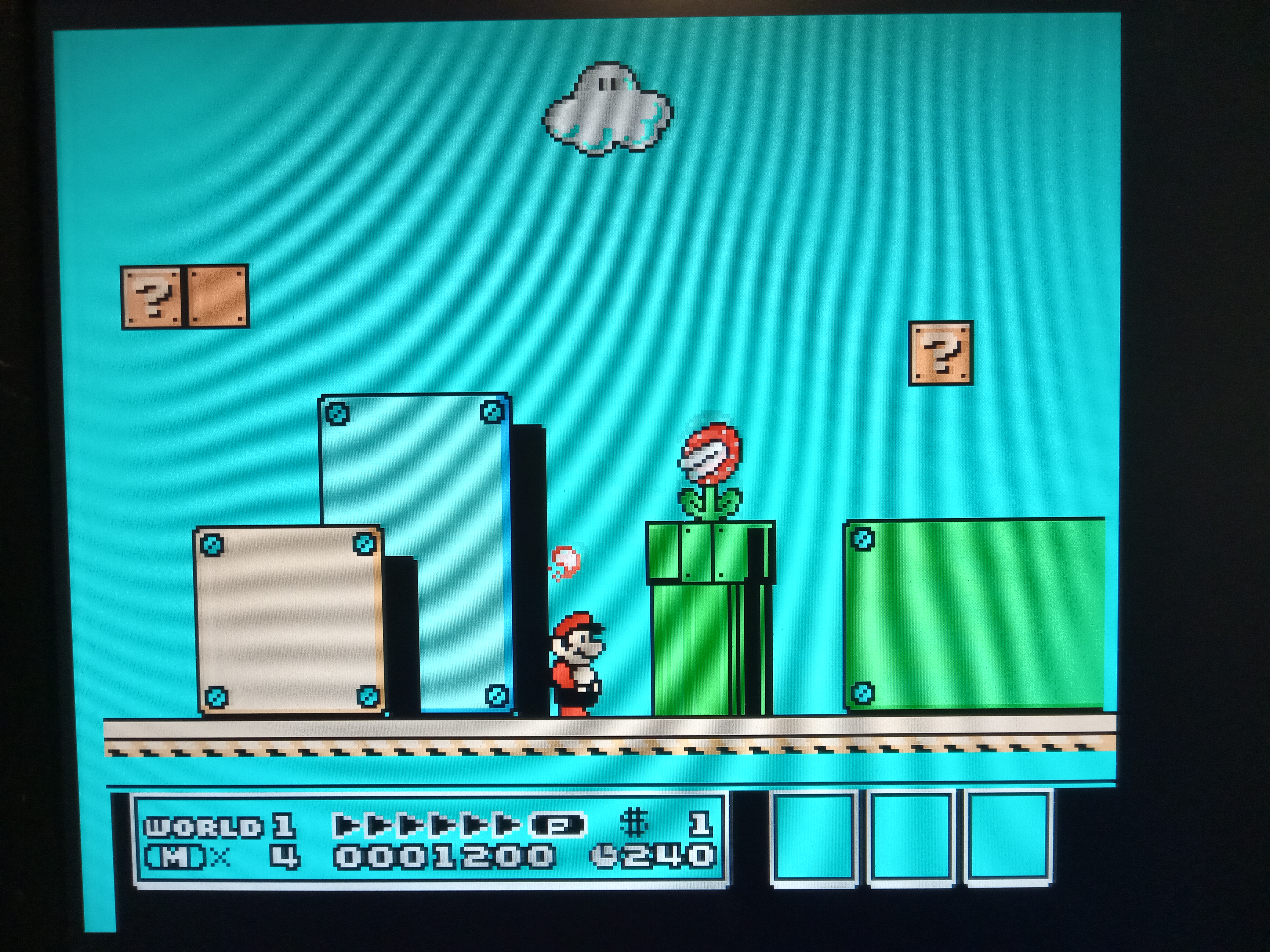

I'm nearing the end. Here is a summary:
Attached is a picture from Mario 3. But can you see the glitches? Sure, the bottom blue bar is one thing, but the piranha plant's pipe? There are 'plates' on top of it. Those are actually background sprites that cover the foreground sprites. They shouldn't be seen because they are in the background, but they should cover the foreground sprite none-the-less because of sprite priority. Something else the picture isn't telling you is that the bottom status bar is typically scrolling with the normal view area, meaning you can only see it when Mario is the ground essentially. Lastly, this game is running much slower than the others. It's actually noticeably slower, which is not ideal.
This is my limit. The microcontroller can barely keep up, and I'm now HACKING the emulator for individual games like Mario 3. Kirby works pretty good with minimal hacks, but *many* other MMC3 games break down quickly because of this IRQ timer it has. For example, Ninja Gaiden 2 works very well without hacks until the first cutscene, and then it glitches if you don't hit 'continue' fast enough. Then the second level is supposed to have some cool parallax scrolling but ends up totally unplayable.
All of this is happening because I actually didn't program a proper PPU. Not that I could have on this microcontroller! So, I'm working with what I have, and it has essentially run up against a brick wall.
Last thing, I also hacked the audio to work pretty well finally. Instead of trying to make it perfect, I played into it's issues! I was trying to coordinate the read/write positions, perfect my timing, etc, but none of that worked for long or consistently. Now I just drastically decreased the audio buffer to 256 bytes and let it do whatever it wants, and boy it sounds SO much better! It's not great, for sure, but it works and doesn't have weird humming/buzzing/echoes.
So, a lot of hacks. My next goal will be save-states and a better selection menu, so not directly emulator related. My plan is to have this work 'well' for a very selective list of games, but somehow have it possible for another user to attempt another game of their choice. After that, I really want to re-work the board to make it fully portable with an LCD screen and all that. :) One step at a time.
Thanks everyone. Hope this journey has helped someone.
Chad
