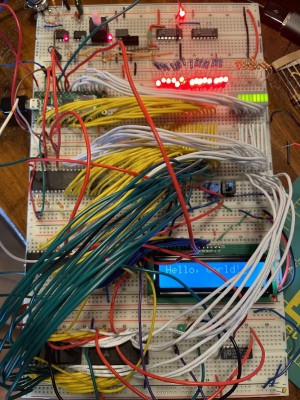

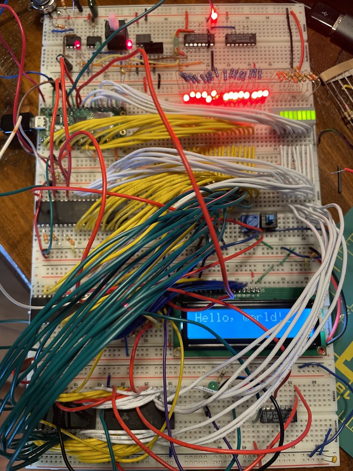

I think this is a very valid concern but I seem to have done a poor job of explaining the approach I'd prefer to follow and why Garth's primer is not a good match for my approach. That doesn't mean it isn't an excellent resource or that I won't use it or try to understand sections of it; but it's unlikely to be my guide as I explore learning about the area.
So I'll try to do a better job of explaining how I prefer to learn things: it's fun to build things in tiny, tiny steps. Each time some baby step doesn't work it may require learning a thing all the way to the bottom, to understand it fully: but not every single thing needs to be learned up front.
Let me try with some examples: I'll start with yours, the need for decoupling capacitors. It's easy enough to discover that using three sizes of decoupling capacitors was standard practice at one time for each DIP and just start throwing on three capacitors at every chip - but this seems like a lot of work to do a thing one doesn't understand. If you build some simple circuits and put an oscilloscope on the pins to see what's going on and measure the difference between having long power leads to the chip vs having a small decoupling capacitor near by, it doesn't take long to measure what a huge difference the decoupling capacitor makes - nor to conclude that a single decoupling capacitor is sufficient. It's much more satisfying to learn it properly.
Still, I was able to build a "working" 6502 computer on breadboards with decoupling capacitors only on the power rails and not one per chip, validating the overall plan of what I'm building without needing to know about or understand about decoupling capacitors before I got started. That, ultimately, is what for me can help sustain my interest and perseverance: the ability to make progress without knowing everything in advance.
When the primer has as a prerequisite knowledge of all the 74-series chips that feels like a steep hill to climb when my actual circuits only need a few logic gates, mainly NAND gates, and perhaps a buffer. Do I really need to know about counters, synchronous counters, BCD decoders, BCD to seven-segment display chips, flip flops, 4 bit adders, shift registers, timers, and 64-bit memories? It seems to me simpler to focus on maybe the basic logic gates and buffers that I might want at first and learn about things like schmitt triggers and shift registers when I need them in my circuit (if ever).
When I say I don't understand AC circuits, it's because I don't understand how electrical force moves through space; I realize that changes in electric potential (voltage) create or collapse magnetic fields, and that moving magnetic fields induce current in neighbouring wires, but not why having a ground plane is sufficient to tame this problem while a twisted pair apparently is not. Learning how this works will wait until I have had a chance to verify that my build does not work at a frequency I care about, which several who know much more than I have assured me is the case; but once faced with a non-working computer at 1Mhz that works perfectly fine at a few khz, I'll have to dig in and understand it.
To attempt to summarize: what will keep me engaged is learning step by step what I need to know to add things to my system. The smaller these steps are the less likely that I will encounter a dead end that can't be understood and debugged. I thought it was pretty good progress to have a debug monitor that will show me the bus activity and disassembly of the running assembly in a week's time, and still feel interested in getting a serial interface going and attaching a keyboard and monitor all of which can be done without scaling the rather steep hill of how electrical force travels through space rather than through wires.
To me, setting aside time to learn everything in advance of building anything doesn't seem at all the right way to stay motivated and get things learned; learning enough to build a 6502 that can run at 20 Mhz seems unnecessary when there is so much fun to be had even at a few kilohertz.

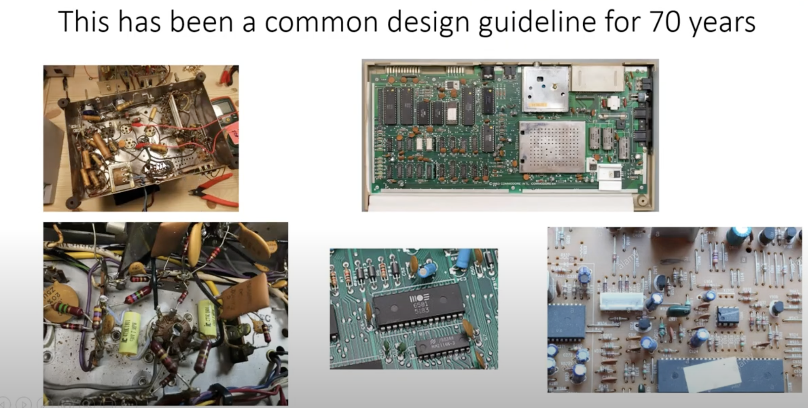

I'm not sure where that idea came from.  The old standard practice, which is not really appropriate anymore for modern SMT PCBs but is fine for home-made wired-up stuff with DIPs, is that you put a small monolithic capacitor at each IC, with the shortest possible connection between its power pin and its ground pin, and then perhaps just a few bigger ones around the board, and only one bulk 100µF for example right where the power comes into the board.  If you look at even this absolutely huge board which is mostly memory, from 1985, you'll see the little yellow monolithic ceramic capacitors at the end of each IC, and only two small electrolytics, way up in the upper-left corner.  That's all.
You might need to slow down a little to catch more of the important details.  We wish you success.

I’ve been following this topic since your first post and if I may be blunt, I think your approach, so far, is disorganized.
It’s easy enough to discover that using three sizes of decoupling capacitors was standard practice at one time for each DIP and just start throwing on three capacitors at every chip...
From which corner of the universe did you get that idea???

That idea comes from Eric Bogatin in this video https://www.youtube.com/watch?v=y4REmZlE7Jg and his example boards are at about 30m into the video at https://www.youtube.com/watch?v=y4REmZlE7Jg&t=1800s
The problem here may be that I said "for each DIP" as that's how it looked to me in his explanation but the underlying point remains that this topic can wait to be understood when it is encountered, rather than considered a prerequisite to start building things.
Eric Bogatin's examples of 3-capacitor boards.

It would not at all surprise me that this was true, as I'm generally a disorganized person. Yet in this case, I don't feel like my approach is so disorganized, and would welcome specific feedback on how to organize it (just as I've asked what you think an appropriate smaller scope next step would be, but not seen an answer). To recap, my approach is to build simple steps and test and understand each one in a modular way, with the intention of having circuits whose function I understand completely and a working artifact at each step. To that end, the sequence of steps I followed was:
1- build a debug monitor board out of an RP2040, using individual GPIOs to monitor Φ2, data bus, address bus, and RWB, with LEDs and pulldowns to show the state of the buses
2- add a static-core 6502 and respond to its reset sequence from the debug monitor to verify that I could single step to the reset vector load and run arbitrary assembled code in the processor
3- add a VIA and use it to control a small 2-line LCD display
4- add EEPROM and RAM to the system (I hesitated to add these together but since their pinouts were identical it didn't seem too big a risk to add two ICs at once)
5- build in-circuit programming of the EEPROM into the debug monitor, with the ability to dump and write sections of the EEPROM without removing it from the system
6- remove the debug monitor's ability to drive the bus in response to the CPU (I don't want the running system to rely on this module in the end)
7- post here about my lack of understanding of the datasheet's requirements for the BE/RDY pins because it wasn't clear to me whether I'd need or want to use RDY to implement the DMA I intend to use for the mono monitor display module
8- internalize and respond to your feedback about building a simpler next step rather than doing the monochrome display next
I hope I'm being open to feedback and would welcome an alternate plan that I could have followed or that I should proceed to follow to be more organized.

Not sure how a ground plane got into the discussion, but you should know that none of the home computers of the 1980s had ground planes and just about all of them were built on two-layer boards that were huge compared to what we can build now.  In fact, the smaller minis I worked on back then were mostly built on two-layer boards, which would also not have had a ground plane.  They all functioned and for the most part, were 100 percent stable.
Ground planes are literally in the fourth sentence of the primer’s section on AC performance problems: "Solderless breadboards make for the longest connecting wires of any method (meaning most inductance), have extra capacitance between neighboring tie points, and there’s no chance of getting anything even remotely resembling a ground plane."
When I read a sentence like that, I immediately wonder why twisted pair connections can’t serve the same purpose as a ground plane for using solderless breadboards to prototype 6502 systems. It shines a light on my lack of knowledge of how this works.
Here is where not knowing the theory can lead you astray.
Twisted pairs are used in a circuit that is balanced with respect to ground, i.e., a circuit that is differential, not single-ended.  In a differential circuit, there is no direct reference to ground.  Instead, each wire’s reference is to its mate.  Wires are twisted together in a uniform fashion so that external effects from noise sources affect both wires in the same way.  Since the circuit’s operation depends on the difference in voltage between the two wires, not between a wire and ground, noise cancels from the perspective of what is connected to the pair.
The classic example of a differential circuit is the subscriber loop that connects a telephone to a central office.  A more recent example is an Ethernet hookup using unshielded, twisted-pair (UTP) cable, such cable being essentially telephone cable, but with more closely-controlled characteristics.
Computer circuits of the type we build in our hobby systems are unbalanced with respect to ground, an arrangement that is called “single-ended.”  That is, each wire (if using a breadboard or a wire-wrapped assembly) is referenced to ground, not other wires.  Using a twisted pair in a single-ended circuit offers none of the advantages of differential signaling, but may insert unwanted parasitic capacitance that can result in an unstable or DOA system.
I’m not going to go into ground plane theory here—it’s not particularly simple to explain and 6502.org isn’t Wikipedia.  Also, plenty has been written about the subject by people much more knowledgeable than me, e.g., Dr. Howard Johnson.  I will merely say at the speeds many of us run our 6502 gadgets, lack of a ground plane is not usually a liability.  Breadboards, however, may inadvertently suffer from transmission line effects due to the long, curving wires often used.  Not understanding this phenomenon has caused more than a little grief to those who build on a breadboard.
As noted, not knowing the theory may lead to frustration when something doesn’t work and you don’t know enough to figure it out.  In most activities, learning by doing is often more than acceptable.  In electronics, especially high-speed digital electronics, learning by doing will not give you the theoretical grounding that is needed to understand things like the effects of twisted pairs or why a ground plane is a desirable feature in a computer.

I probably shouldn't have used the words "twisted pair" to describe the approach. In my case, I have created exactly the problem described - long curving wires for both the data bus and the address bus, in order to enable building the components of my system out of separable and hopefully rearrangeable breadboards, as pictured in the attachment.
Therefore, based on everyone's feedback, I am expecting that when I test this setup at 1Mhz it will fail. I haven't yet had the time to do it but it seems like a simple test where I fill the RAM with a pattern and then check for its existence then fill with a different pattern ad infinitum will likely show a problem if I run the computer at a high enough clock.
Once I do that and it fails, I'm left with the task of understanding why it fails. It seems that the reason why it fails (?) may be that the sharp rising edges on the long wires of the address and/or data bus may induce currents in the neighbouring wires and cause issues. Assuming that I want to make the breadboard build I have work at these speeds, I'll have to come up with some solution.
You've already told me that softening the edges isn't going to work but in fact will make the problem worse; I don't know why that is, but will have to learn.
Meanwhile, the twisted pair alternative presumably also won't work but the idea is not to twist each signal wire with an adjacent one, but to pair each address and data line with a ground line going to the same destination. If all the signals and grounds are connected chip-to-chip in adjacent runs, I had thought that this would solve the problem. This too apparently will not work - I would have said it "resembles a ground plane" - and again is something I'll need to understand _why_ it won't work.
