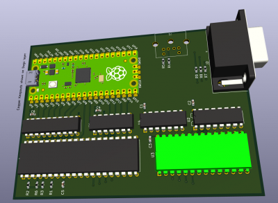

Theory...

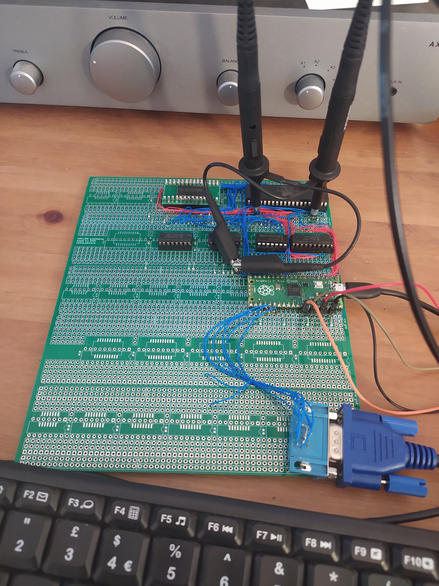

Practice:
But at least it does something: video comes out, keyboard goes in, and it _looks_ as if it's at least trying to do the initial program load. However, it's clearly not working properly though something is being executed; I need to slow things down and check the sequence at each point in the load.
And I still need to write the pio code to make the pico into a bus device...
