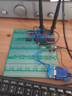

But at least it does something: video comes out, keyboard goes in, and it _looks_ as if it's at least trying to do the initial program load. However, it's clearly not working properly though something is being executed; I need to slow things down and check the sequence at each point in the load.
And I still need to write the pio code to make the pico into a bus device...

Cool setup. Is the PI going to take graphics commands from the 6502 or are you going with a memory mapped segment in that other 32k space?

The Pi will take graphic (and text) commands from the 65c02. [The plan is that] it will have just two memory addresses in the IO space; one which reads as a status byte and writes as a register select, and the other which reads and writes the selected register.
So as the basic operation, one writes the selector for (e.g. terminal function) and then read for busy, then write the terminal data; repeated writes require the busy read (or a delay; writing a character to the terminal, updating the cursor position and such, takes about eight microseconds) but not reselecting the function. So it looks much the same as writing to a serial port.

The Pi will provide an initial program load (when it works - I've got a spaghetti dish of logic analyzer wires on it at the moment) and the memory will cover all 64k except for a few IO areas in the top page. It can't see the memory directly but it _could_ jump through some hoops and read at least some of it. When it's loading, it's forcing a sequence of LDA #xx, STA yyyy instructions and only allowing the processor to drive the bus during that write phase. To read ram, it would have to do the same in reverse; I haven't thought that through though.
It's got enough speed with the timers and DMAs and the PIOs. Have a look for Hunter Adams for the basic code; I found some other code modifying it by San Tarcisio to reduce the resolution and increase the colour depth, but working on Arduino - but I've removed most of his modifications, installed a larger font, written an interface to read and decode ps/2, and so on. I can post my codebase - there's a lot of it and it's very messy at the moment as I play with stuff, but if you want to see it, I'll zip it up and post it.
