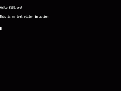

Attached is a simple demo (animated) GIF of what my text editor is looking like right now.
Pretty much all of the normal keys do what they should do. Return, Backspace, Tab, Delete, Arrow Keys, etc. I have not yet implemented Home, End, Page Up, or Page Down. The Pages will have to wait until I can get my screen scrolling vertically. I'm thinking of using Insert for the "Defrag" process.
You can see the delay between hitting Return and Backspace. Those two keys in particular refresh the entire screen. So, what's taking so long is not the moving of data, it's just retyping each character on the screen, including blank characters. I'm thinking of ways to optimize this, but I also need to consider the vertical scrolling I will need to implement as well.
Note that this is all in my Simulator, not on real hardware at the moment. Oh, and you don't want to see my code because there's zero comments and it's designed for my homemade '816 Assembler.
Thanks for all of the help everyone! Looking good!

So far so good... but now is the right time to consider how it might deal with larger texts!
Re: Text Editor Shifting Mechanics
Looks good to me, for general editing - plenty responsive enough! Of course, more responsiveness is always better, but there are diminishing returns beyond where you are now I think.
For the insert/delete line cases, you can probably make them quite a bit faster, at the extreme by using unrolled loops with absolute indexed addressing. And at least these won't get worse for longer documents, if most of the cost is moving data on the screen.
