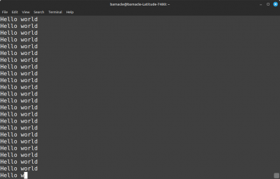

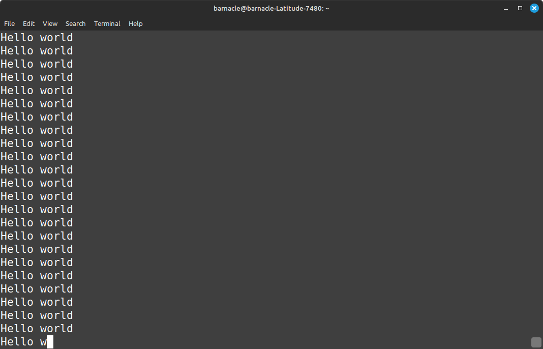

Yay! The world is temporarily the mollusc of my choice:
This simply includes a short string at the end of the minimal string output - it's about a millisecond and a quarter according to the scope. That's odd; I think it should be about half of that: five clock cycles times 542ns ought to be around 700us, and phase0is definitely 1.8432MHz. Strange.
The ACIA reset is temporarily removed but I think it should go back.
So anyway, more work to do but this proof of concept has shown that data can be transferred, that both of the ram chips are working, that the reset works as expected, and that serial data can be output.
Bearing in mind that this is a proof of concept, it's obviously got some issues:
edit: fixed the delay length - I intended to replace a subroutine delay with an inline delay in case the return was breaking somewhere, but managed to leave both in. The ACIA reset is restored now, too.

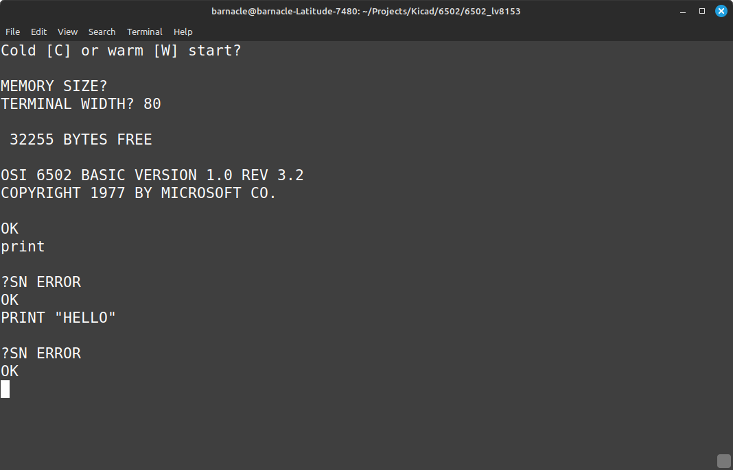

Re: Neolithic Romless
Grant's rom.hex listing is assembled to run at 0xc000 but built with an offset of 0x0000. After manually editing (cut'n'paste) the load addresses I run that through my loader conversion (which ignores the checksum bytes at the end of the line) and I can send that to the board.
I don't usually see the 'Cold or Warm start' message, but hitting C behaves as expected; a simple loop enters and runs correctly.
However, attempting to type '100PRINT"MANDELBROT...' locks up the board every time. So it looks as if there is an issue from the random writes (or maybe it just doesn't like Mandelbrot

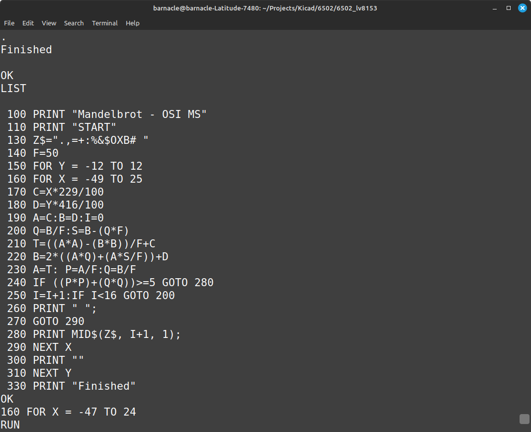

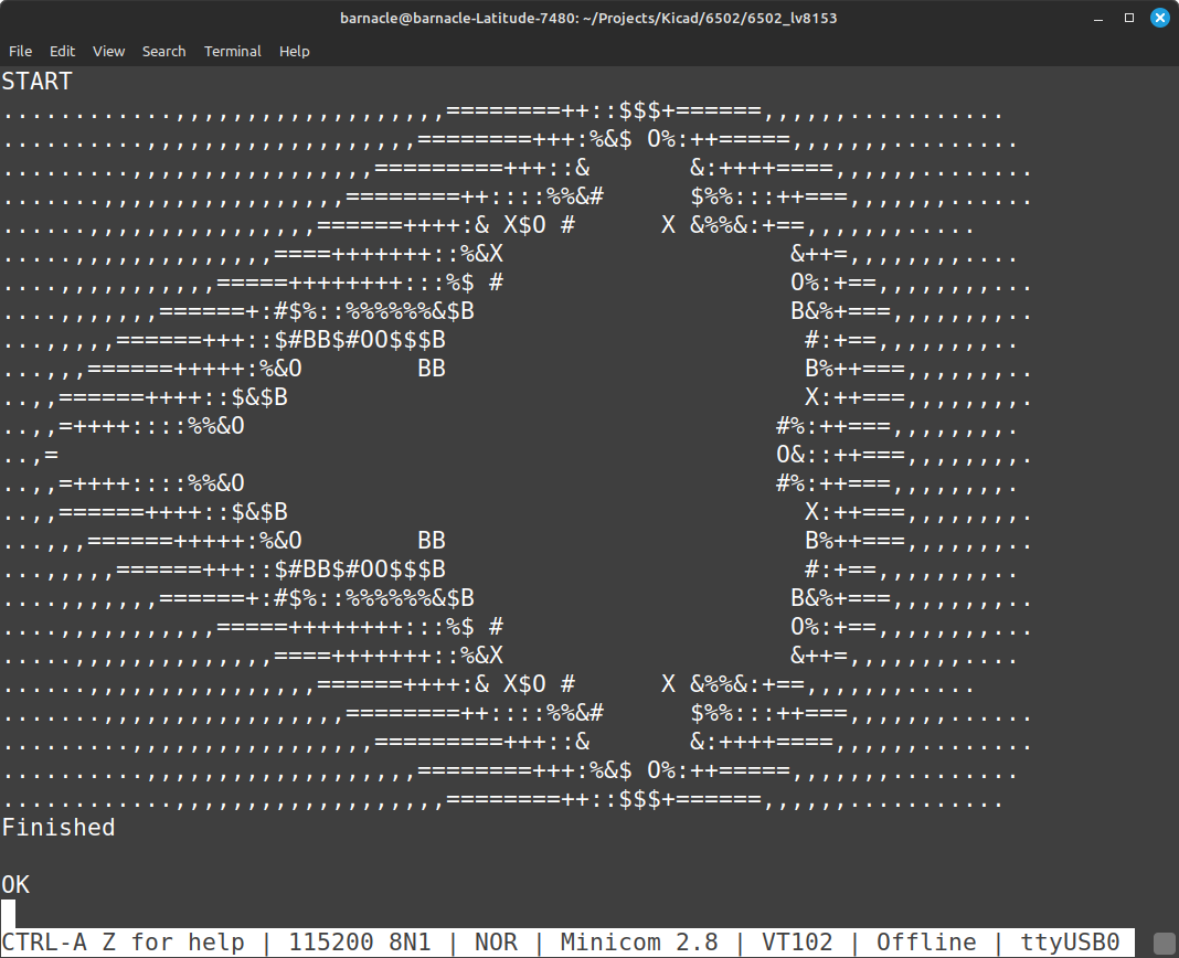

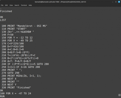

So, fixed (hopefully) the extra writes: an OR gate excludes writes from the 5813 when it's output is disabled.
Slightly modified to fit on the screen: And the result, some minutes later: Neil
