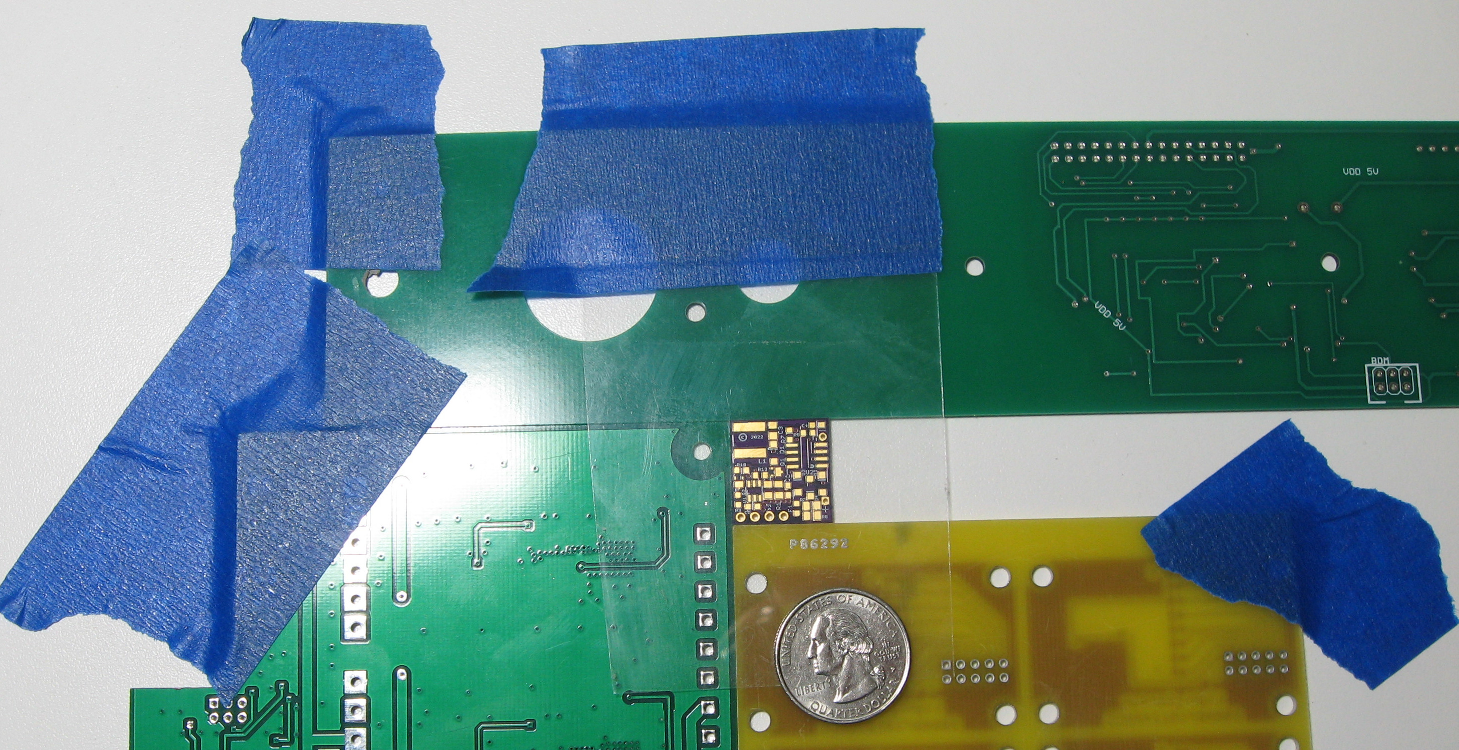

1) I got a thin steel stencil for the QFP-44 10x10mm part matching my Xilinx CPLD XC9572XL part. I also got "no clean" leaded solder paste with a melting point of around 360 degrees Fahrenheit. I put the solder paste in the refrigerator until I was ready to use it.
2) I taped the stencil down to the board with painters tape, made sure it would be easy to remove without shifting things.
3) I applied a tiny amount of paste on all of the stencil holes, then wiped it around with an old plastic card. I think I didn't apply enough, so I did more and made sure it was all filled in as much as it could hold. It didn't *look* filled in completely, but it was fine. Some paste got on the board itself, so I wiped it off with a paper towel. Also, the stencil had extra long pad holes, but my KiCad pads were shorter. So basically I had paste on the soldermask, but apparently that didn't matter in the end.
4) I removed the stencil by removing one side of the tape, then rotated the stencil up away from the board. It either shifted some or the paste melted a bit, because it looked like it was generally one big blob with indents, kind of.

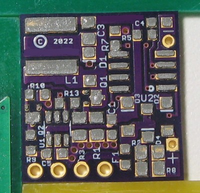

A little more practice Chad and you'll be doing things like this in your sleep... U2 is 2mm square, has eight concealed pins and a required ninth pad underneath. It was a stinker the first few times, but solder paste with flux and cautious hot air sorted it. It throws out half an amp at 3.3v from up to 17v input :mrgreen:

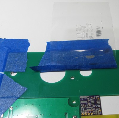

Excellent work. I'm glad it worked out so well for you. It does take more prep. time, but vastly makes up for it in doing all the solder joints at once.
Regarding the stencil apertures (openings) that are larger than your pads, that's called overprinting and it's a valid technique for getting more solder into a joint. It's often used for connectors to create a better mechanical connection. If it works well, the extra solder will be drawn towards the pad. If it doesn't work well, you end up with solderballs that aren't connected to anything. In your case, it's likely just a mismatch between the pad sizes KiCad uses and the stencil design. Longer pads on QFPs (Quad Flat Package) used to be more common, and they are much easier to hand solder, but now most manufacturers are recommending the minimum size for pads so you can cram more parts on a small board.
Watch out for solderballs - if they are loose, you should remove them from the board so they don't end up between pins and short things out. If they are trapped in no-clean flux residue, aren't going to move, and aren't shorting anything (electrical clearances are OK), then you can leave them. You can get them even when not overprinting, if some solderpaste ends up on the soldermask and not on a pad. Paste can be messy, so this is definitely something that happens.
It's fine to get stencils for just the hard ICs and stencil them individually, but the next level is to do all the passives as well and you'll need a stencil for your entire board. Depending on what you have available, your options include:
  • Buy a stencil (OSH Stencils has very reasonable prices - I recommend their 5-mil mylar stencils for the kinds of parts you are currently working with)
  • Cutting stencils in plastic (mylar - usually clear or orange, 0.003 to 0.006" thick) with a laser cutter
  • Cutting stencils in metal with a milling machine or router - I've used 0.005" brass shim stock from McMaster (their 8"x12" is a convenient size) with a V-bit
  • Cutting stencils by hand with an x-acto knife - can't recommend for QFPs (Quad Flat Pack) and the like, but I have done this for very simple boards with SOICs (Small Outline Intergrated Circuit) and larger.
Your plastic card is likely fine for use as a squeegee.
Your setup for holding your stencil sounds reasonable. If I'm making more than one board, I tape some scrap boards that are the same thickness as my board to the table so they tightly touch/hold my board on three sides. Make sure the tape is only on the outside of the scrap boards, so there is no "bump" under the stencil at the edges of your board. This provides flat support for the stencil if you have apertures near the edge of the board. The stencil is lined up with the board and a single long piece of tape at the top make a hinge of sorts. Always use the squeegee away from the hinge so the stencil doesn't move. Once your board is pasted, lift the stencil away from the board, replace the board, and the stencil should be aligned or very close to it for the next board. The open side is how you get boards in/out.

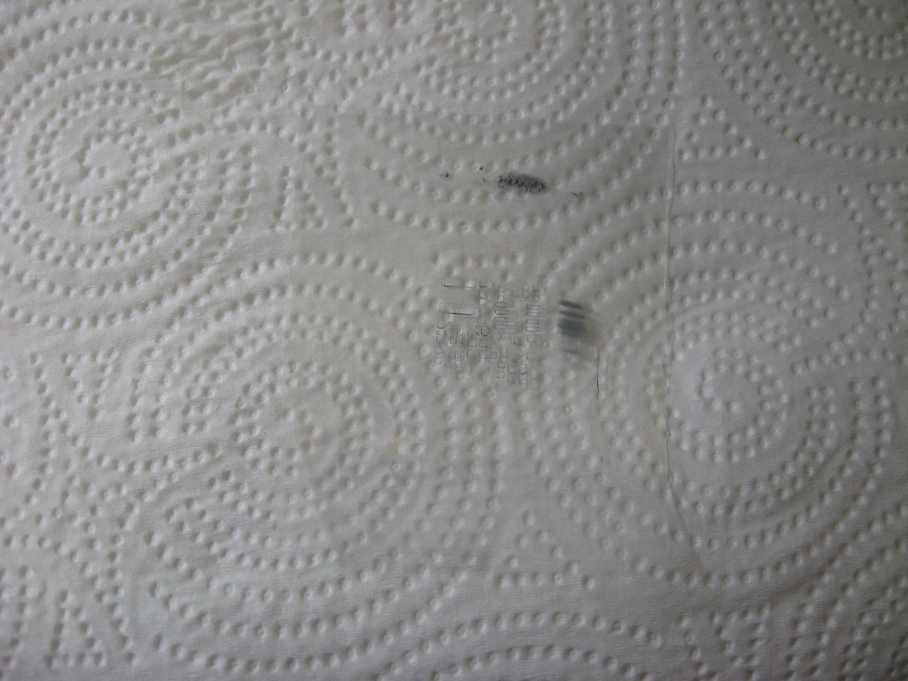

If you want to re-use your stencil later, make sure your clean it. I put down a paper towel and place the stencil on that. Then I use a dollar-store spray bottle with IPA (Isopropyl Alcohol - also available at my dollar store but get the 90% stuff, not the 70% stuff) and spray into the apertures and any paste residue, then wipe on top with another paper towel. Flip the stencil and repeat. Inspect to make sure there isn't any paste left in the apertures and repeat as necessary. If the paste has dried into the stencil (because you forgot to clean it right after you used it), a toothbrush (that you aren't ever going to put into a mouth again) works well with the IPA.

Stenciling Setup
Stenciling Setup
This is my setup. The little purple PCB is the one to be pasted. The scrap boards just need to be the same thickness - I keep them around for this kind of use. The stencil (clear 0.005" thick mylar cut on a laser cutter) is aligned. The long piece of tape at the top forms a hinge for the stencil. Because I have apertures (openings) right next to the edge of the board, I probably should have placed a second purple board to the right of the one I am pasting for squeegee support, but I didn't.

Stencil Cleanup
Stencil Cleanup
Stencil cleaning setup. I spray into the apertures and onto the residual solderpaste, then wipe with another paper towel.
Finished PCB
Finished PCB
Completed board (not the one that was just pasted, but it's the same circuit). This board was hand-placed with tweezers. This is lead-free solder (SAC305 alloy with no-clean flux), which has a grainy finish, so you have to look at the shape of the joints rather than if they are shiny or not. Inspection shows that I don't have enough solder in the barrel of the through hole in the top right, but this is a prototype so it will be fine. I also see a short between R7 and a leg of the neighboring IC, however those are connected together on the PCB as well, so it would be a waste of time to fix. There is also a solderball in the lower right corner at R8. It's trapped in the flux residue next to the pads, so it can be left where it is. This is no-clean flux, so the flux residues are not cleaned off the board. If the board was going to be cleaned, that solderball should be removed first so it doesn't end up being lodged between some pins somewhere else on the board.
This board has 5 components on the back side, which I simply hand soldered. I'll usually hand solder if I'm making 1 board with fewer than 40 solder points, and set up to paste if I am doing multiple boards or boards with lots of parts.
