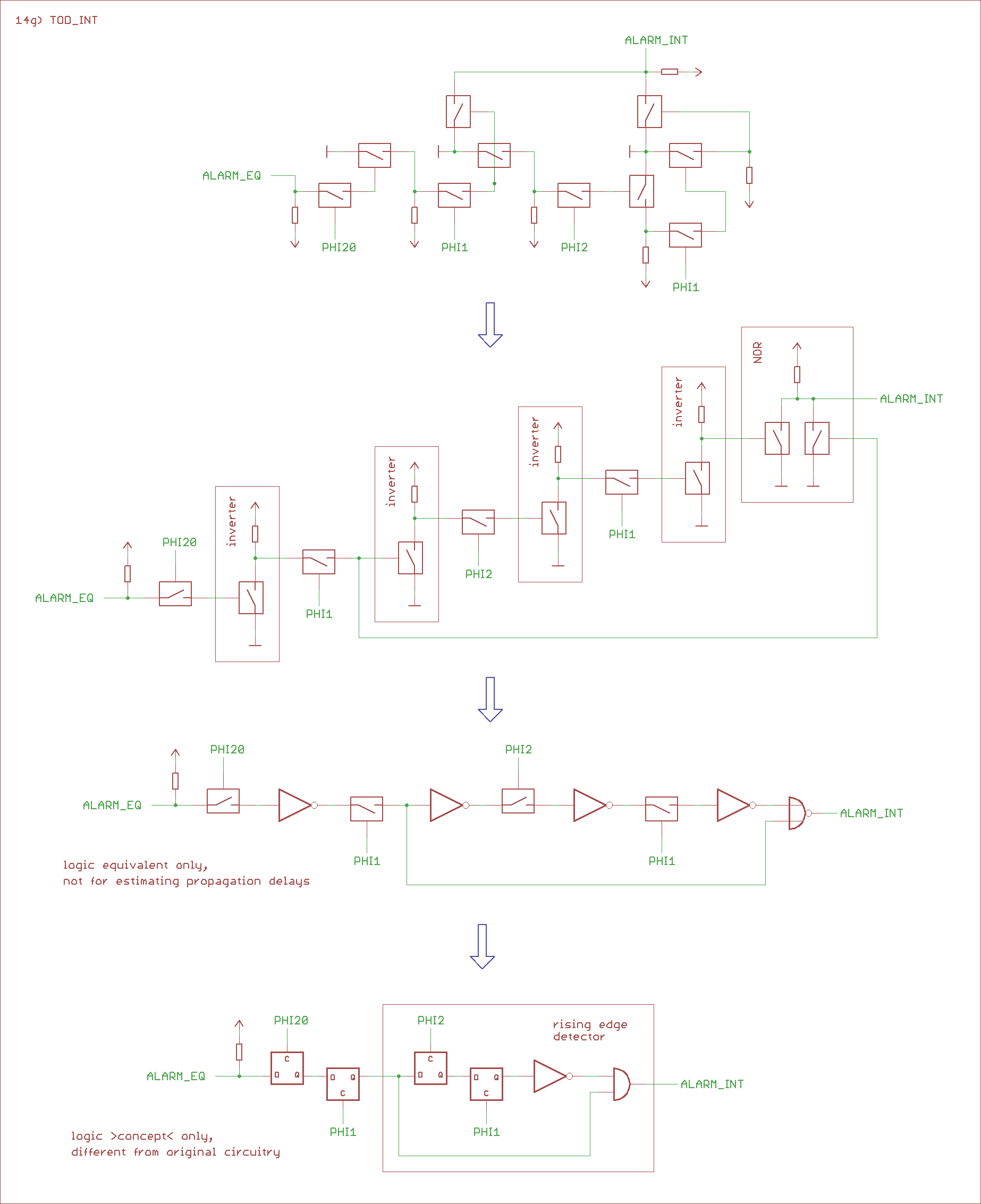

Comparator basically uses XOR gates for comparing TOD counter register contents
with ALARM register contents, then pulls ALARM_EQ low if they don't match.
ALARM_EQ is a 24 input NOR gate, and its output goes into
"14g) TOD INT", where an edge detector generates the TOD_INT signal
when detecting a rising edge on ALARM_EQ,
for setting the ALARM interrupt flag.

14g) TOD INT
Note: the TOD counter Bit cells operate with the PHI20 clock.
PHI20 is HIGH at PHI2, in every fourth PHI2 cycle.
Means that TOD is clocked with PHI2/4.
High_active signal ALARM_EQ is generated by a 24 input NOR gate,
which is distributed among all of the TOD comparator cells
(comparing the TOD counter Bits with the ALARM register Bits).
The pullup resistor (FET) of this NOR gate is integral part of 14g).
If the values in the TOD counter Bits match the values
in the ALARM register Bits, ALARM_EQ is HIGH.
ALARM_EQ is sampled by a transparent latch at PHI20,
then by another transparent latch at PHI1,
then goes into a rising edge detector.
When a rising edge is detected, high_active signal TOD_INT
goes active for one PHI2 cycle,
what sets the ALARM interrupt flag.
