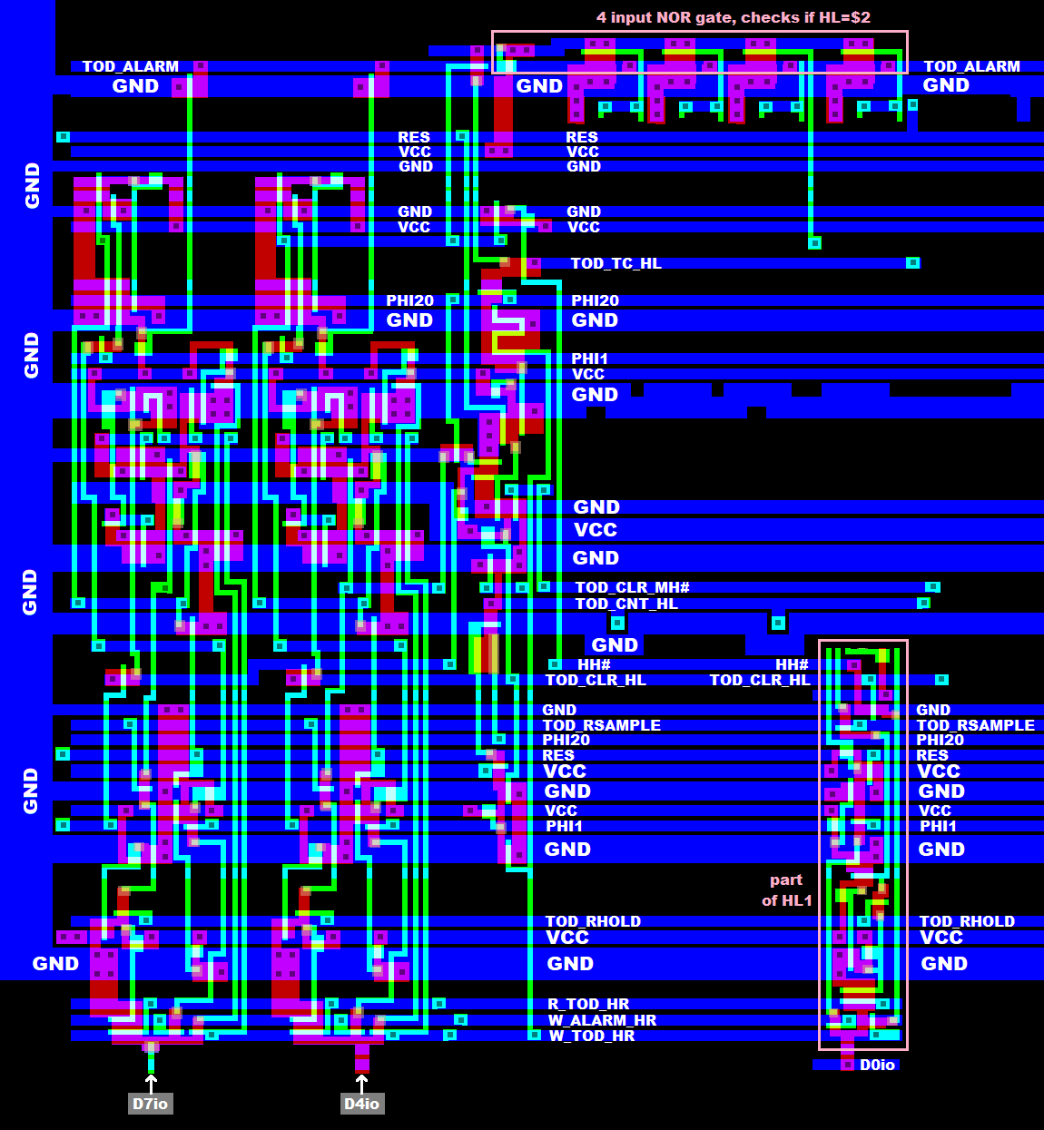

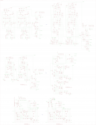

14a) TOD two cells
Now to peek into the TOD Bit cells, the two uppermost Bits.
Carry for a 4 Bit block of TOD counter cells ripples through
in inverted/non_inverted form from East to West.
Note: the TOD counter Bit cells operate with the PHI20 clock.
PHI20 is HIGH at PHI2, in every fourth PHI2 cycle.
Means that TOD is clocked with PHI2/4.
South to North, we have:
A transparent latch for reading the TOD counters from the CPU.
Data bus is 8 Bit, counter has more Bits than that,
counter still shold be counting while reading it,
so we can't get around having such latches.
In all TOD Bit cells, the high active control signal TOD_RSAMPLE
makes the latches sampling the values which are in the counters.
High_active control signal TOD_RHOLD makes the latches holding the data
(it also refreshes the contents of the half_static latches).
TOD_RSAMPLE and TOD_RHOLD are generated in "14b) TOD control logic".
High active register read control signals for the individual Bytes
of the read latches R_TOD_10THS, R_TOD_SEC, R_TOD_MIN, R_TOD_HR
are generated in "6) address decoder" (at PHI2).
Next, we have the ALARM register Bits creatively crammed in.
Again we have half_static transparent latches, refreshed at PHI1,
written with high_active register write control signals
W_ALARM_10THS, W_ALARM_SEC, W_ALARM_MIN, W_ALARM_HR which are generated in
Active RES clears all ALARM registers at PHI1.
ALARM registers use a similar concept like the CRA, CRB registers,
it's just that the transparent latches controlled by PHI1
in the outputs of the ALARM registers (for preventing spikes
when writing the register) are creatively crammed into
the comparator section.
Next, we have the TOD counter Bits.
Even Bits have low_active carry input, high_active carry output.
Odd Bits have high_active carry input, low_active carry output.
Carry input of a 4 Bit counter block changes with PHI20.
Count result is prepared at PHI1.
Counter outputs change when high_active clock signal TOD_CNT_10THS is active (changes at PHI20).
Note, that every 4 Bit block has its own TOD_CNT_* signal.
Counter Bits are cleared with high_active control signal TOD_CLR_10THS (changes at PHI20).
Note, that every 4 Bit block has its own TOD_CLR_* signal.
TOD_TC_10THS is a 5 input NOR gate which checks if the 4 Bit BCD counter
is in overflow condition ($9) while counting is enabled.
Note, that the HL (hour low) counter contains an additional NOR gate
which checks for $2, that's for the AM\PM flag.
We now have reached the North of the TOD Bit cell,
and that's where the comparator sits.
Comparator basically uses XOR gates for comparing TOD counter register contents
with ALARM register contents, then pulls ALARM_EQ low if they don't match.

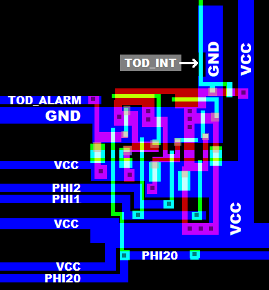

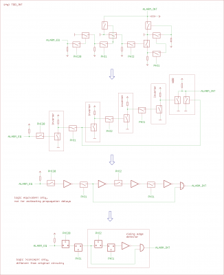

ALARM_EQ is a 24 input NOR gate, and its output goes into
"14g) TOD INT", where an edge detector generates the TOD_INT signal
when detecting a rising edge on ALARM_EQ,
for setting the ALARM interrupt flag.
However, please note that the HL1 Bit is different.
While all of the other BCD counter Bits are cleared, HL1 is loaded with HH#.
HH# is the low_active output of the HH Bit, MSB of the hour counter.
That's for making TOD jumping from 12:59:59 to 01:00:00,
and we are getting to this trick later in "14f) HH PM".

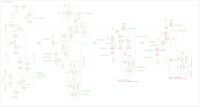

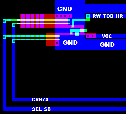

14c) is just a NAND gate with push/pull output,
sensing if the CPU wants to read/write TOD_HR.
So I had integrated it into 14b).

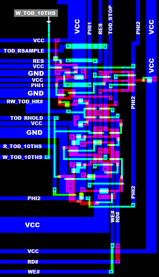

14b) TOD control
When TOD_10THS is written with high_active register write control signal W_TOD_10THS,
the "TOD count enable" RS flipflop is set at the start of the next PHI2 cycle,
what enables TOD counting with high_active signal TOD_STOP going LOW.
When the CPU writes TOD_HR, or when RES is active,
the "TOD count enable" RS flipflop (buit from two NOR gates) is cleared,
what disables TOD counting with high_active TOD_STOP signal going HIGH.
Note:
This means after RES was active, you would have to write TOD_10THS to enable TOD counting.
"Writing TOD_HR" means:
LOW_active write enable signal WE# is active, //generated in "2) CS#, R/W#"
High_active select signal SEL_$B is active, //generated in "6) address decoder"
CRB7 control register B Bit is 0.
TOD_STOP goes into the "5b) TOD predivider".
If TOD_STOP is HIGH, it stops/clears said predivider to disable TOD counting.
When the CPU reads TOD_HR, the "TOD read sample/hold" RS flipflop
(built from two NOR gates) is set, and TOD_RHOLD goes active,
freezing the TOD read latches.
When the CPU reads TOD_10THS with high_active register read control signal R_TOD_LSB,
or when RES is active, the "TOD read sample hold" RS flipflop is cleared,
and TOD_RSAMPLE goes active, making the TOD read latches transparent again.
"Reading TOD_HR" means:
LOW_active read enable signal RD# is active, //generated in "2) CS#, R/W#"
Short form:
TOD_HR write > disable TOD counting
TOD_10THS write > enable TOD counting //you have to do that after RES was active
TOD_HR read > freeze TOD read latches
TOD_10THS read > make TOD read latches transparent again.

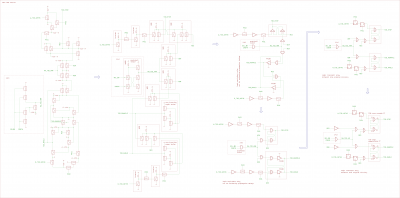

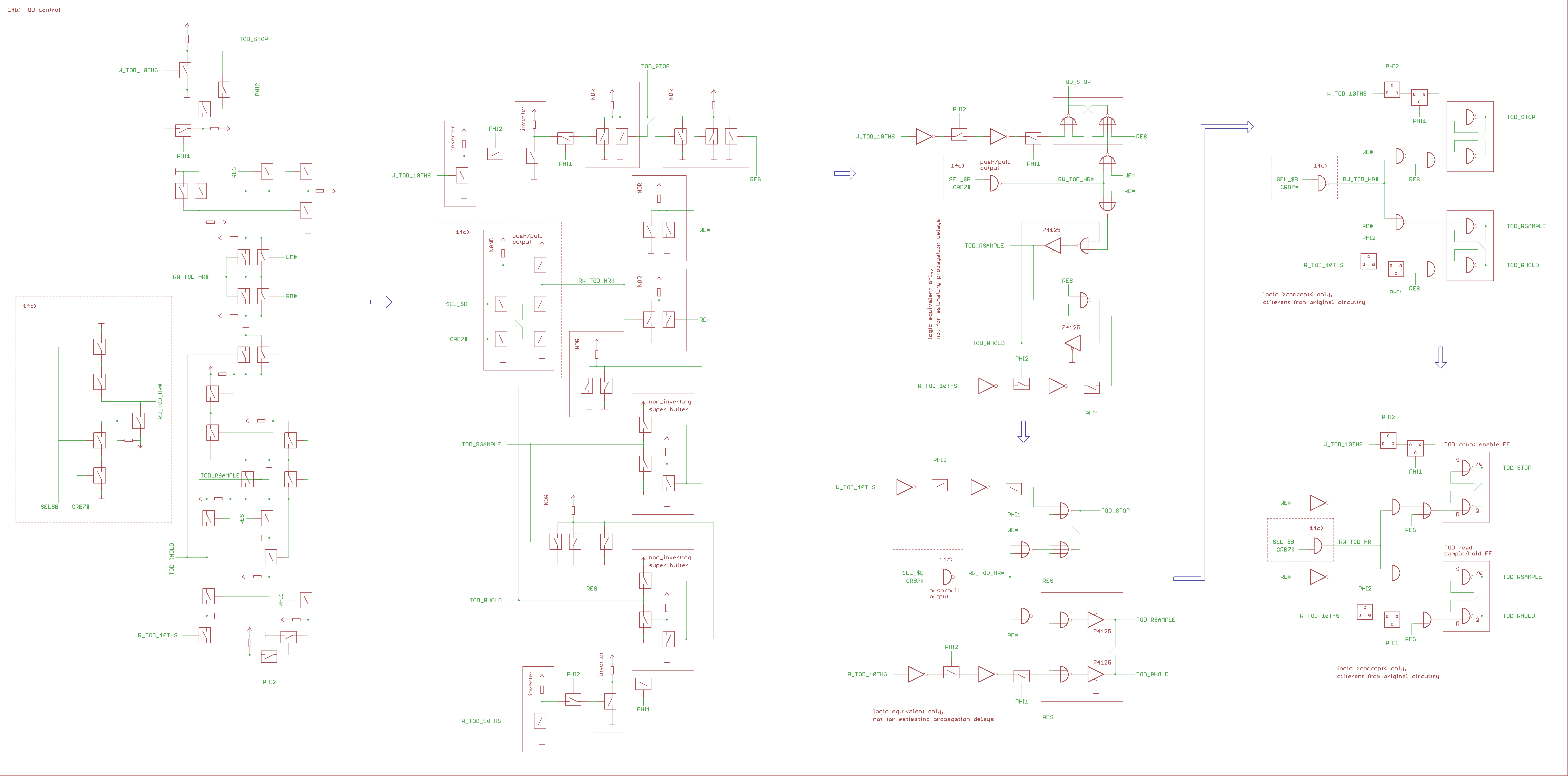

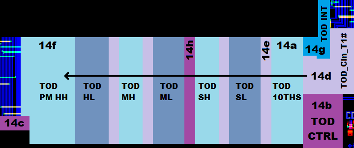

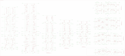

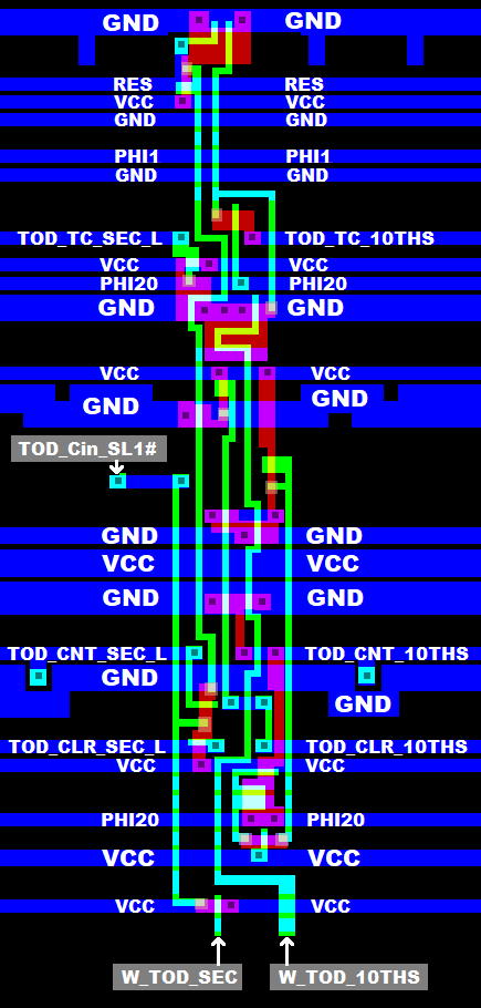

14 deh) TOD counter carry, and TOD counter control
That part looks a bit confusing in the silicon.
I think that the designers intentionally did it this way
because the delay of the carry chain was too much
for running the counters at PHI2 speed...
TOD BCD counter (plus read latches plus ALARM registeres plus comparator)
breaks into six blocks, from East (LSB) to West:
4 Bits 10THS: T1,T2,T4,T8     //10ths seconds
4 Bits SL:    SL1,SL2,SL4,SL8 //seconds low
3 Bits SH:    SH1,SH2,SH4     //seconds high
4 Bits ML:    ML1,ML2,ML4,ML8 //minutes low
3 Bits MH:    MH1,MH2,MH4     //minutes high
4 Bits HL:    HL1,HL2,HL4,HL8 //hours low
//HH and PM are a different story, which is covered later in 14f).
Every block has its own (low_active) carry input,
its high active count clock, and its high active clear.
Basicaly, chip layout for the 8521 TOD BCD counter and the 8520 binary counter
is pretty similar, just the overflow detection is different.

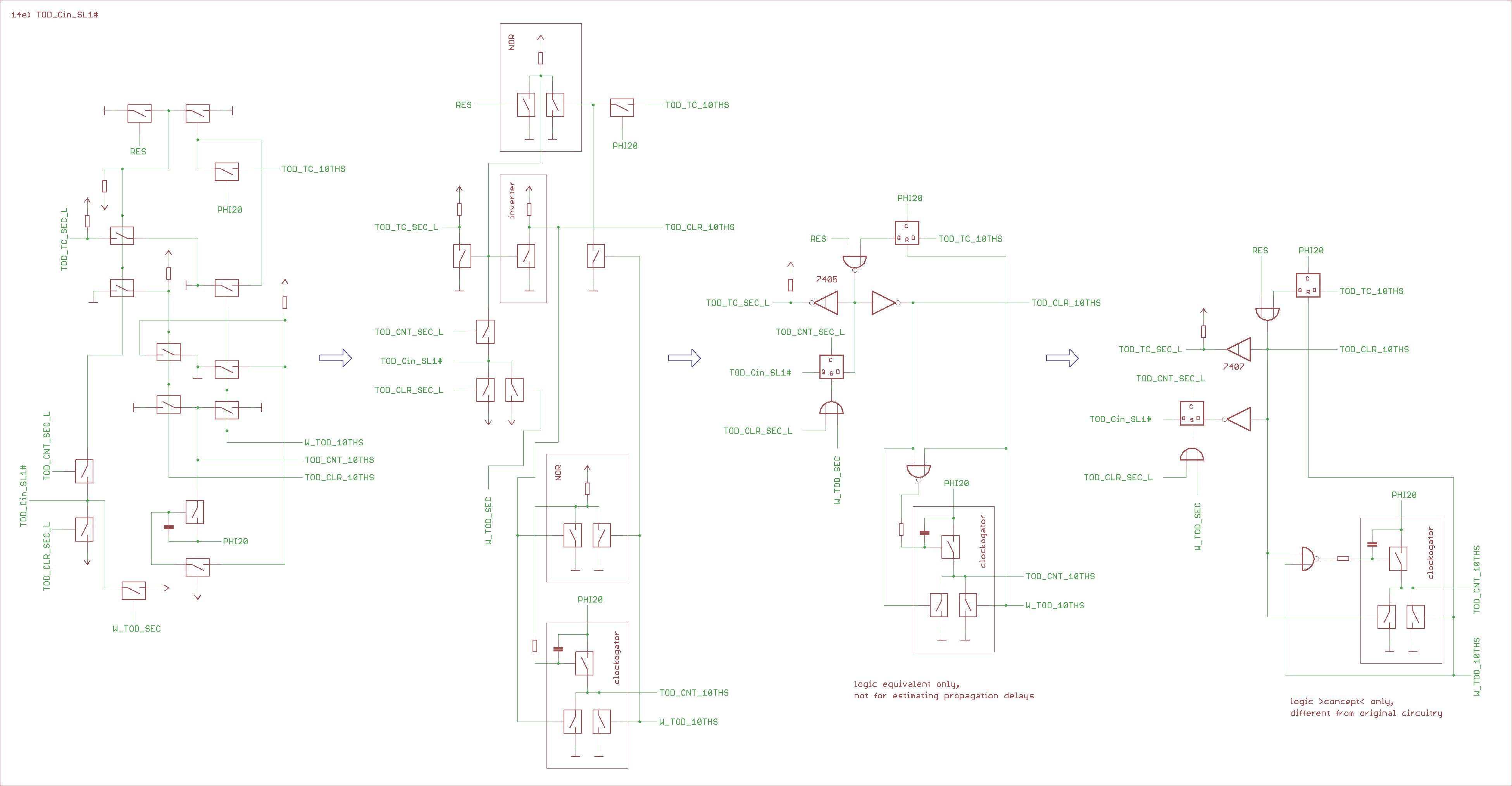

For simplifying things, let's take a look at the control logic for
the TOD SL counter.
We have "sort of" a parallel lookahead carry mechanism:
When the next lower counter (10THS) is cleared with TOD_CLR_10THS, this means:
the counter for 10THS is $9, counting for 10THS is enabled,
and the SL counter is supposed to increment
(when the counter for 10THS rolls over to $0).
TOD_CLR_10THS goes through an inverter, into a transparent latch clocked
with TOD_CNT_SL (same clock as for latches in counter SL),
the output of that transparent latch is the low_active carry input
for SL counter Bit SL1.
For inhibiting the carry input, the transparent latch is set when:
SL counter is cleared with TOD_CLR_SL,
or when the CPU writes the SL counter Bits with W_TOD_SEC at PHI2.
//when loading or clearing the counter, do not count.
TOD_CLR_SL becomes active when RES is active,
or when SL is $9 while TOD_CLR_10THS is active,
sampled at PHI20 by a transparent latch which is reset
when W_TOD_SEC is active.
//when loading the counter, don't clear it.
So the carry lookahead mechanism technically could be interpreted
as a chain of AND gates, where the TOD_CLR_* signals ripples through,
and four (or three) counter Bits go into every AND gate.
What complicates things:
When having "lump of logic" in the silicon between the BCD counter blocks,
logic for generating the control signals of one counter block
is in the "lumps of logic" at both sides of said counter Block.
Technically, from the logic design point of view what's between the counter blocks
(except for TOD SH > TOD ML) could be interpreted like this:

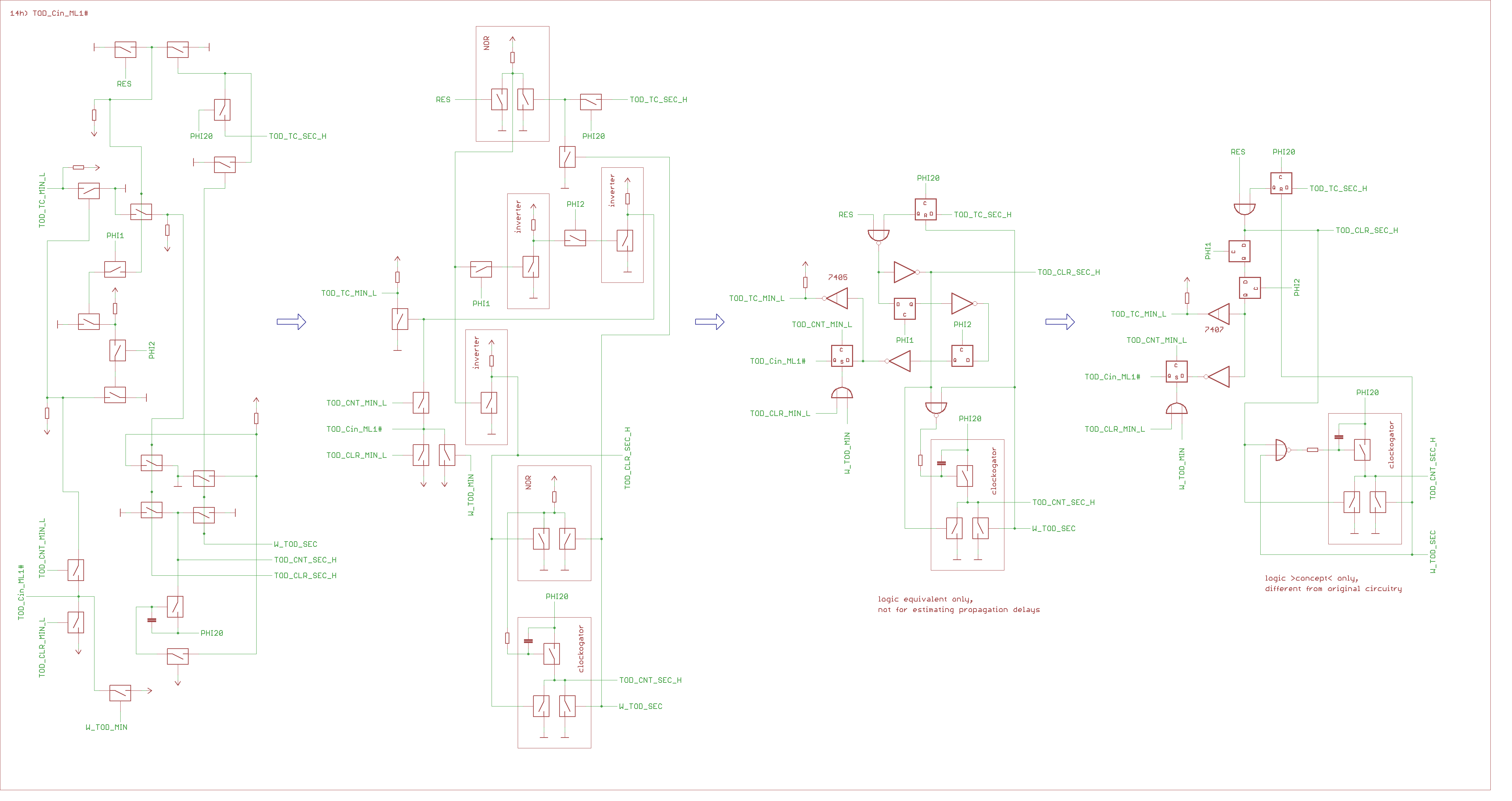

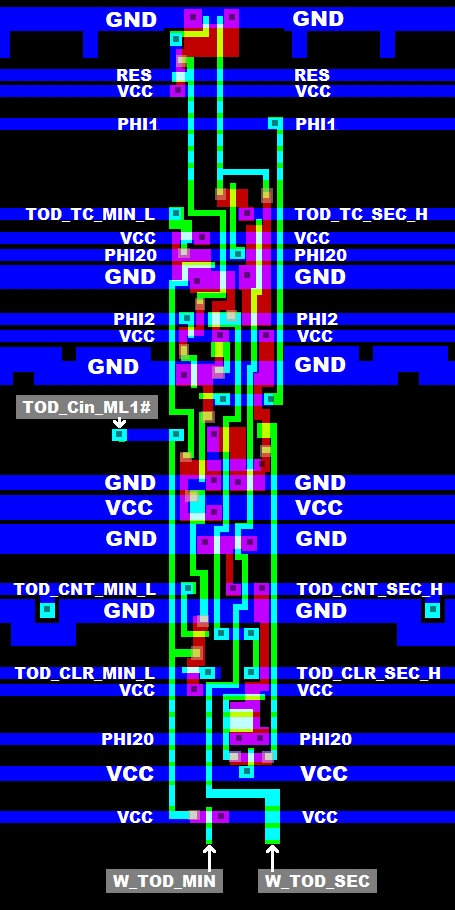

14h) TOD ML counter ML1 input carry generation
The lump of logic between TOD SH and TOD ML is slightly different:
Basically, we have a transparent latch controlled by PHI1,
followed by another transparent latch controlled by PHI2,
inserted into the carry chain between TOD SH and TOD ML.

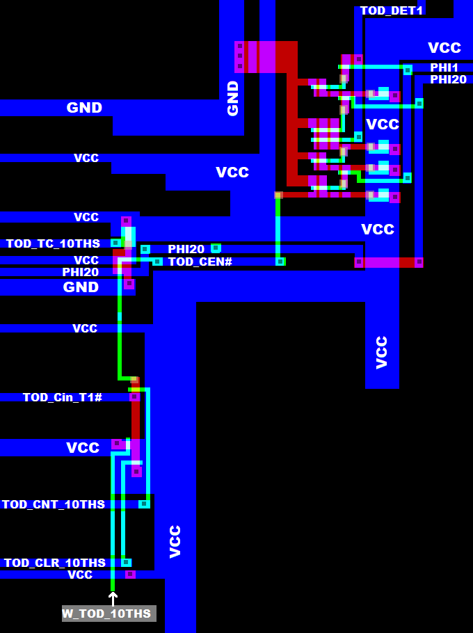

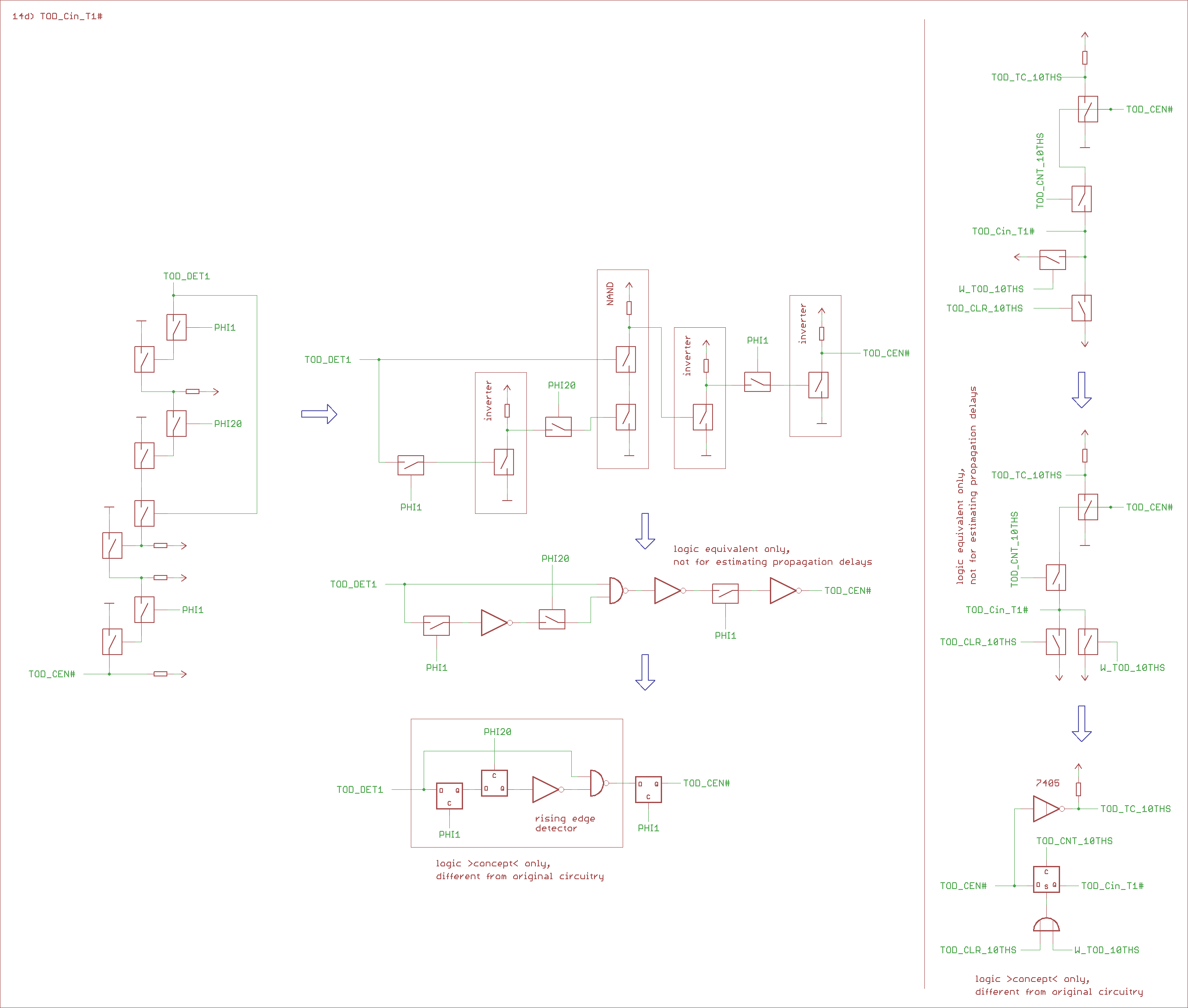

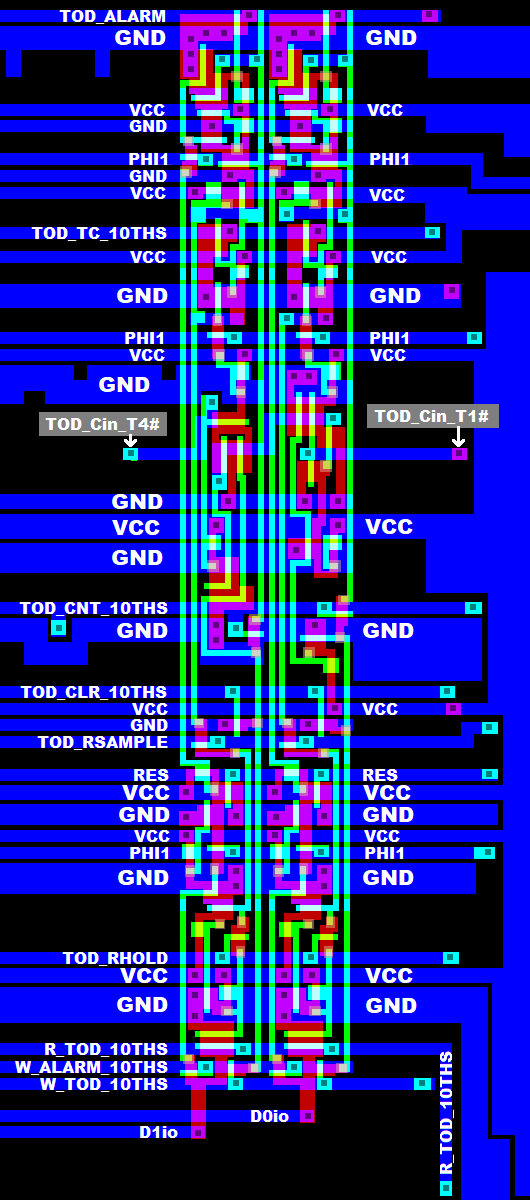

14d) TOD 10THS counter T1 carry input generation
It's a bit smaller, because we don't need to check for an overflow
on the next lower BCD counter Block while counting is enabled...
because there is none.
AC mains frequency (50Hz or 60Hz) goes into the TOD pad.
"15b) TOD predivider" is counting rising edges at the TOD pad.
TOD predivider divides down the 50Hz or 60 Hz to 10Hz pulses
on signal TOD_DET1.
A rising edge detector scans TOD_DET1 for generating the T1 input carry.

and comparators we had in the rest of the BCD counters,
but at logic design level the transistor level schematics are identical.
So far for the simple version.
PM flag:
We have sort of a comparator which checks if HH=1 and if HL=$2.
The rising edge of the comparator output toggles the PM flag.
Again, note that the MH output carry doesn't go into this.
The PM flag toggles when TOD reaches 12:00:00, that yes.
But a side effect is that when writing "HH=1 and HL=$2" to the TOD_HR register,
and the TOD_HR register previously was not "HH=1 and HL=$2", this toggles the PM flag.
In this case, you would have to write with the PM Bit _inverted_ into the TOD_HR register
to compensate for this.
HL1 Bit and HH#:
TOD jumps from 12:59:59 to 01:00:00.
For implementing this, the designers had pulled a trick.
If there was an overflow in the MH counter,
and either HH=0 AND HL=$9, or HH=1 AND HL=$2,
the high_active control signal TOD_CLR_ML
clears the Bits HL8,HL4,HL2 and loads HL1 with HH#.
But wait a minute:
Wouldn't this make TOD jump from 09:59:59 to 11:00:00 and from 12:59:59 to 00:00:00 ?
After checking that water still flows from out of the water tap down into the basin,
and that a screwdriver still falls toward the mass center of planet Earth when getting dropped,
I felt a need to take a closer look at why the designers had used HH# instead of HH.
The trick is hidden within the timing.
The HL+HH overflow is sampled by a transparent latch at PHI20
(which is high at PHI2 in every fourth PHI2 clock cycle)
for generating the TOD_CLR_HL signal which loads HH# into HL1.
TOD_CLR_HL is sampled by another transparent latch at PHI1,
for generating the TOGGLE_HH signal.
A rising edge on TOGGLE_HH signal flips the HH counter Bit.
So TOD_CLR_HL changes half a PHI2 cycle _before_ TOGGLE_HH changes.
This means, that for 0.5 PHI2 cycles, the wrong HH value is written into HL1,
and for 3.5 PHI2 cycles (after HH has toggled) the _correct_ HH value is written into HL1.
But you won't notice from the state of the HL1 Bit (except for a 0.5 PHI2 cycle delay).
//A nice trick for saving some logic gates.
And that's why TOD indeed jumps from 09:59:59 to 10:00:00 and from 12:59:59 to 01:00:00,
I had checked this on a real C64 by resorting to peek() and poke() just to be on the safe side...

14g) TOD INT
High_active signal ALARM_EQ is generated by a 24 input NOR gate,
which is distributed among all of the TOD comparator cells
(comparing the TOD counter Bits with the ALARM register Bits).
The pullup resistor (FET) of this NOR gate is integral part of 14g).
If the values in the TOD counter Bits match the values
in the ALARM register Bits, ALARM_EQ is HIGH.
ALARM_EQ is sampled by a transparent latch at PHI20,
then by another transparent latch at PHI1,
then goes into a rising edge detector.
When a rising edge is detected, high_active signal TOD_INT
goes active for one PHI2 cycle,
what sets the ALARM interrupt flag.
