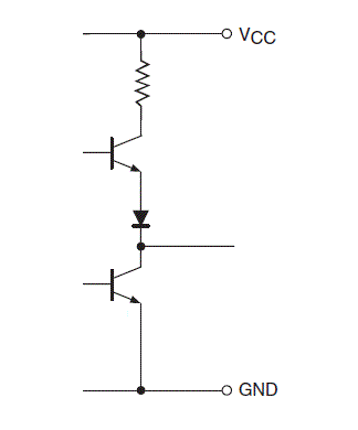

...which will sink your design.
:| But, but, but.... <attaches image> ... the lower transistor is supposed to sink !
That's what causes the output to run aground ! :mrgreen:
Oh dear, oh dear oh dear!! ~sighs~
I knew it! All I needed to do was make one little, inconsequential pun and Jeff would go into full Shakespeare mode, dive right in and spout a whole bunch of them. :lol:
