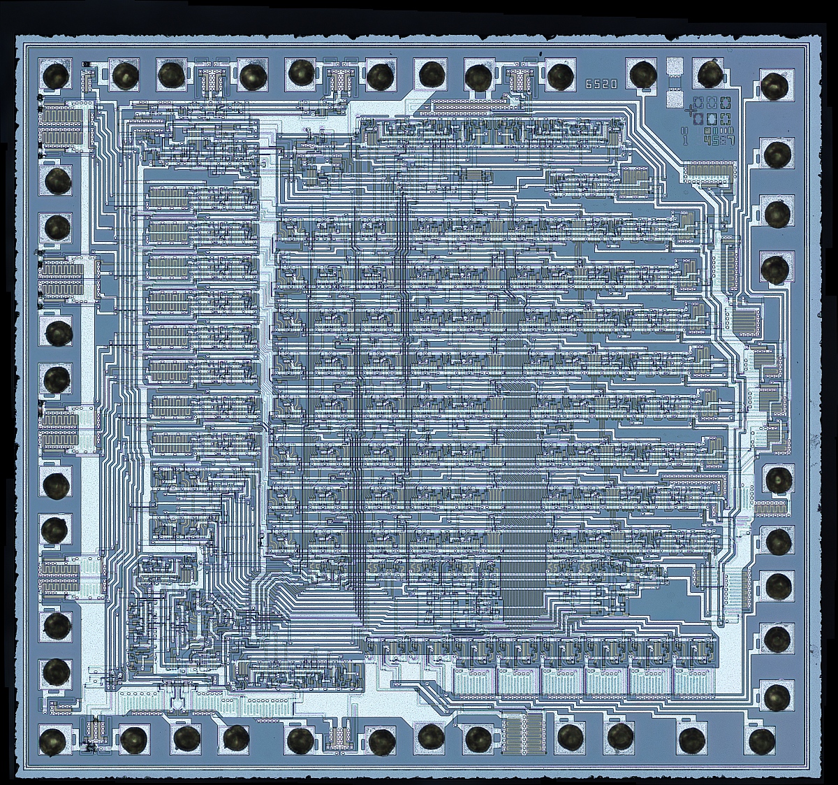

Re: MOS 6522 dissection //NMOS
ttlworks wrote:
And that's all for now.
6526 is supposed to be next, and 6520 decapping is in progress.
And I have to save some money for the lab costs.

MOS6520 on the way...
Is that 8 registers I see there? I thought the 6520 only had 6? (But I really know nothing about this IC or how to decode the picture).
