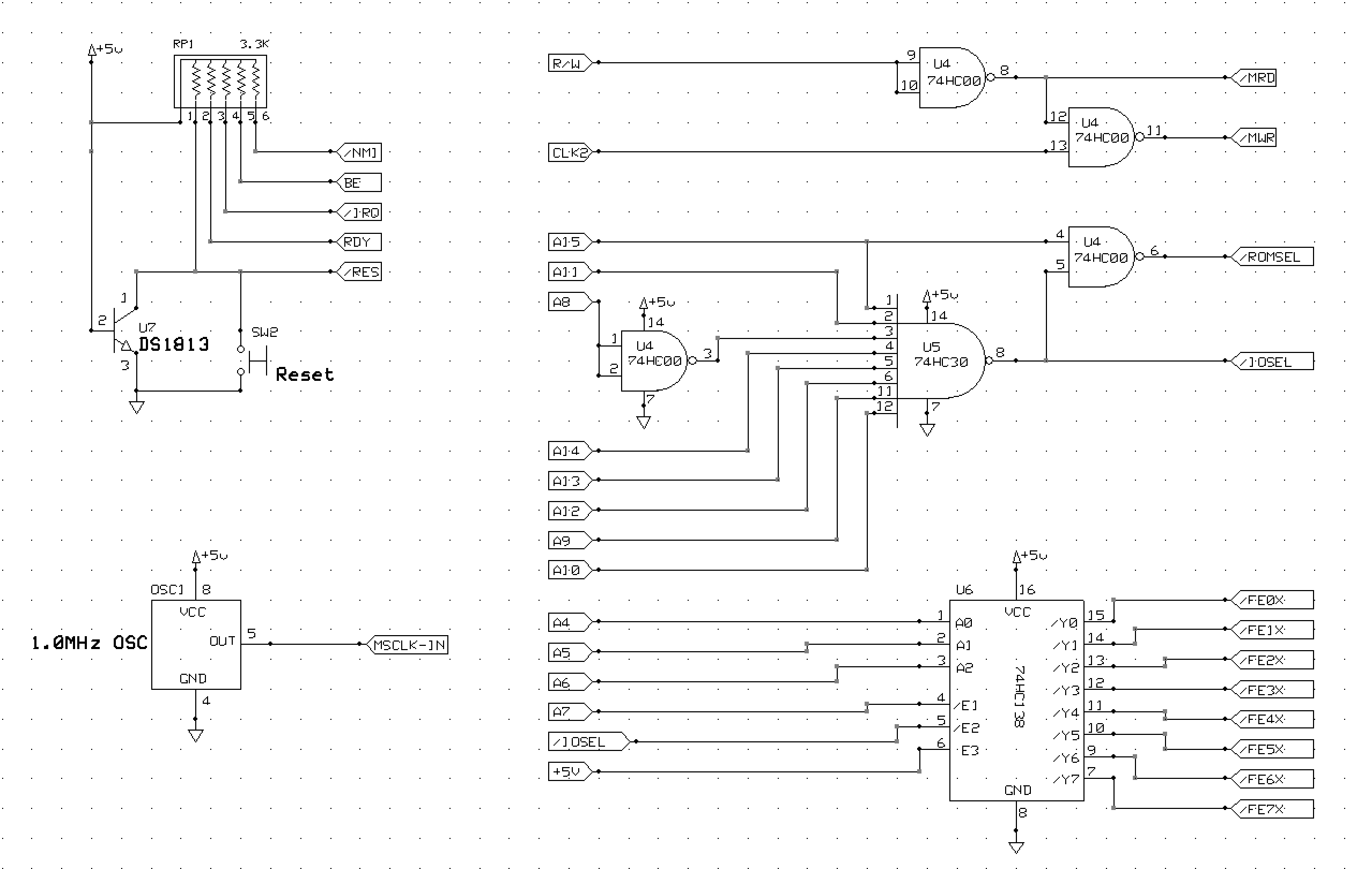

Examining the latest (again), you still didn't correct the UART decoding... it starts at $D090, not $D010.
One thing that stands out is your desire to use as many '138 decode chips as possible (9 in total). What baffles me is why... perhaps you have an unlimited stock of them.
As a suggestion, if you can program an ATF22V10C (or equivalent) PLD chip, you can replace all of the '138 chips, the '08 and the recently added '02 chip with a single ATF22V10C. This saves 10 chips and the board space they take. It would also give you a flexible memory map should you want to change anything at a future date, without having to change your hardware design and/or PCB.
Second suggestion, you can replace the 555 timer (plus associated parts) and the '04 inverter with a 3-pin DS1813. That would leave one last '04 inverter in use in the IRQ circuitry. You can replace that with a single mosfet and delete the 74HCT04 as well.

I wanted this to be simple to understand and learn as well as simple to build and I'm trying to find the balance. The 138s simply allowed for a lower chip count while having a simple logic table. This should be the kind of thing that could be used at work but built in school. I hope that better explains the rationale behind my decisions.
As for the decoding logic, I read that as A7\ A6\ A5\ A4 = O1\ or 0001 as Y where xxxx xxxx YYYY xxxx or something like that. Could you please explain where I made my mistake? I just don't seem to see it...

I was looking at what you had on GitHub 3 days ago, you since changed it. As for simplicity, yes the '138 3-to-8 decoder is a nice device, but you're using 9 of them and making a separate decode chip for each I/O device. This defeats the lower chip count claim. Back in the 80's, I built a CPU card with an expansion connector... it used 3 chips for logic decoding and a qualified memory write line. It had 8 chip selects using a single 74LS138 and they could be 16- or 32-bytes wide. I also defined an I/O page at $FE00. Here's a simple schematic of the 3-chip logic:
Note that the memory map was 32KB of RAM from $0000 - $7FFF with it's chip select line tied to A15. The ROM was also 32KB but the decode logic diverts the $FE00 - $FEFF addresses to the I/O select, which drives the 74LS138. I later went with 32-byte wide I/O selects as there are some newer devices which have more than 16 registers (e.g. the NXP DUARTs). The above schematic clip is a refresh of that same design done with all CMOS chips about 10 years ago. I've actually run this CPU board with an I/O board (65C22 + 65C51) at speeds up to 10MHz.
Hope this helps...
Hope this helps...
UPDATE: Managed to reduce the number of 138s to only 4. 3 for device selection in general and one specifically for the IRQ priority.

In your application, I see no value in hardware IRQ priority. You don't have anywhere near enough I/O to justify it. I suggest you spend your chip budget on useful features, not bells and whistles.
BTW, everything you are trying to do in discrete logic can be accomplished in a single Microchip ATF1504AS CPLD—and with substantially better performance.

Additional comments to the latest motherboard update:
1- You don't need two chip selects going to each I/O device. Just tie the CS1 lines on the 65C22 and 65C51 devices to Vcc and configure the 22V10 for active low outputs, which go to /CS2.
2- Split the lines between CS and OE on the EEPROM memory devices... OE goes to the qualified read from the 22V10 and CS becomes a dedicated chip select from the 22V10.
3- You can remove the last '138 decoder that was configured for memory read and write lines (the 22V10 replaces that too).
4- On EEPROM devices, put in a jumper for the WE pin, either to Vcc which makes it Read Only, or to the qualified write signal from the 22V10. This allows programming insitu by swapping the jumper.
Any additional I/O would be added via adapter cards and would have to have it's own decode logic. You do need to ensure your glue logic provides empty address space for any adapter requirements, if and when you add them.

1- Suggest you look at the 65SIB W65C22... still showing incorrect CS0 and /CS1.
2- I still recommend you split the OE and CS lines on the EEPROM devices and use the qualified read line from the 22V10. connected to OE.
3- On the PCB, suggest you use high quality sockets for the EEPROM devices, not ZIF sockets. You can always insert a ZIF socket into the standard socket when you need it.
4- Finally, again... use a jumper for the EEPROM write signal, either to Vcc or to the qualified write signal from the 22v10. You'll have a a more flexible and usable setup.
5- Would add a 3,3K from Reset to Vcc. Yes, the DS-1813 has an internal pull-up, but I think it's around 5K or higher. A little extra helps. I use a resistor network for the pull-ups and use one to drive a power on LED (1ma LED).
Last... are you really sure on using the W65C51? You have to code around the problem, so why not use a more modern and better UART/DUART. As you're also using a RS-232 level converter to interface to a DB-9 serial port, exactly what are you planning to use that port for? Driving some older device or perhaps as a serial console? Also, suggest you test your 22V10 configuration before making PCBs... verifying what you expect it to do.
